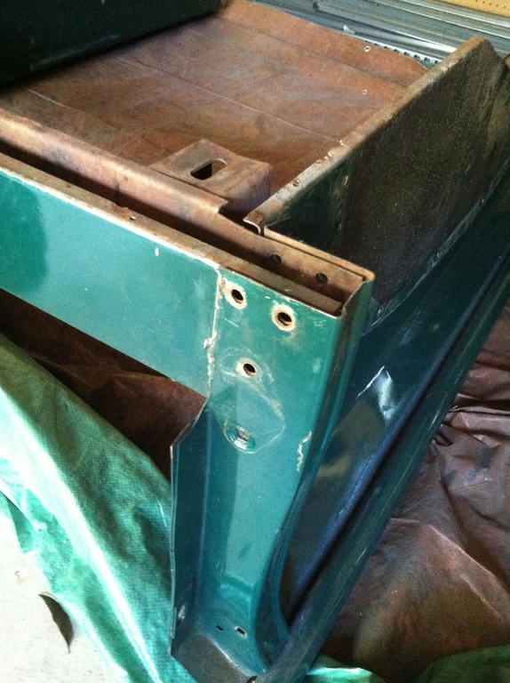

    Second question- I am trying to detach the sides of the bed from the end piece. Are these hacked, sawed, chiseled or what? Are they spot-welded? Any suggestions would be appreciated.

    Shouldn't be an issue painting the hubs. Just tape off the parts that shouldn't have paint on them.
    The rear sill should come out of the stack pockets with a little persuasion. They were not spot welded to the bedsides. They were held in place with bolts and nuts. I assume that you have already removed the bed bolts from the rear sill. A well placed piece of 2x4 and a hammer ought to do the trick. Don't forget that you can always upgrade to a BFH!

    Thanks Ken. I will go bang on them after dinner!

    The rear cross piece is welded , I like to use a bit of old leaf spring ground down to make a sheet metal spot weld chisel , this will separate it with minimal bending .
