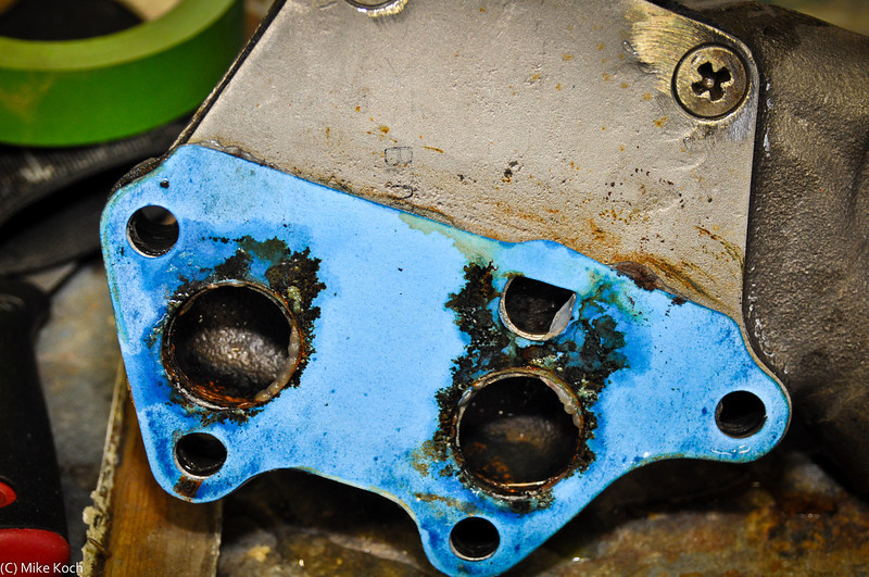

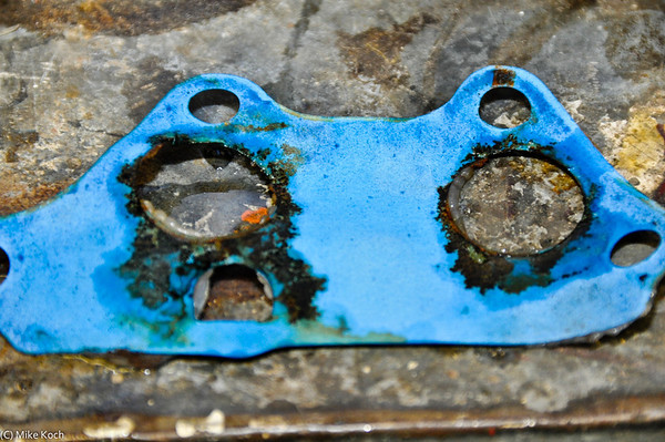

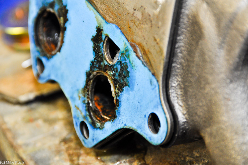

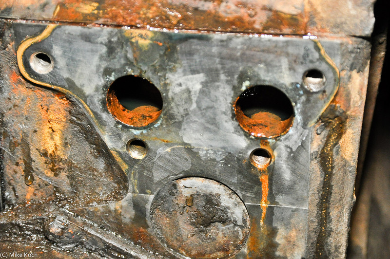

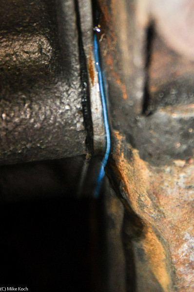

Got it all pulled apart.........
I used some blue RTV to hold the gasket into place......wondering if that was maybe the issue?

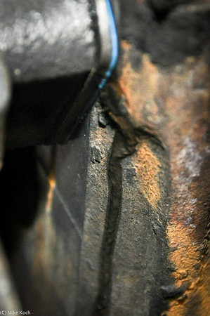

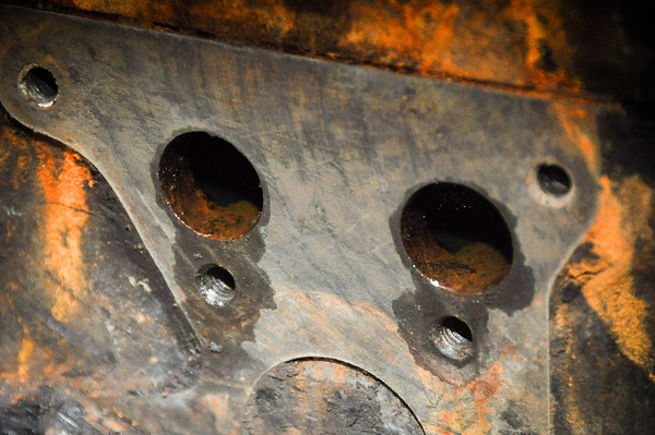

Looking at this 4th picture head on, it looks like that trickle of water is coming from a block crack (not the mating surface) just to the right of the mating surface.
I am not seeing what you are refering to. Which picture?
Make shure the water pump surface is clean also....lots of black junk there. It may have pitting...rn a file over the mating surface. RTV both sides of the gasket, install, let sit and cure before adding water.

See if the front of the block and the pump surface are matching well , check metal surface for cracks aswell , use a fine metal sandingpaper block and take the pits away. Clean both surfaces very well. Get your self a new thicker/better gasket and use some permatex and let the whole lot dry a few hours. Then have the permatex on the other side and place the pump, have a friend to help you keeping the pump in postion while you torque it down.

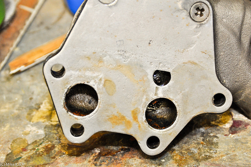

Looks like the pump face is badly pitted to me , this will cause leaks .
DO NOT use a file on either surface ! if you want to clean that old pump , get some flat glass and fine grinding compound , spread it on the glass then rub the sealing surface of the pump on it in a figure 8 motion , stop when there's shiny all across the sealing surface .
I don't much like RTV but it may be necessary in this case .
The block's sealing surface isn't quite " Hospital Clean " yet as I can see rust stains & crud on it , vigerously wire brush it & once it's shiny cast iron then wipe it with a rag soaked in alcohol or starting fluid to ensure it's really clean .
I'd remove the block's water jacket drain plug to get the water out of there before going any further , it's rusty and this always interferes with sealing .
That gasket is toast , scrap it , you can make your own or bu new .
You're almost there ! .
Did a little more investigation tonight......running a straight edge across the pump showed it was dished enough to plainly see daylight between the ruler and pump. :-(
