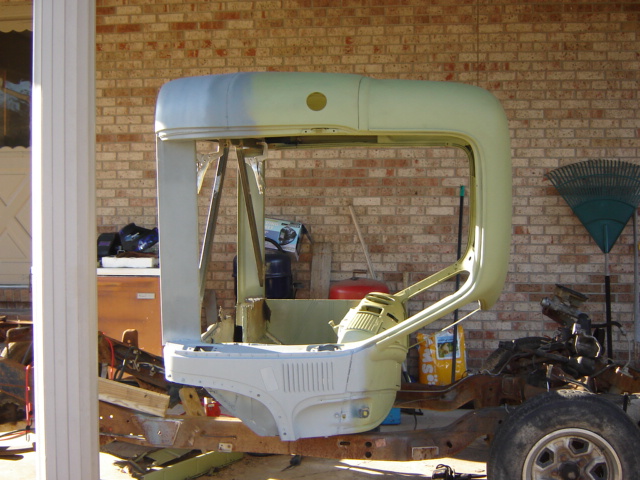

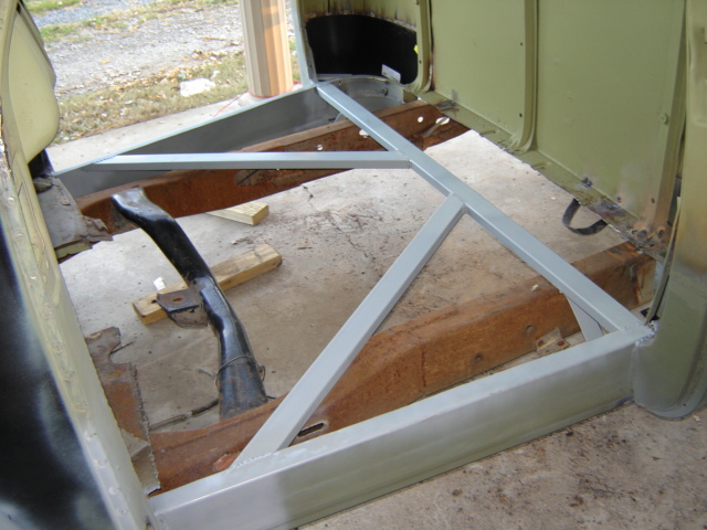

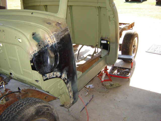

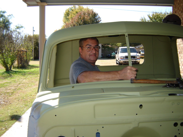

    I thought I'd post a few pics of my weekend with the truck. I had a great time hanging out with dad while working on the truck. When mom took the picture of dad sitting in my truck he told me not to post that pic, so me being me I thought I'd put it on here, he'll really appreciate it. We got a quite a bit accomplished for only having 2 1/2 days to work on it. We cut out and put in new front left kick panal, outer front skin, door jamb openings, left rear lower cab corner, dad made a new rocker panal for the left, and we made and installed the bracing for the floor. Also I don't know what went on the front top left hand side of the cab but there were three pretty decent size holes from the factory. (You can see where I welded them up in the second picture) Maybe it was a mirror, but now they are welded in smooth. I'm getting pretty excited that the cab is starting to look like a truck again. Next we'll be cutting out the firewall and making a smooth recessed fire wall for it as well as installing the floor. I just ran out of time or it would have been done this weekend. I don't know when the next time I'll get to work on it, probably a few months :mad: , but I can't wait until then. Any way if you guys see anything in the pics you think I should do differently, please let me know, I'm always up for new ideas.

    Hey Kevin, looking good man! I'm wondering if someone might have put a spotlight on the driver's side where that hole is. Definitely signs of progress. Did you remember to take pics of your dad's 40?

    I told dad that I needed to take some pics of it, but when I got home it was totally disassembled. He has been working on it again. The way it looks now it would be hard to tell anything about it. When he gets it put back together he is supposed to take some pics for me and send them to me. Sorry. You may be right about the spot light. Was that a factory thing or just something pretty common? I have another 50 cab and it has the same holes in it. Oh well, they're not there anymore:D .
  5. Kens 50 PU
    They were a very popular accessory in the 50's and I've seen them mounted on the windshield pillar, cowl, driver's side and passenger side.

    Spot lights were both factory and dealer installed , usually in one of three locations : lower A-pillar is most common
    Upper A-pillar was for special use where they'd be looking up and to the side , like looking for house numbers etc.
    Occasionally in the roof , dead in the center line but forward of the crown point , this was Military and 'phone company in outlying areas or in line service trucks...

    Hey Nate the holes were in the cowl on the left. I'm assuming it was the spot light. I'm pretty sure mine was just an old farm truck. They look to be factory installed because they were pretty clean holes and also had a bracket installed underneath the dash at the same point probably to brace the spot light.

    I wonder if you maybe just filled in the factory provided mirror mounting holes...? they have a sub bracket underneath to give support and prevent cowl cracks..... OOPS :eek:

    twoooo holes
    that's what I thought,,,, mirror holes,,, but i was afraid to say anything. Not only did mine have holes on the drivers side, but I put two more just like em on the passengers side... oops, hope they weren't for a light, i don't want one of them on the Boops truck, have to have em on the patrol car, don't have a choice.

    Yes , there are holes on both sides of the cowl , look up acessory AD mirrors as they're pretty and well designed , you look in the passenger side one through the windshiled as is correct , no passenger blocking your view as you're wrestling 5 tons of hay down a bumpy dirt road on 1/2 flat Bias-Ply tires ~ no , I've never did that in New Hampshire :rolleyes: well , maybe once or twice .

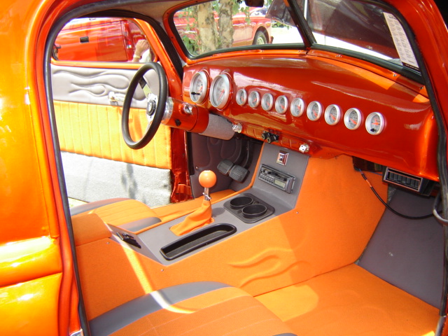

    I have had a few people ask me about interior pics on the black truck I have n my avatar. I don't have pics of it but I do of another truck that was at the show so I thought I'd post them on here. Enjoy the pics of this beautiful truck.

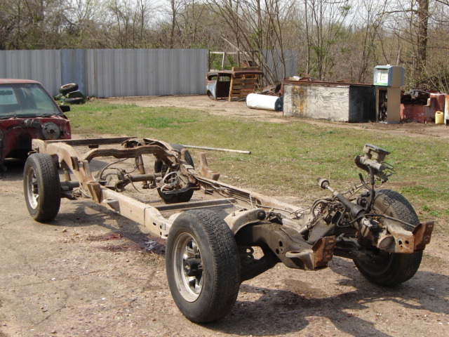

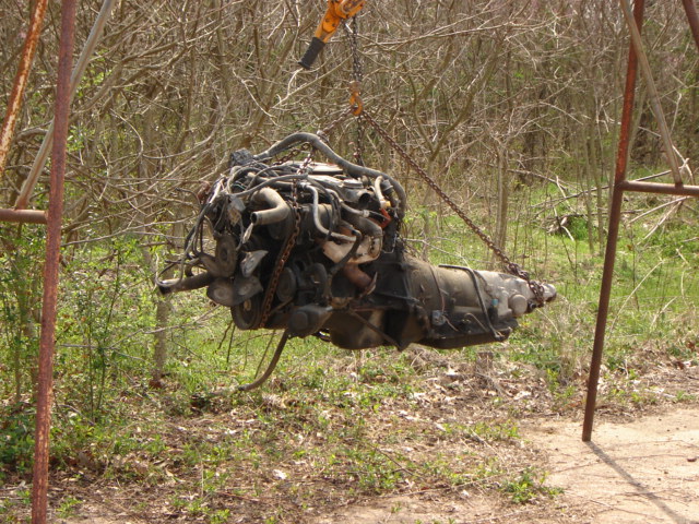

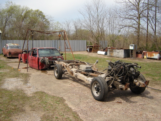

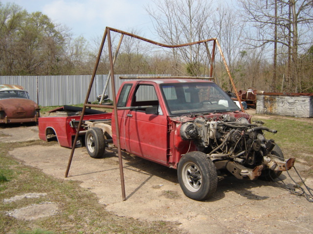

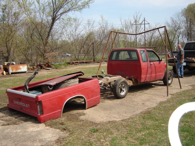

    Okay guys I told you I was going in to work on the truck this weekend. Well I got the dreaded stripping of the S-10 out of the way. This is a truck that my father in law gave me. The wheel base was a lot closer than the other frame I was going to use. Here is the stripping process. It really didn't take that long for Dad and I to strip it to bare frame (about 6 hours) It's now going to the blasters this week and hopefully to my house by the weekend. Notice the swing set (it's a little bowed) This is the same swing set that I've used since a kid to lift off of everything. They just don't make swing sets like they used to ya know.:p

    You could prolly save that A - Frame , er swing set ~ just flip the header bar 180° and weld some angle iron on it full length.... :D
    You're right , to-day's swing set prolly wouldn't support two of the usual 130# 10 years olds that are the norm these days.... :rolleyes:
