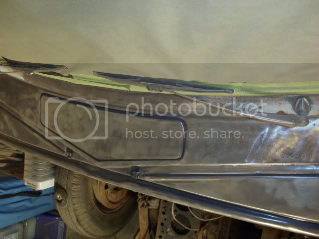

Get your minds out of the gutters I ment this kind also as you can see i still havnt figured out how to get the wipers off anyone have a picture of the back side of the wiper and where this so called latch is.....sorry Im a visual learner

Good job there! Question for you. Now that you've got the metal stripped down and shiney, what are you doing to keep it from flash rusting? Bare metal exposed to the elements is going to rust, especially in high humidity environments. If you haven't done so already, slap some metal prep on the bare metal. I've had good luck with Jasco metal prep. Easy to apply, stops rust in its tracks on bare metal, it can be primed and painted over. Keep up the good work and keep the pictures coming in!

Wiper Arm Removal O.K. , look at your picture , notice that the spring in the arm forces the mounting part to tip a little bit ? . hold it level and give a decent tug , it'll slide right off . There's a fat , splined drum that the wiper arms fit onto , if you cannot pull the arms off , place a large flat bladed screwdriver under the edge and gently pry the outer lip and it _will_ come off , I've never had one stay put yet . Note : if you have decent paint , place a chip of wood on the cowl so the screwdriver doesn't chip it all up . When you go to re-install the wiper arms , first make sure they're in the park position or you'll be sorry......
