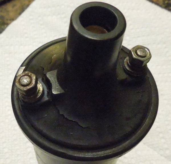

    Ken came by today to help me mount the new fuel pump and plumb the lines for the vacuum pump on this new pump. We did a really pretty job, with only one screw up (bent the tubing the wrong direction) that was very recoverable without another trip to FLAPS.
    Had to remove the coil to run the vacuum lines behind it, and just as I was putting in back on we saw this ....
    Strange thing is, the truck seems to run OK. Besides the + and - markings on the terminals, the only other marking was "made in China" on the bottom. I guess it is time for one of those "Russ recommended" NAPA IC64 coils.
  2. Kens 50 PU
    This just proves that there is at least 1 Chinese repop that is worthy of going on a gmc! I've seen cracks in coils before a lot less worse than this that have rendered a vehicle inoperable, but that 1 takes the cake!:eek: Zig and Wolf, I guess you guys are right about how manly them long motors are!:D

  3. ol' chebby
    3,167
    I have had coils boil over and crack, you pick them up and feel the oil bubbling. That one is toast, I do believe.
