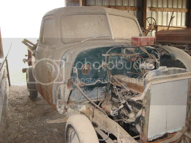

I went pretty low end route. Made it road worthy and safe, skipped the horse power and bling. Had a young guy starting in restoration business take his time last winter working on it. With parts and his labor I have around $6000 This is just how I wanted it to be, fun to drive and my own look. This: To this:
