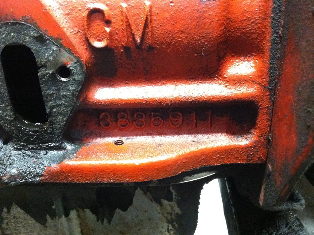

    The casting number number on my engine is 3835911. From one of my books this appears it could be for a 235 corvette or a 235 w/powerglide. I am assuming since my truck is not an automatic that it does not have powerglide?

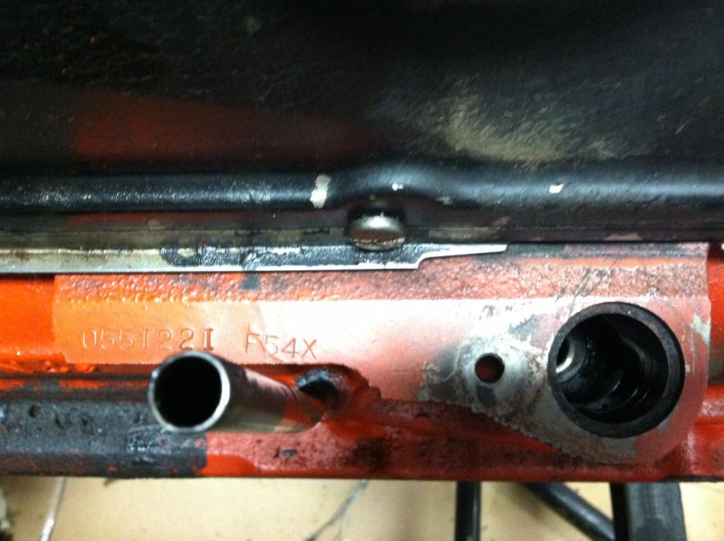

    The serial number is 055I22I F54X. I'm not sure if that helps or gives any additional information.

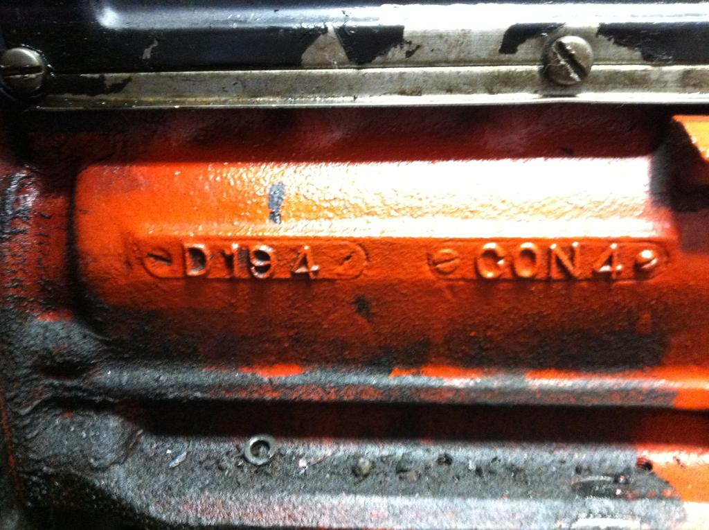

    The only other numbers are D194 CON4. Looking around online it appears the D194 is the production date which would have been April 19, 1954. What would the CON4 mean?

    Check the numbers stamped on the flat pad just behind the hole the distributor fits in. This will give you a positive ID of the engine.
  3. Kens 50 PU
    Steve, the engine serial # 0551221 F54X breaks down as follows: 0551221 is the unit number, "F" indicates that it was built at the Flint, MI plant, "54" indicates the model year, and "X" indicates use in 3100 series trucks.
    The block casting number, 3835911 is consistent with 235 engine blocks in 53-55.
