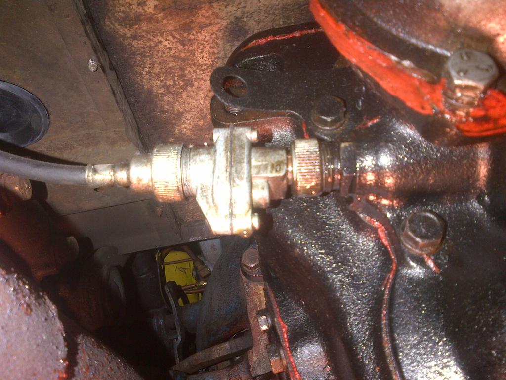

dorcutt Member Joined May 13, 2007 Messages 188 Reaction score 7 Age 74 Location Keep the truck in VT Jun 28, 2015 #1 Still learning to paste photos. Patience please.
Zig Member Joined Oct 14, 2006 Messages 4,860 Reaction score 82 Location Pittsburg KS Jun 28, 2015 #2 You are doing great with the photos! It looks like an adapter to your speedometer cable. I guess a regular one wasn't reading accurately?
Bill Hanlon Member Joined Jun 4, 2002 Messages 2,799 Reaction score 221 Location Morris Ranch TX Jun 28, 2015 #3 I agree with Paul. It'll have a gearset inside to correct speedometer error.
vwnate1 Member Joined Jan 1, 2000 Messages 11,729 Reaction score 225 Location AMERICA ! Jun 29, 2015 #4 Speedo Correctiion Device Once in a while you'll find one of these with a lever on the side , it's for trucks equipped with two speed rear ends .
