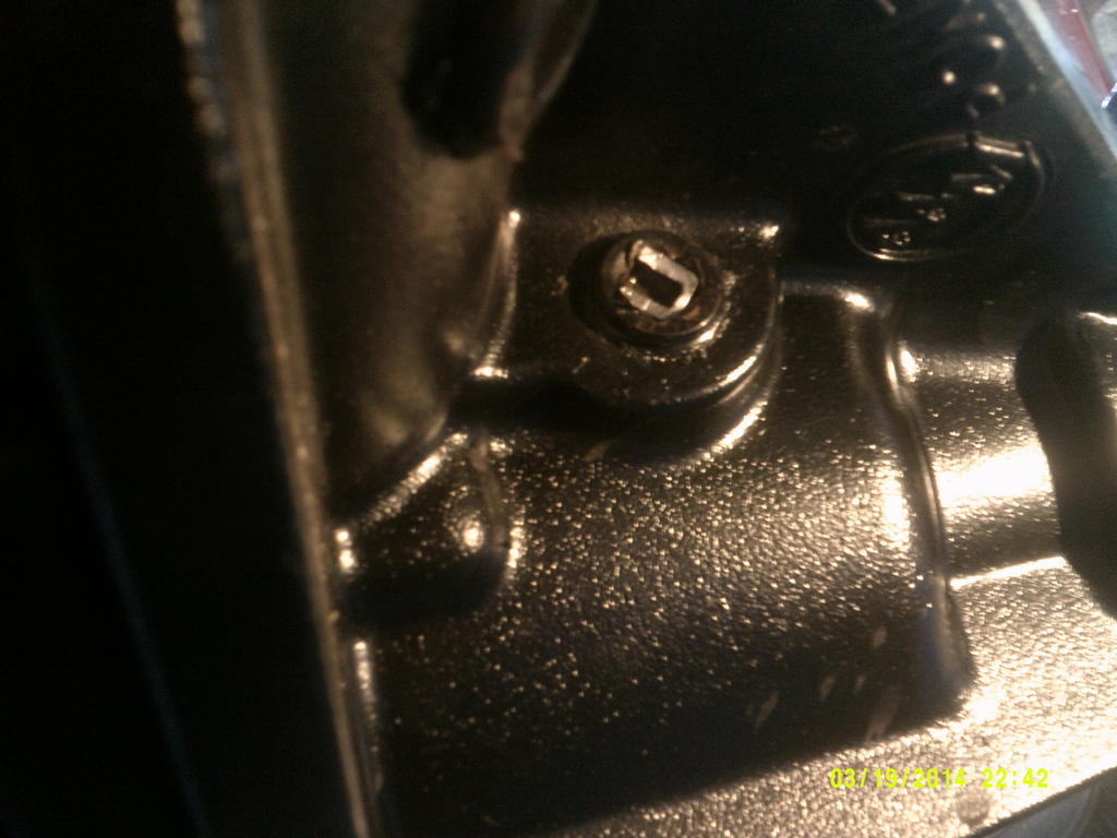

How 'bout some blurry pictures? I am no Coach, when it comes to picture quality~ Hopefully you get the idea, however. So what I wanted to show is the broken off tip to the 3/8 drive still secured inside the fill plug. Another, the nice, smooth, cover plate to the gears. (Could this be home to an improvised fill plug installed out of the way of whirring gears, but at the level it needs to be for the proper amount of fluid? Then there is the vent tube that goes up to... (I still have yet to see what the --- is to go on the other end of this tube, but that's for another day. I could get fluid in through this port and then simply replace the tubing that goes over this nipple and on up to . Finally, I found a new use for a black wire tie. It even has increments marked on the tip that are very similar to a dipstick. It fits perfectly in the tube and is flexible enough to go around the axle. How far in it goes can be eyeballed pretty dang close. This is the picture that has a blurry black wire tie with what looks like shiny, black oil on the tip. ...because it is... So with these options, I kind of like using the fill tube and my wire tie. Of course, the first time I do this, I will keep strict count on the amount I am putting in, so next time, I won't need to worry about checking the level, just put in the amount I need. What say you? Thanks! *Note to self~ When saying you are going to show blurry pictures, make sure you attach them.

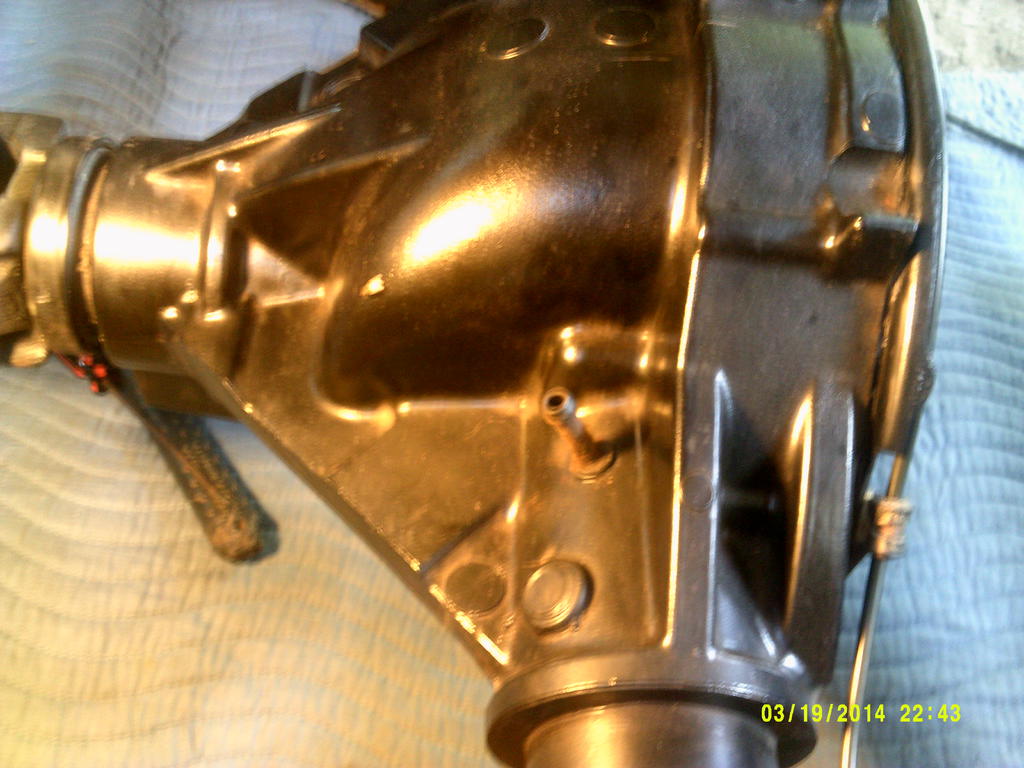

Banjo Cover Paul ; This seems simple to me so triple check before you do anything ! . See the stamped in GM P/N on the cover ? I'd add a plug right in the middle of it . exactly in line with the centerline of the axle shafts . It appears (here's where it gets tricky) to be a standard 10 bolt stamped tin GM cover , go to some Auto Jumbles or (better IMO) Junk Yards and crawl underneath EVERYTHING that was made by GM until you find a 10 bolt cover with a filler plug in it , buy , clean and repaint to match/suit , you're golden . I'm still puzzling over picture # 1 ~ how in the blue blazes did that happen ?! .
