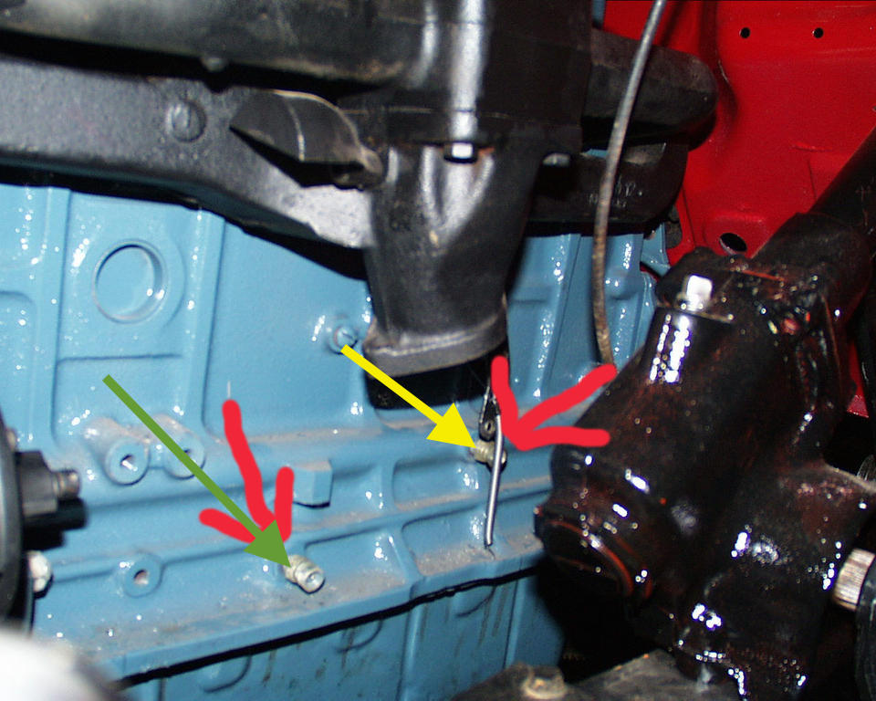

    Realize this is an old thread .... oil line
    To confirm-
    -the yellow line points to where one connections the oil pressure gauge?
    -the green one is where one would connect to the drain of the external oil filter?
    If anyone has the specs on the fitting that goes into the engine block, that would be really appreciated.
    Thanks,
    Haasman

  17. Haasman
    Haasman Member
    May 10, 2010
    345
    N. CA, south of SF
    Yep got the tubing. Wanting to know the connection point on the engine and if someone can provide the fitting size.
    Haasman
