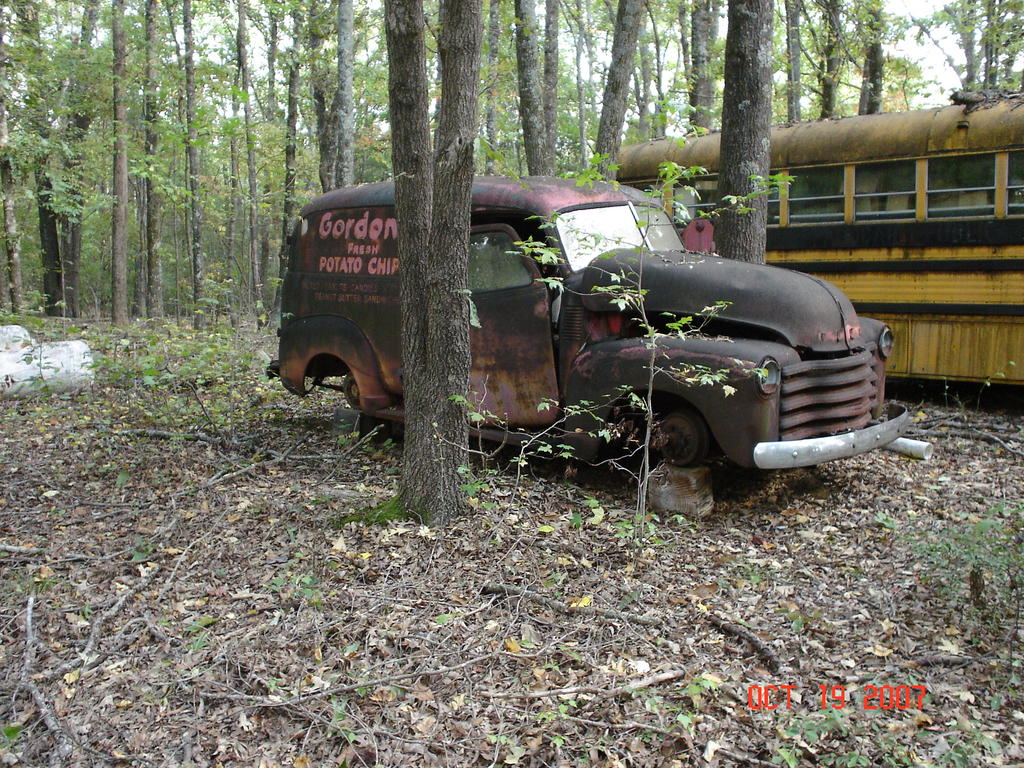

    Bill, I have a '49 panel beyond repair!
    It's all original, but pretty much eaten up. I will have access to the "carcus" next week, so if you need pictures, measurements, descriptions, etc, let me know and I'll look at it and provide you as much info as I can. It's been sitting in the woods behind my mother's house for 25 plus years, and as such, probably doesn't have many, if any, salvageable parts. For that matter, I'm almost afraid to put a bug bomb in it for fear that it will fall apart.:eek:
    Anyway, let me know if you need some info that I might be able to help with.

  13. vwnate1
    Now That's What I Call " YardArt "
    :D
    ' Gordons Potato Chips ' ~ I love it :p

  15. Larrys 48
    Larrys 48 Member
    Dec 7, 2007
    617
    Spokane, WA
    Very Sweet
    Ken - Did you restore it? Future project? It looks incredibly intact. Larry
  16. Kens 50 PU
    The '46 retired and moved to Florida several years ago. A guy saw it in the yard and threw some seriously stupid money at Dad. I understand that he makes the circuit in Fla and gives out Gordon's potato chips at each show.
