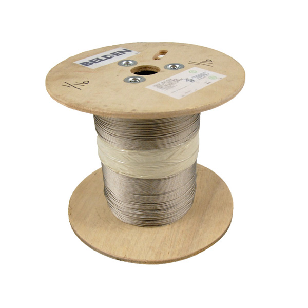

    I found a near match on an old cable spool.
    Most electric contractors & cable companies throw the spools out when they are done with them.

    Washers and such!
    thanks good Idea. I'll keep a look out for some.:)
