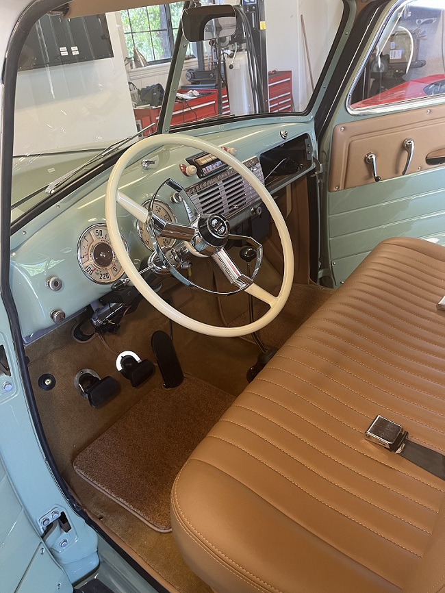

You can seal your pedals with gators- it helps a little. Here's mine
Don't forget to put some dumdum around the steering shaft, and make sure your cowl vent and side vent are sealing
