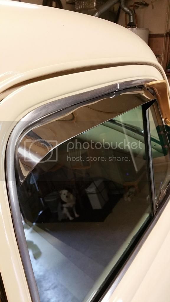

    and here's the vent shades installed

    There are two types of door window shades : the old , original style had two self tapping screws so you had to drill holes in your door and trim to use them , those worked great and are my favorite .
    The new style , has really thin clips that so far , seem to work just fine in my trucks .

    I got the ones with the screws from our host...Hmmm now to muster up some nerve and drill into the door.
    Roger
  8. vwnate1
    11,661
    Vent Shade Installation
    Roger ;
    It's fairly simple : you need three hands to hold the vent shade tightly up as far in as it'll go , making sure both ends as well as the center are firmly in place , then use your fourth hand to drill a much smaller hole than you think you'll need , right on through the unobtanium stainless steel trims you spent 5 years looking for , restoring and polishing , ignore the scratches the chuck gouges in the perfect flat black paint inside the shades...... :rolleyes: .
    The screws you use , are critical ~ they're (IIRC) flat ' button head ' typ and I always drill the center hole , install a screw , hold the shade tighter up and drill the next hole , insert the next screw , repeat until you're done then count the dayze until it rains or snows and you can tootle along with the windows cracked 1/8" ~ 1/4" and get good heating / defrosting / ventilating
    Those correct screws are available , DO NOT use regular counter sunk trim screws here ! .
