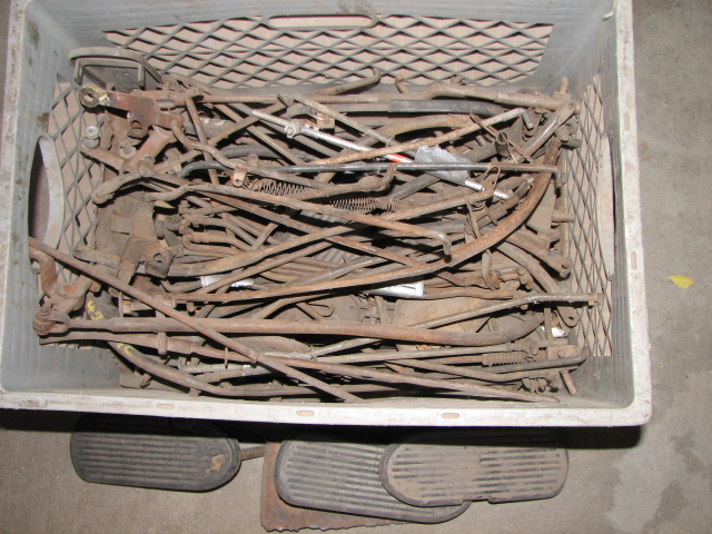

    We agree.... there were many used....
    We have a crate full of them but have no idea which ones you need.

  11. vwnate1
    ! Wow !
    See what I mean ? MotherTrucker has scads of good bits .
    I'd say just send him (CChar) one of the stamped steel bellcranks with the pivot pin , one with good holes that doesn't wobble and the pin with no grooves .
    From there the vertical rod is fairly simple to cobble up , the horizontal foot feed rod , OTOH , can be a real PIA , I used to always grab a box full like this and test fit as the pedal end curved up part seems to vary so you'll need a truck one with the proper hole to attach the the accelerator pedal and not be all worn out at the 90° bend part , PLUS (maybe most important) that up curve matches your toe board so it won't drag and cause sticky throttle , always a bad thing .

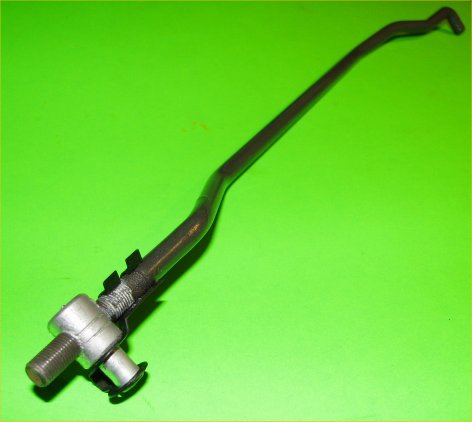

    I am a big fan of the threaded adjustable rod that connects the bellcrank to the carb....
    These puppies have 2" of adjustment & I have never run across a 216,235 or 261 motor that you couldn't get these to work on :D
