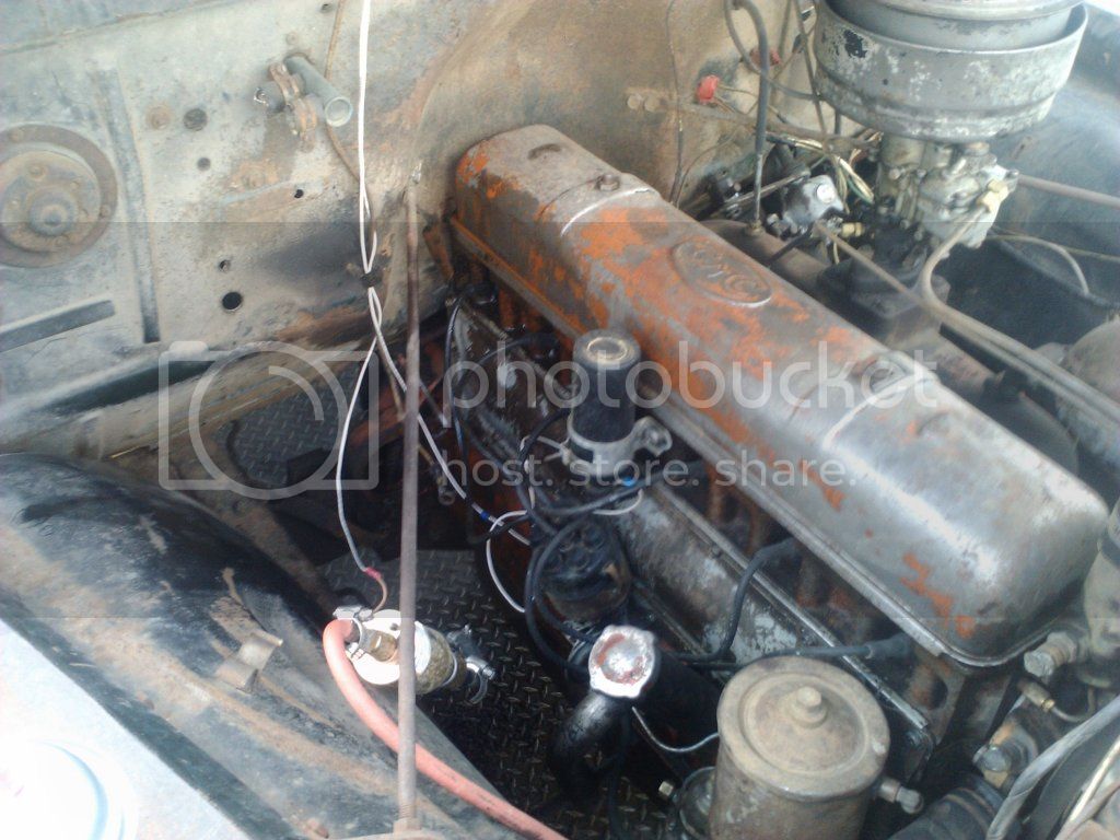

    The first question is: what engine is in the truck? I told him it was probably a 228, but that I wasn't certain. Here is a shot of the engine:

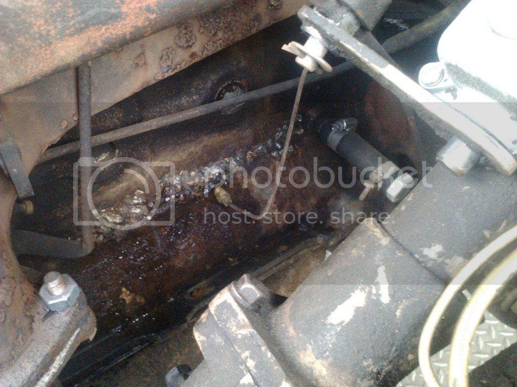

    A shot at the opposite side of the engine revealed some repair work to a cracked block:

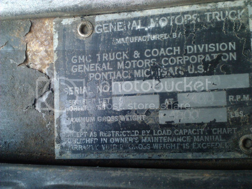

    Were Chevy and GMC trucks pretty equal in the minor styling changes throughout the production run? For example, Chevy started the vent windows in the doors in '51, the push-button door handles in '52... etc. My buddy's truck has both, the vent windows and push-button door handles. I just didn't know if GMC and Chevy mirrored their modifications as the production runs went along. Is there a way to decode the VIN? I know that sometimes the title went by the engine number. I just thought there might be a way to tell the truck's age by the number stamped into the tag in the door frame. Here's a shot of the tag:
    It appears the number is: 102 22 P 56868

    The serial number decodes as follows: "10" is a 1/2 ton truck, "2" designates long wheelbase, "22" designates a 228 cu. in. engine, "P" stands for the Pontiac, Michigan plant and "56868" is the sequence number.
    Isn't it strange that we've seen engine block damage in the same location on both this truck and Raz's truck in such a short period of time.

    Thanks, Ken!! I knew someone would be able to fill in the blanks. Is there any way to figure out where "56868" fell into the years of production? The other information confirmed the half-ton long bed we already knew, and the 228 engine I was guessing about.
    Yes, it is odd about both engines failing in the same area. I wonder if it was a design issue, or an issue with improper maintenance?

    I just found a chart via a Google search that shows production number "56868" as falling into the 1949 production year... as the title says. So, the question remains: Did GMC offer vent windows and push-button exterior door handles a few years before Chevy?

    The cracked block has me a bit cornserned, however. :eek:

    If your block is not cracked now, Winter protection is all that is needed, or if you must a high horse power GTO engine.

    Seriously , the block isn't cracked , it's rusted through in the water jacket , this happened because of poor maintenance plus a bit of ' core shift ' when the block casting was originally poured .
