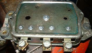

    I started by removing all parts from the frame of the voltage regulator. Then I re-attached all three connection points to the frame using pop rivets.
    The connection points (BAT, FLD and ARM) would be used later for ground points for wire shields.

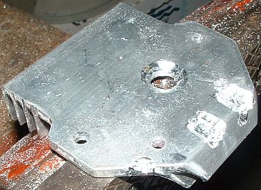

    Then I used a drill and a Dremel tool to hog out some material from the bottom of the heat sink that Deve had supplied so the heat sink would sit flat on the regulator frame without interference from the rivets.

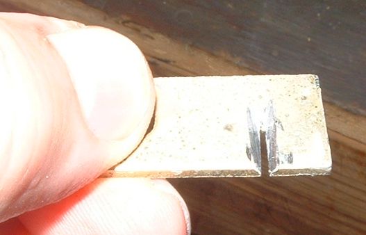

    The next problem was that the module was just a little too big to fit inside the regulator cover. It would fit fine if the wire attachment tabs pointed up instead of out, so the tabs needed bending. I was afraid I might break something if I just tried bending them with no support, so I made this tool.
    It is a piece of 1/8" steel with a slot cut in it using a hack saw. The slot was just wide enough to slide one of the tabs from the HEI module into. I used a Dremel tool to chamfer the slot out so the bend wouldn't be so abrupt. Here is the tool being used.

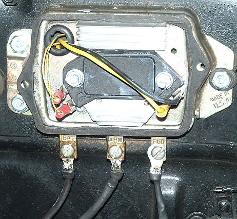

    Here is the module mounted inside the regulator with all wires connected.
    The BAT lug holds a shield with the actual +12 v lead (also connect to coil +) inside the shield and sneaking under the lug, up inside the regulator case to the "B" connection on the HEI module (large yellow wire). The ARM lug holds a shield for the black wire connected between HEI "C" connection and coil -. The FLD lug holds the shield for the twisted pair wires, small yellow to module W and yellow with blue stripe to G that come from the mag pickup in the distributor. All these wires are covered in black heat shrink tubing, making them look more or less like stock wiring and run up underneath the tabs so they are not obvious. Shielding the coil+ and coil- wires may be overkill, but it works for me.

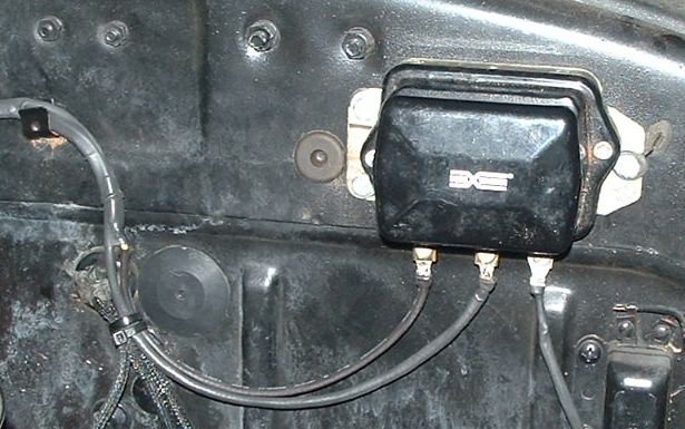

    The end result:
