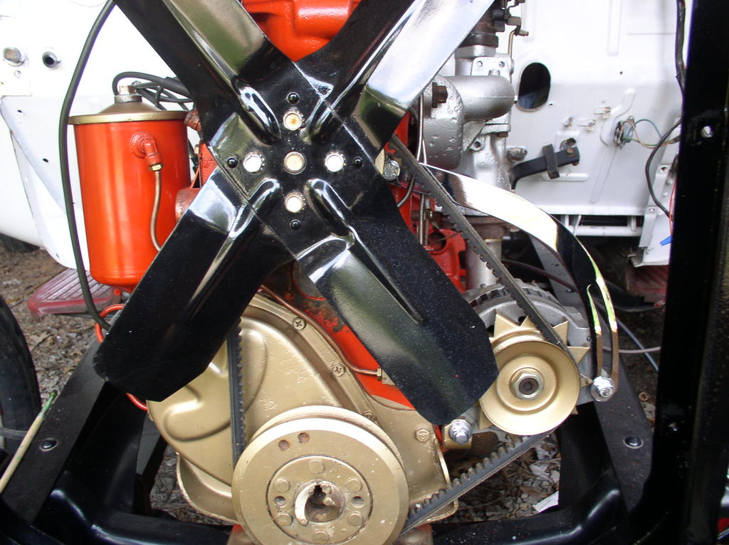

    Here are a few pics of my set up. Cant see to much, but my fenders are staying on! Hope it helps some, I did have a tough time finding a belt that fit, as I don't have much movement for adjustment.

    Looks like you have one of them there modified arms as well. My arm cant be straight, because when the alternator is mounted like it ~should~ be, the adjusting mount is way around towards the frame.
    Thanks for the photos, though! Looks like you'll have to pull that truck apart and paint it though... :rolleyes:

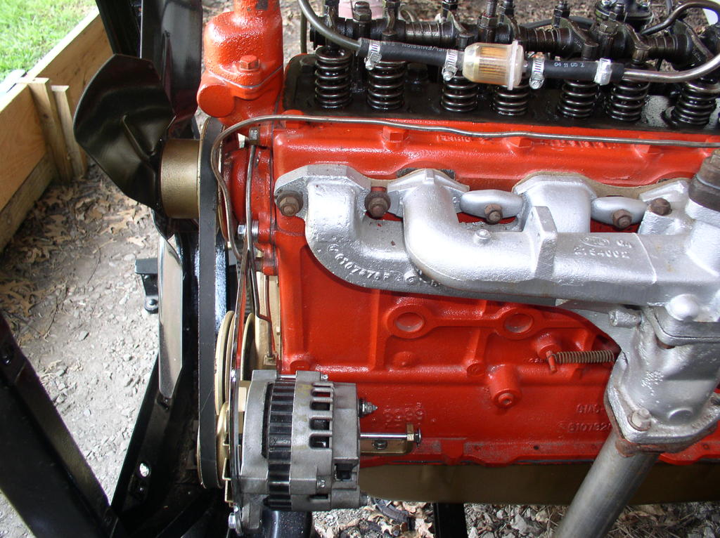

    How's this?
    Thanks to Big Tim's suggestion, I now have a really sexy arm, and an alternator that doesn't have its butt in the air.
    Of course, it just had to be chrome. That clashes with all my gold, I know... :p
    BTW, I didn't see the need in buying 3' of all thread, when all I needed was 8". so I used a carriage bolt and did the jamb nut thing on the back side of the lower bracket mount. It was quite amazing to find that the nuts *just* passed over the head of the bolt that went into the lower bracket that used to hold the generator in place. Fit just like a puzzle.
    Anyway... TaaDaah~
