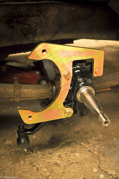

    Not much progress.

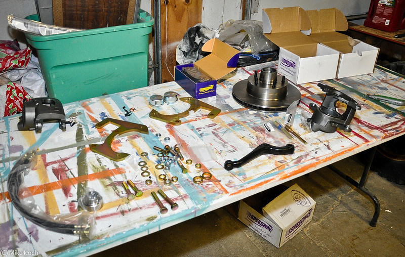

    I got the axle bolted up, along with my disc brake bracket bolted up on the passenger side and that is it.
    Running to the junk yard shortly to ditch my old stuff and hopefully find some temp 15", 5 on 4-3/4" rims to use.

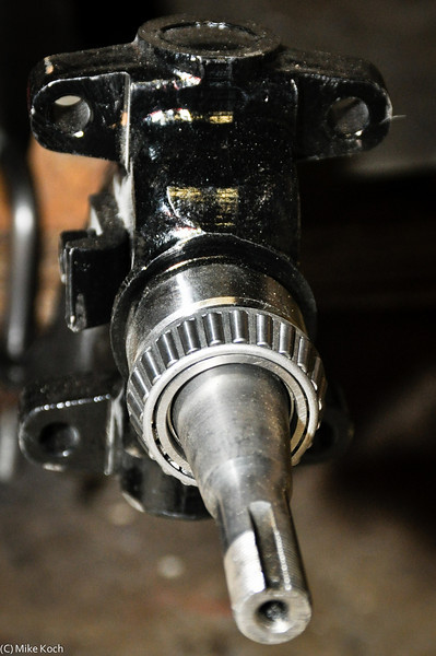

    Little more progress tonight.

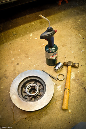

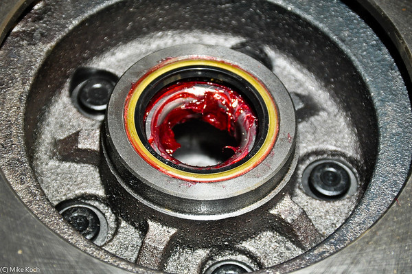

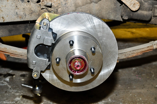

    I had to change out the races in the hubs. They stockers came out easy with a punch and hammer. I hit the hubs with a torch and left the new races in the freezer for a couple hours. Went together perfect!!
    Next came packing bearings and assembly!!
    I could not install the nut and cotter pin. I need to install a couple thick washers so the hole in the spindle aligns with the nut.

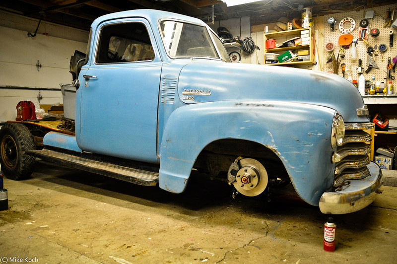

    Money shot......Henry at ride height with 28" wheels!!

    Looks great. The curiosity is killing the cat here, did you have problems with clearance regarding the steering bump stops like I did?

    Yea I just flipped it around to the other side of the axle.

    I'm curious. Are those GMC front fenders? I know the Chevys have turn signals in the grille, and my GMC has them in the front fenders. Oh, and any reason to upload a couple of pictures of "Clarabelle". :)

    Somebody added the blinkers at some point.....they are wired really sloppy with loose multi colored wire.
    Trying top decide if I keep them or plug the holes.

    Down 5-1/2" in front........and axle flip in the back. Hope to have the running boards level with ground.
