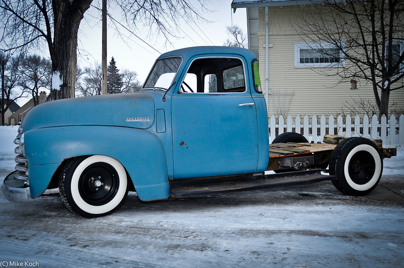

    That is looking might fine, Mike! Lovin' the wide whites!!!

    Really easy with the proper technique.
  3. vwnate1
    11,701
    Tires
    Those really do look very nice but , this old rig is a TRUCK , meaning it's heavy and side loads the tires heavily , I hope the next time you pony up for some LT tires , I keep seeing wrecked old trucks due to this simple error .

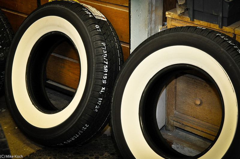

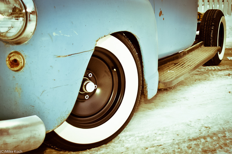

    Hows the quality on the white walls. In your first pic the tire on the right looks like a black line is in the white on the top right. They look great in the wheel well. Was the price better than Diamondback and Coker?
  5. Coach529
    Coach529 Member
    Oct 2, 2012
    585
    Jamestown, ND
    The black line is just a rub mark from shipping. Quality is great, and I am pretty picky.
    To be honest I have read enough bad about Cokers, they were not even considered.
    They were about $35-$45 cheaper per tire compared to Diamondback. Delivery time was much quicker as well.
    Cody at Hurst was awesome to talk to, and came highly recommended from anybody that had dealt with them.
    I will definately use them again in the future.

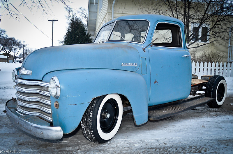

    After some carb cleaner and some fire (on the backside of the tire) the rears seated easily.
    Bolted them on and am ready to rock and roll.
    First impression......wow they look awesome.
    Second impression....damn they look tall. 28" with 40 PSI in them......about 1" taller than advertised.
    Love the look though. Still waiting on my Shannon cones.

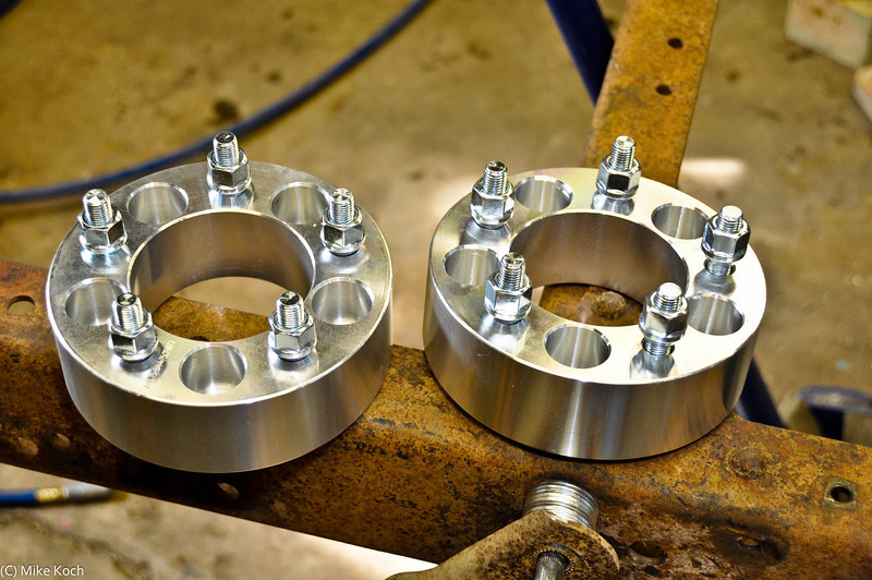

    Measurements show I will need some wheel spacers to clear the box sides. Probably 2" to fill up the wheel well as much as possible.

    Amazing how wide whites can change the looks of a truck and your truck looks sweet what brand and size are they.
    Robert

    I got them from http://www.hurstracingtires.com/
    They are Hancook tires. 215/75-15 fronts and 235/75-15 on the rear

    I'm sure you know to keep those white walls clean with Welsey's Bleech White or plain old Bon-Ami , Comet Powdered Cleanser etc. ~ any rubber treatment will draw the black right through the white walls and make them yellow...
    You're soon to be driving your classic rig in the Summer Sun ! keep up the good works and great photos ! .

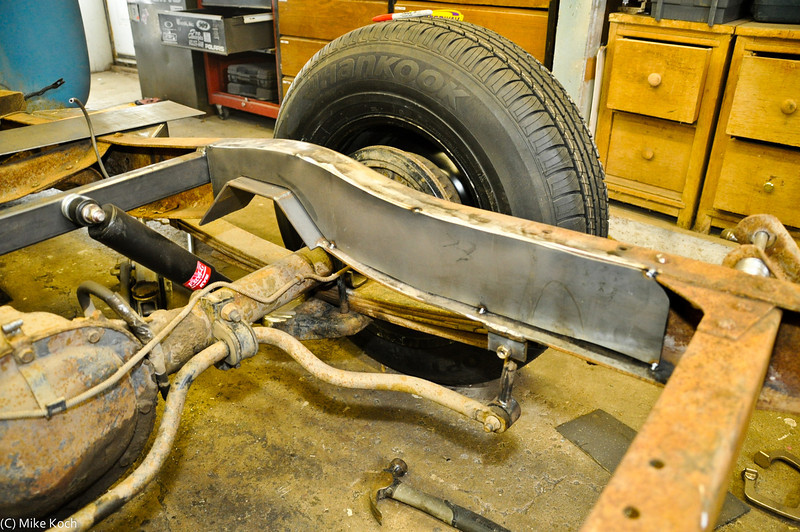

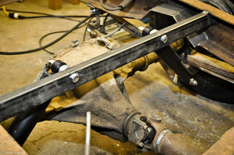

    Got my pinion set and burnt in the spring seats.
    After that I bolted the Blazer sway bar on the rear end and shortened up the vertical mounts to use it on Henry. Fits perfect!!
    I then spent about an hour boxing the spring mounts I made.

    My wheel spacers showed up.

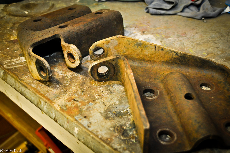

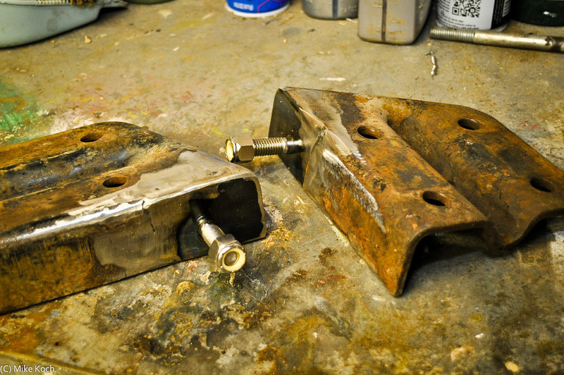

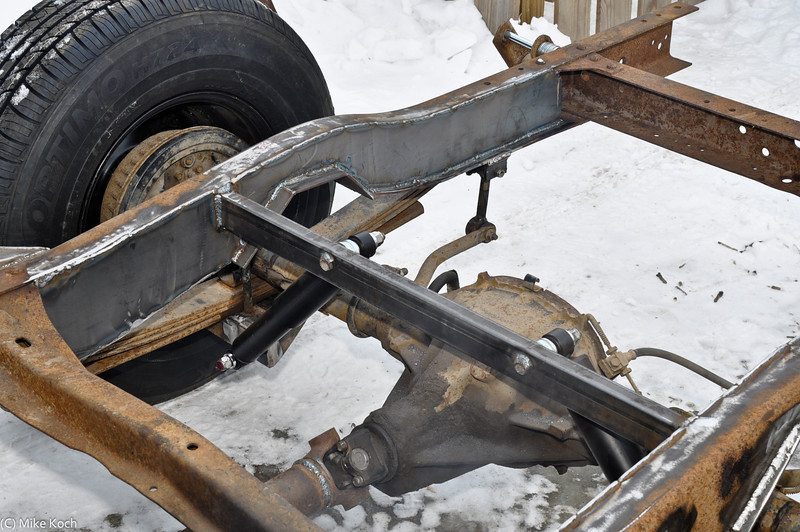

    Spent a little quality time with Henry last night.

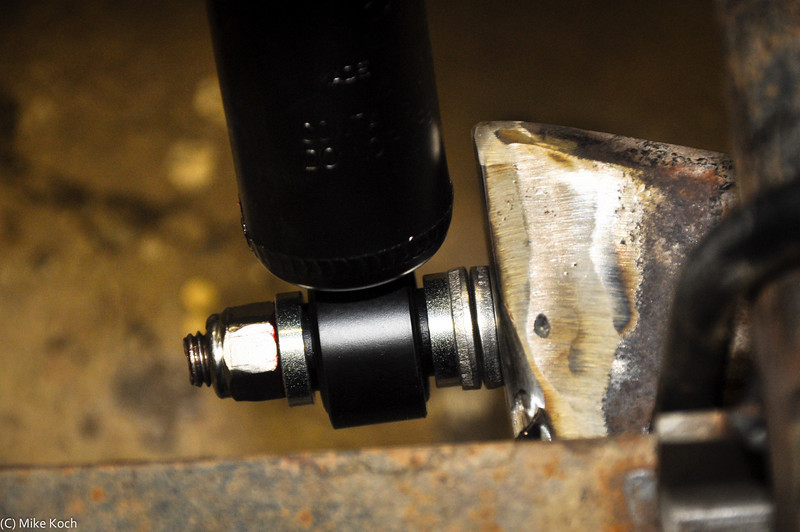

    I modified the Blazer lower shock mounts to accept the shocks I wanted to run.
    Before:
    After:
    Everything bolted up the way I had hoped, but I am running into a bit of a snag.
    The shocks I have are for a mid 60's C-10. Collapsed length is 12.56" I am going to have to lean these babies over about 40 degree's to get that length to work.
    So do I lean them over....or try to find a shock with the same mounts that is a 2-3 inches shorter?

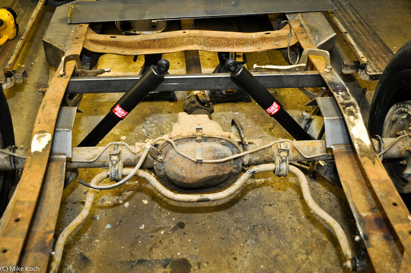

  17. ol' chebby
    3,167
    You can also mount that shock bar above the frame, there is some space between the bottom of the bed and the frame. I have seen factory shocks mounted at quite an angle, they should work, maybe not quite as effectively, but functional none the less.
    You my also consider lowering the lower shock mount at the spring plate.......
  18. Coach529
    Coach529 Member
    Oct 2, 2012
    585
    Jamestown, ND
    I was going to try and figure out my bed height above the frame and use that as an option.
    Lowering the lower spring mount may work......but I will only gain an inch. Maybe worth it though.
    Currently I am leaning towards bolting them up as is and seeing how it works
  19. Coach529
    Coach529 Member
    Oct 2, 2012
    585
    Jamestown, ND

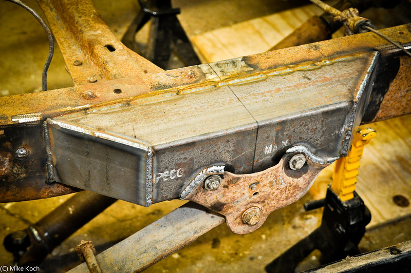

    I did not knock anything off my honey do list......but I made good progress with Henry!!

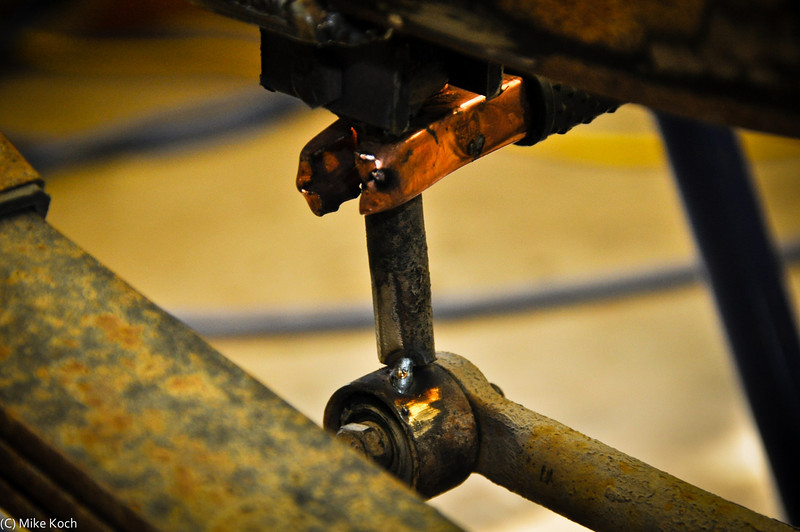

    First line of business....cross member and shock mounts. I threw caution to the wind and leaned the shocks I had over.

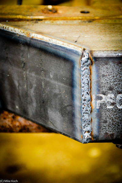

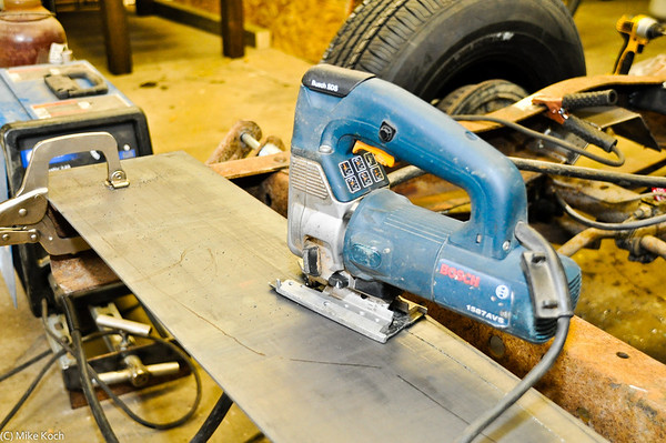

    I never did get a chance to cut my frame boxing plates at work wiht the plasma cutter, so plan B was in order. Jig saw and 24T blades. Easy peazy!! I blade per side is all it took. Not ideal, but it worked!!

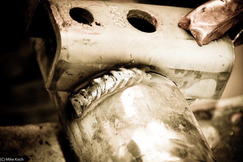

    Tacked in and read to start welding.
    Not proud of the some of the welds.....but they are strong. Hopefully they will never see the light of day again!!

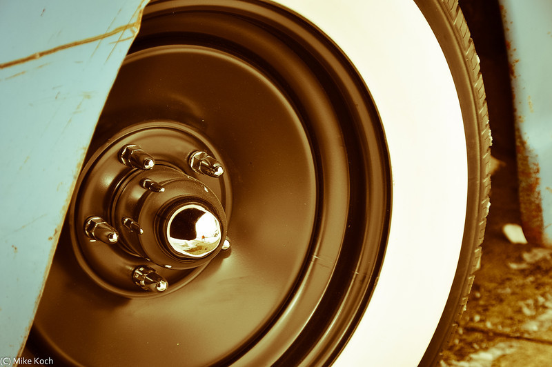

    I got my new center caps and bullet lug nuts installed on one wheel as well!!
  20. Zig
    Mike, what the heck is up with your centers? Is that a chrome collar or what? It really reflects the lug nuts nicely! Yes, I'm getting ideas!
