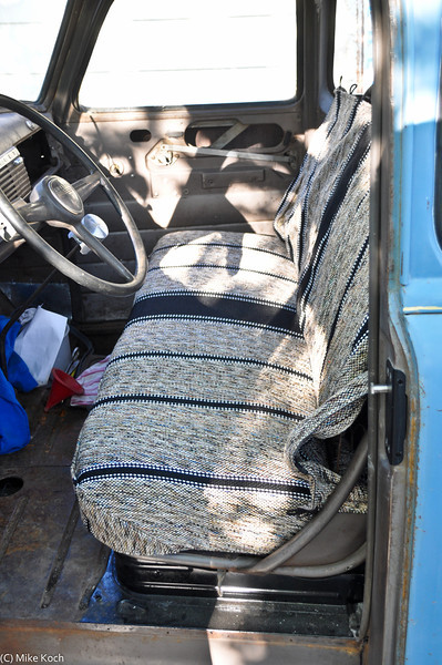

    This weekends achievements:
    Drivers door latch is done inside and out. Weather stripping also done. So impressed with the Altman kit. Easy to install and the doors latch so nice.
    Bed is installed and loose bolted along with passenger side fender and splash guard between running board and bed.
    Fiddled around tonight putting the seats bases in and cleaning up stuff. Spent some time with my 1 year old on my lap making motor noises and trying to honk the horn. Life is good!!

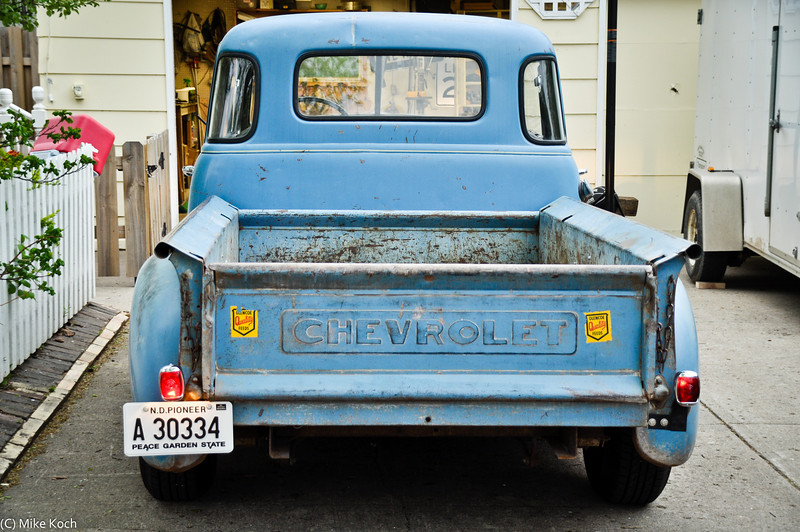

    Still plugging away a little at a time. Life is soo busy right now we projects and work........but the end is near for Henry!!
    Picked up a seat cover and seat rebuild kit from LMC. The cover is nice. Wish it was 2 pieces so I could removed the bottom. I bought a seat rebuild kit. Not overly impressed with that. Basically just some foam, a chunk of carpet and some hog rings. And only enough to cover either the back or bottom, not both. Live and learn.
    Anyway, got the bottom part of the seat cover done and installed.

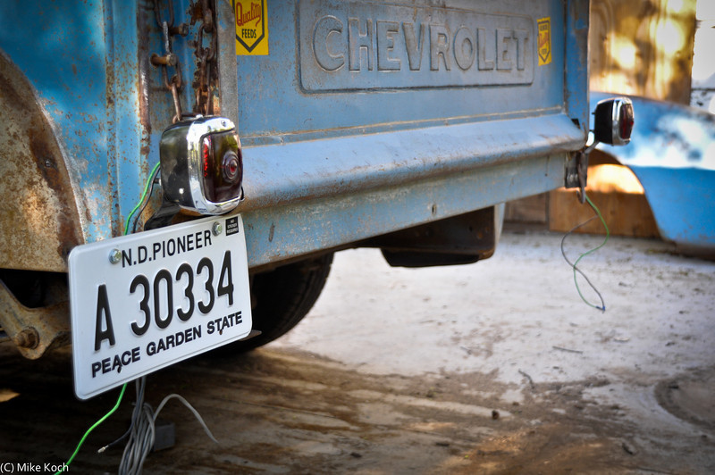

    Bolted on the taillights that I got from Wood1 last night. Still need to wire them. I found some awesome old 3/8" rusty galvanized flex I am going to use to cover the wires.
    Still need to get the fenders bolted up solid and bolted to the running boards. The bolt the bed down.
    Install rear bumper.
    Stereo is ordered......will be here Tuesday!!
    Itchin to drive this old dawg!!

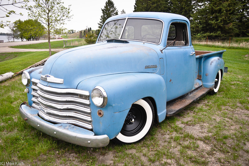

    Had a marathon late night session last night and got the brake leaks fixed and the brakes bled.
    Also tightened up the steering box.
    This morning I finished up the rear tail lights and put the rest of the cover on the seat and we set out for a test drive.
    Put about 20 miles on around town and came back to the house. Ran great, except ran a bit warm IMO.
    Check all the fluids, the anitifreeze was a bit low. Rest was good.
    Set out again for a little tool around the neighborhood.
    After stopping at a couple places around town it left us stranded. Seemed like no spark. Called a buddy and we pulled it home. Further inspection found no point gap at all. Adjusted the gap and started right up. Replaced the rotor and cap for good measure since they were shot.

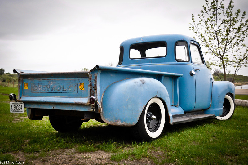

    Went out for another 45 minute cruise tonight. Temp got up over 200 (gauge showed 212 which is maxed). Stopped and took some pictures and let it cool.
    Drive home and the longer I drove the more it crept up.
    Got home and the coolant level is fine.
    Should I flush the cooling system? Any advice?

    OK.......so a little playing and working on the truck the past weekend.
    Last night my son and I flushed the cooling system with water and replaced the old thermostat. Topped it off and let it warm up. Comes up to temp perfect now.
    Went for a spin around the block and the temp rose again. Came home and checked coolant and it was a little low. I am guessing I had an air bubble. No problem. Topped it off again and went for a longer spin and it stayed right at 190 the whole time. I am holding out hope the cooling system problems are fixed.
    It runs great and the more I drive it the better it gets. Getting a ton of looks, and thumbs up around town. What a hoot.
