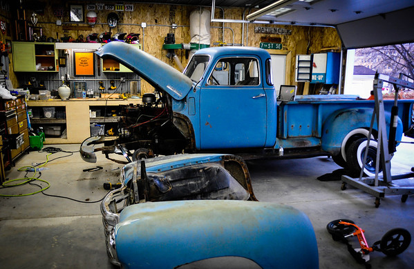

Henry's is getting a new motor and tranny. Picked up a low mileage 350/ TH350 combo and it is going in asap.
I have spoken with Russ about the whole deal. The stock 3600 tranny cross member will need to be removed and a new one for the 350 will need to be bought or fabbed.

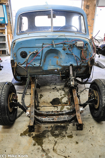

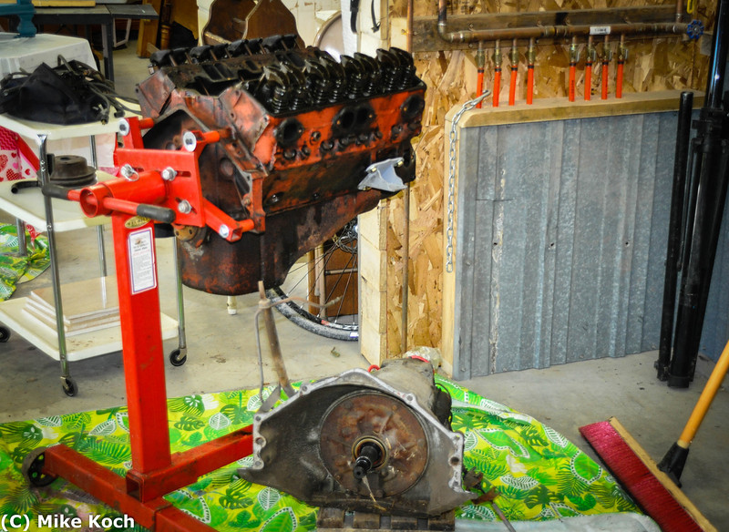

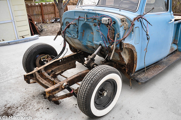

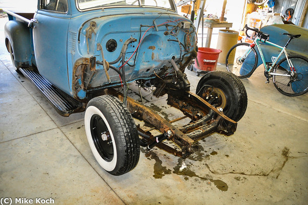

I was able to sneak away from work for a 1/2 day today. Was able to get the drive shaft and torque tube disconnected form the tranny. The unbolted the front motor mounts and some misc stuff that was in the way.
Then out came the motor and tranny. Wow.......that is heavy!!
My son and I must have scraped 25lbs of crap off the frame.
I then hit it with some heavy degreaser and the pressure washer!!

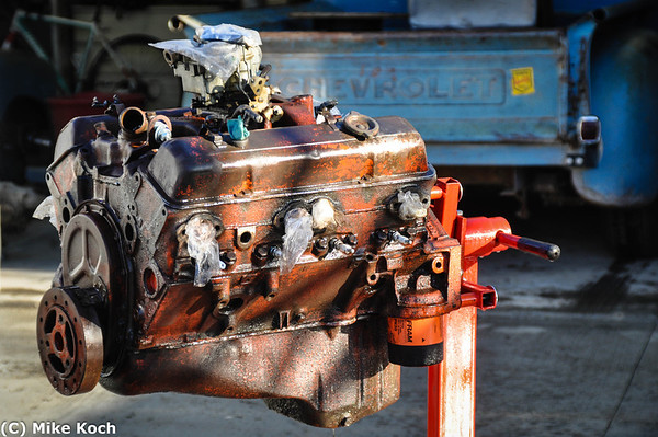

I cleaned up the SBC as well.

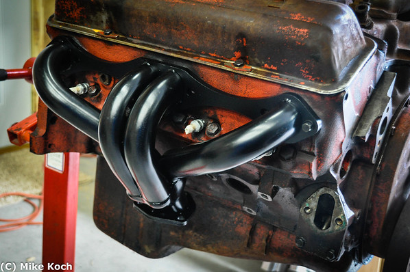

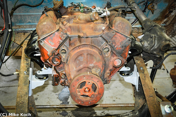

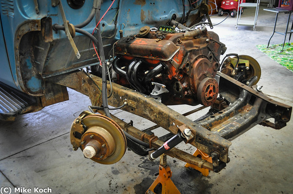

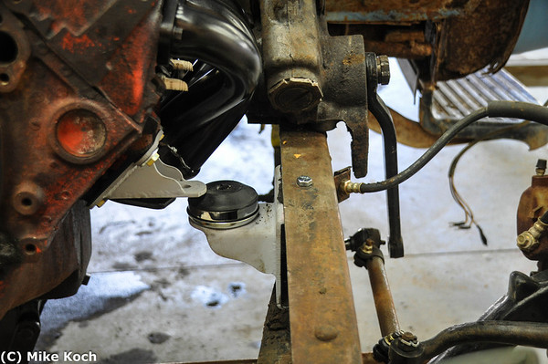

Bolted the TH350 to the SBC along with the headers and dropped it into Henry to get a test fit and mock up motor mounts and transmission crossmember.
Went fairly smooth considering I was working solo.

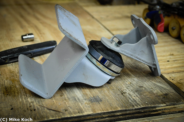

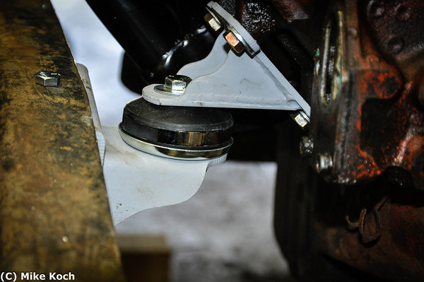

Chassis Engineering Inc motor mounts.
Ready to pull it all out and do the final welding, then paint!!

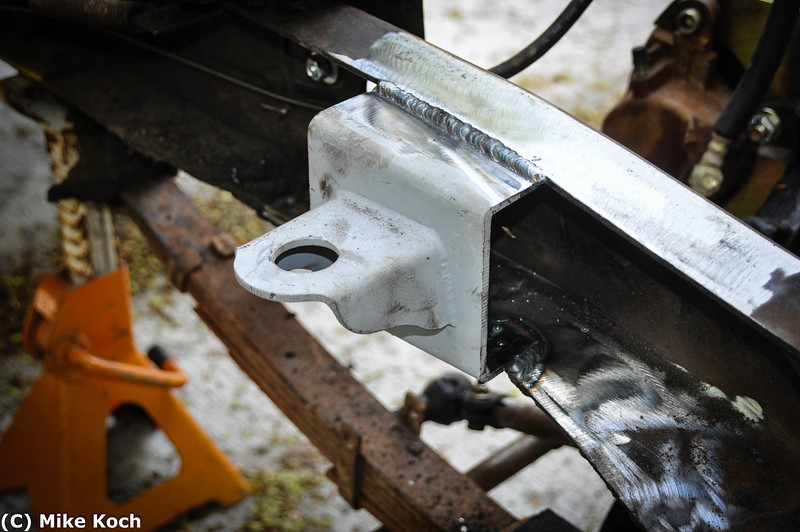

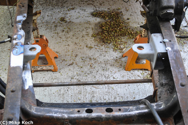

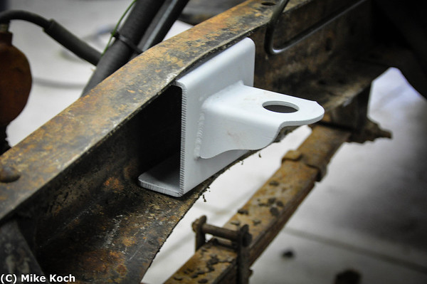

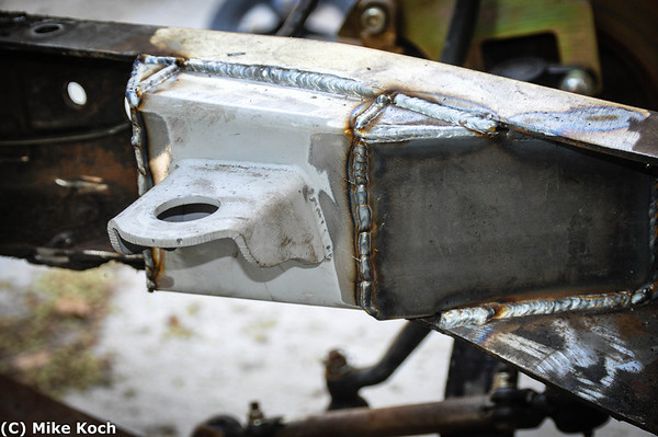

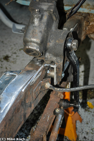

So after thinking about it for the night.....I decided to offset the motor to the passenger side to allow room for the steering box. I had briefly thought about PS......but decided against it for a number of reasons.
So I spent the better part of a day taking apart what I had completed and making room for the steering box.
The passenger side mount had to be shortened and recessed into the frame rail. The driver side was pulled out of the frame rail.
I used some 1/4-20 bolts to hold everything in place while I pulled the motor and to use them as a reference upon assembly.

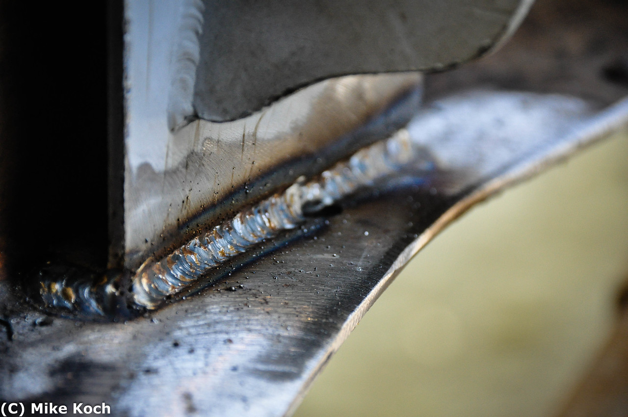

I was not happy with the initial welds on the drivers side mount, so I boxed it all in. Overkill.....but I will sleep better at night.
After the motor mounts were done....I spaced out the steering box by 1-1/2" with some angle iron and some dom tubing.
The motor has been opened up and looks great. I am going to button it back up, throw a coat of paint on it and call it good.
