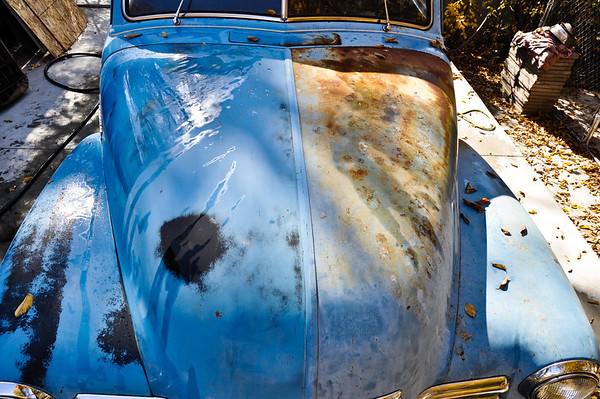

    Surface rest
    I have a 1949 GMC pick-up looking for that barn find look, Can you seand me the link on articles on surface rust removal using CLR and scotchbrite. How about more pictures of the hood done,Thanks-:p vkenney@bellsouth.net

    There are a ton of articles on Killbillet and Hamb regarding CLR to remove surface rust. A google search turns up a ton.
    http://www.jalopyjournal.com/forum/showpost.php?p=3852535&postcount=23
    http://www.thesamba.com/vw/forum/viewtopic.php?t=213707&postdays=0&postorder=asc&start=0
    The green scotchbrite does definately scratch the paint, leaving a satin finish. Not sure if it could be brought back by buffing. I am really happy with the finish.
    Some guys suggest using really fine steel wool to avoid the scratches.

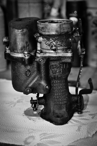

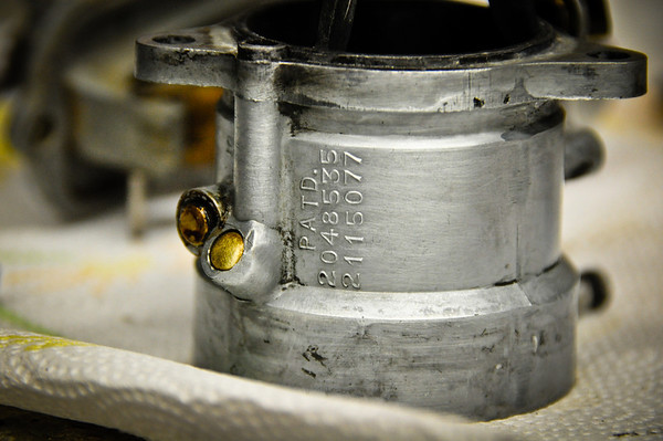

    Not much to report lately.
    I put a carb kit in the greezy ol W1.
    Definately runs and starts better. Still having an issue with it flooding itself out......or starving itself. It just get to the point that is coughs and bogs and dies. If I pump it a couple times it usually starts right back up.
    Other than idle adjustment and float adjustment, is there anything else to change on these carbs short of changing jets?

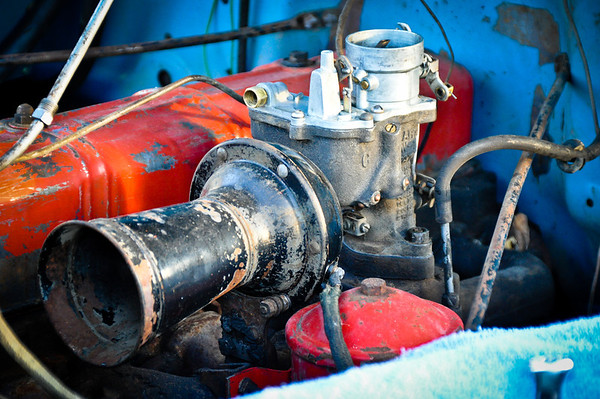

    Put new plugs in today. #4 cyl plug was wet on the old plugs. Pulled the #4 after I replaced the plugs and it was normal. :eek:
    Adjusted the floats to give it some more fuel and it seemed to be the trick. Starts better and seems to run great.
    Pulled the water pump, which was spewing water all over. There was a water pump sitting in the bed of the truck when I picked it up.......feels solid, so hopefully it is good.

    After you've put a see through plear plastic NAPA/WIX # 3001 fuel filter just before the carby inlet , then you should seriously consider trying " Grose jets " ~ this is a specal float valve that has two steel balls inside it instead of the usual cheap to make needle & seat .
    " Two Balls Does The Trick " .
    What it does is : provides vastly superior fuel level control and stops the carby from spewing hot fuel down the venturi and flooding the engine when you shut it off hot .
    I really need to get off my bum and buy one for my '6 C/10's 250... it floods terribly every time I shut it off hot , gotta hold the throttle to the floor and crank it moment before it roars to life with a cloud of black smoke .
    Black smoke is always un burned fuel .

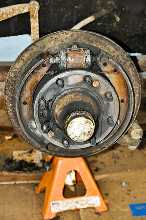

    So how do I preceed with reviving the brakes?
    Pads look good except for the passenger side rear where the pad fell off the shoe. Hoses look good.
    I was thinking about pulling the master cylinder, cleaning it up and trying to figure out if if needs to be rebuilt.
    Push some air through the lines, add some fluid and see if I can get them to bleed?
    Advice?

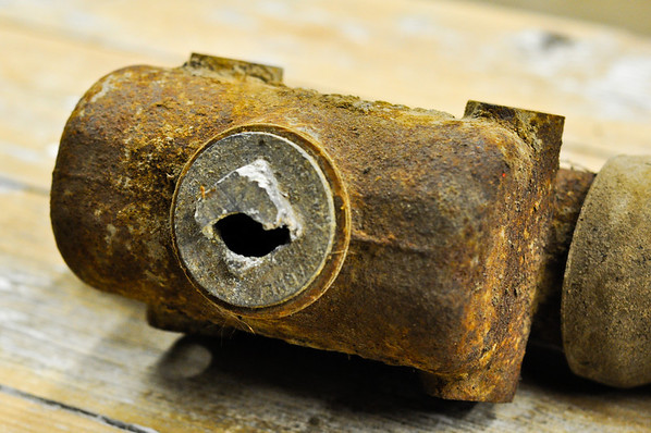

    Tried to remove the cap on the master cylinder today.....apparently someone else did at some time with no success.
    I could not get it to budge......looks like a new master cylinder is needed!!
