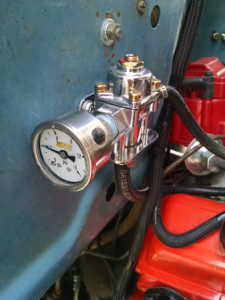

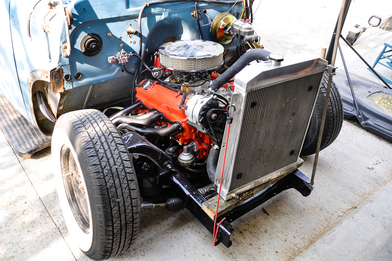

    I have been doing a little tinkering as time allows. I got my fuel pressure regulator mounted to the firewall and got all the lines ran.

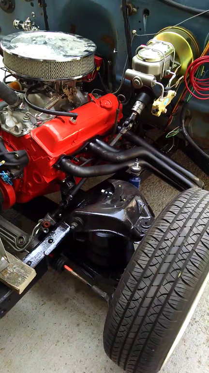

    Yesterday I spent a little time rigging up a temporary radiator support and we fired up the SBC for the first time in the updated chassis.
    Click the picture below to hear it run.

    Coach, that engine sounds, real good.

    Thanks.....I am pretty happy how good it sounds. EXACTLY what I was shooting for.
    I am a little concerned the bags are too big, so possibly the ride being overly soft. Time will tell.

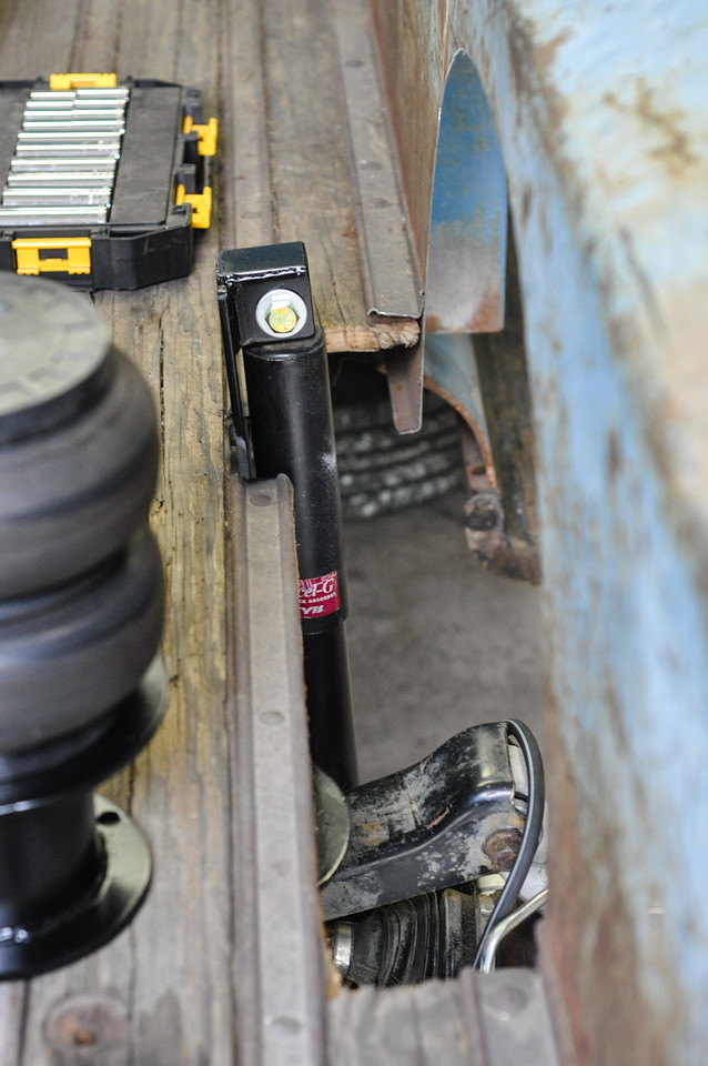

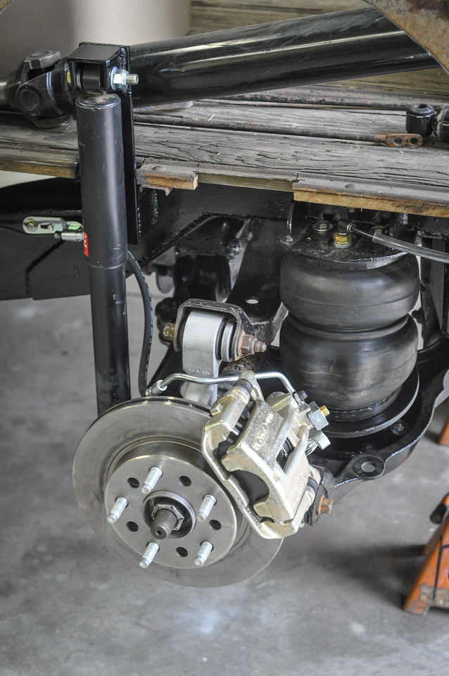

    Rear shock mounts built and painted.

    I guess I'm not seeing enough of your fabricated shock mount. If you are using just a single flat piece of steel for the vertical portion, that doesn't seem beefy enough to me.
    You will have to gusset that, I'm thinking.

    I am undecided if I will change the shock mounts at this point. The flat stock is 1/4" thick and I feel the majority of the stress will be vertical.

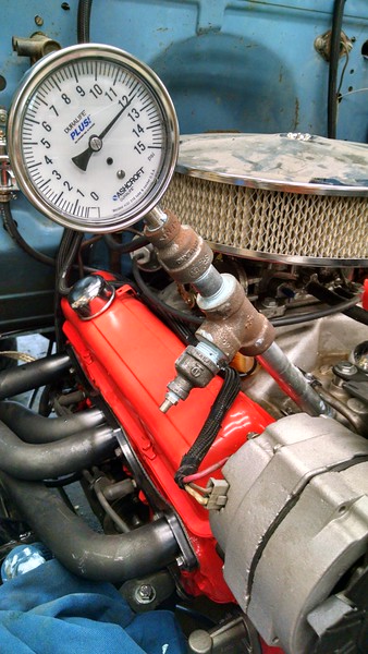

    After that there was a step backwards. I filled the tranny and started the motor to check the tranny fluid level. All seems fine. For kicks I checked the engine oil. Oil was really milky. DAMN.
    When I did my initial start up I had a couple bolt on the passenger side rear of the intake that were weeping. I am guessing I forgot to do the second pass of the 25ft/lb torque for them. I tightened them up, the weeping stopped and I continued on with the start up. I am wondering if that leak also weeped inside......or do I have another problem?
    I dumped the startup oil. I did not have a fresh filter, but I topped it off with fresh oil and let it run for 15 minutes and dumped it again. Still milky, but not near as bad.
    Picked up a couple new filters this morning on the way to work.
    Not sure if this is all residual water from the initial leak or if I should start digging into finding another leak.
    Any advice??

    Maybe pressurize the coolant system- it'll only go to 15 PSI (or whatever your cap is), and see if it holds pressure. Sounds like you haven't gotten it HOT yet, to the point where gaskets might creep if not snug. Another oil and filter change is in order, and if it is less milky than last time, I'd say the tightening worked. It doesn't take a whole lot of water to turn oil milky, but engines prefer their oil straight up, no chaser.

    I just grabbed some misc pipe fittings to build a DIY coolant pressure tester. Plan on doing it tonight.

    I took some time this afternoon doing a pressure test on the cooling system. I cobbled together some pipe fittings and a pressure gauge.
    Held pressure for well over and hour both with the motor hot and cold.
    I changed the oil and filter 2 times and now it appears to be dried out......

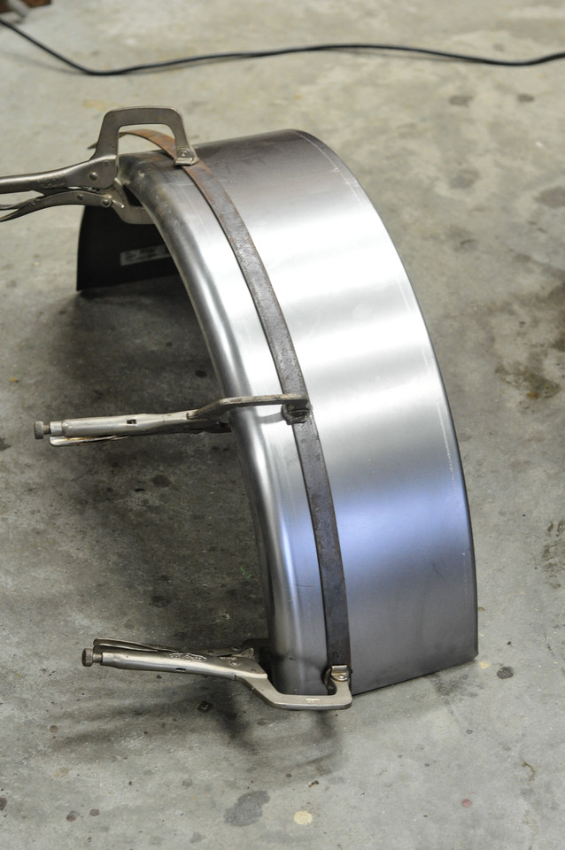

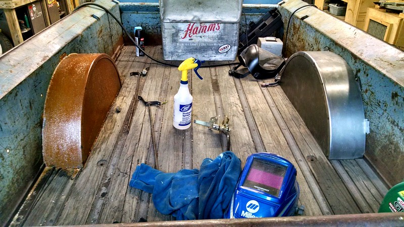

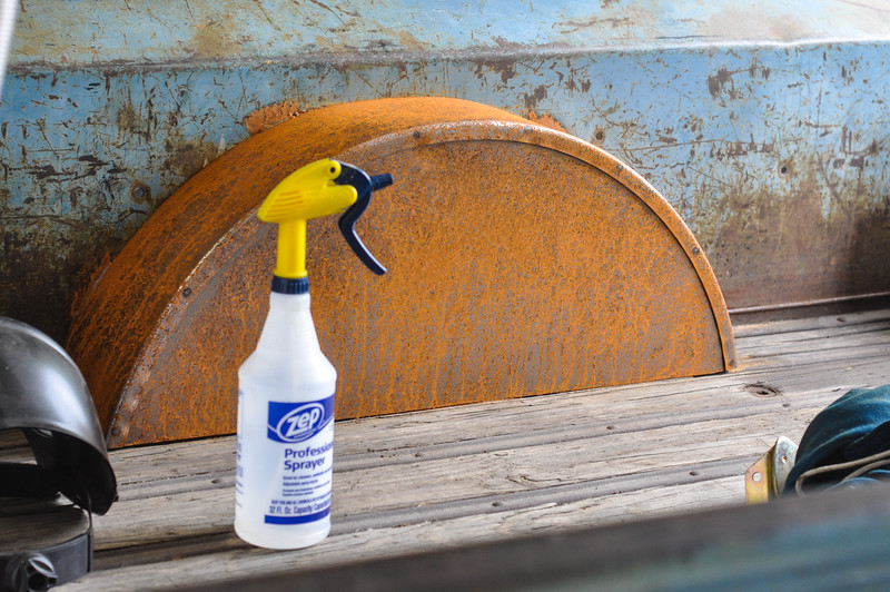

    Solid couple of days. My trailer fenders arrived to make rear wheel tubs. I cut them down with a skinny wheel with a guide. Would out great!
    Installed
    Patina'd

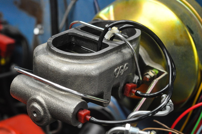

    MC bench bled and bled the rest of the brakes.
    List is getting shorter!!
