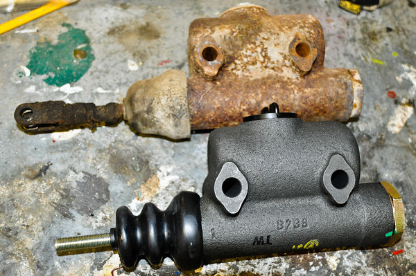

    I did recieve my replacement master cyl from Rock Auto.

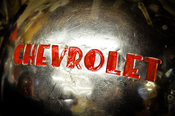

    I also spent 30 minutes cleaning up one of my stock caps with some scotchbrite and some glass cleaner. Probably not the best choice......but it was sitting on the bench in front of me. It cleaned
    up so well I stole some of my son's model paint and a bush and painted in the letters. Couple more coats of red and it will look good I think!!

    Looks like you're making progress ! where was the master clinder manufactured ? .
    Just for fun , try my de rusting method of water and Citric Acid Powder , drop that junk master cylinder in and wait , you'll be amazed at how clean it comes out .

    I am not sure on the master cylinder, it is not marked. It is a Cardone.

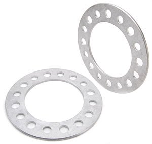

    You know I really need to check Russ. I did not even bolt the tire up. I just flopped it up there.
    I will bolt it up tonight and take a look and try to get better measurement. For sure I will need the 1 ton tie rod ends.
    Can you recommend a source for the spacers? Thank You!!
  20. Coach529
    Coach529 Member
    Oct 2, 2012
    585
    Jamestown, ND
    Found some...........Google is such a valuable tool!! :)
