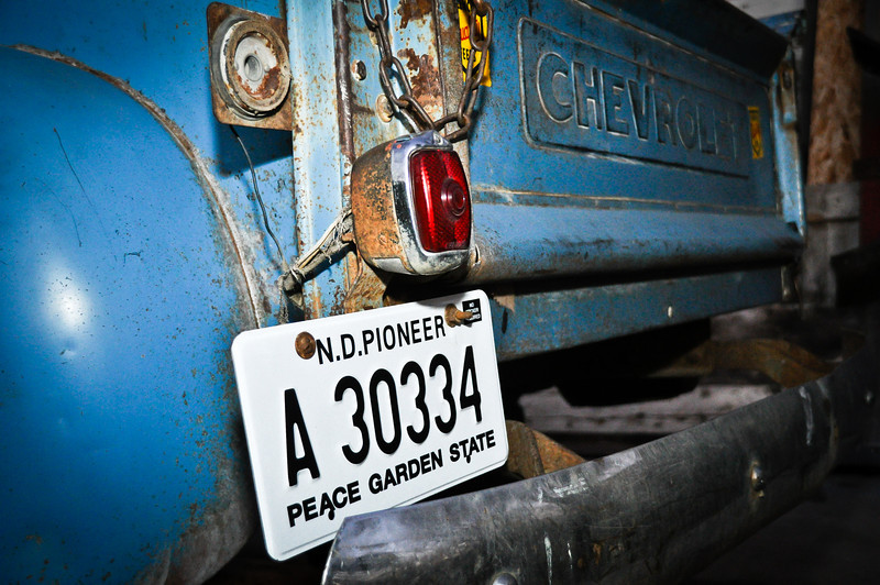

    12v conversion is complete. All bulbs have been replaced and functional except the blinkers. The sockets are shot and I am thinking the relay is as well.
  3. vwnate1
    11,701
    De - Rusting Bulb Sockets
    Mix up some Citric Acid Powder and water , soak 'em , brush a bit with an old toothbrush and marvel at how they're shiny clean bare metal again .
    Rinse in Baking Soda & Water to prevent re rusting , paint the backside and reflector with gloss white Rustoleum paint and lightly grease the bulb bases , they'll work fine .

    Thanks......I will give it a shot!!

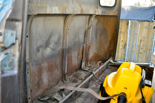

    Not much forward progress lately. The weather and other activities has slowed the project.
    I got the tank back from the radiator shop. Clean as a whistle and ready to install. I bought a new level sensor as well.
    Spent a little bit of time on Friday cleaning up behind the seat and prepping for the tank to be installed.
    I am covering the back wall and floor with Peel & Seal as a cheap alternative to Dynamat.
