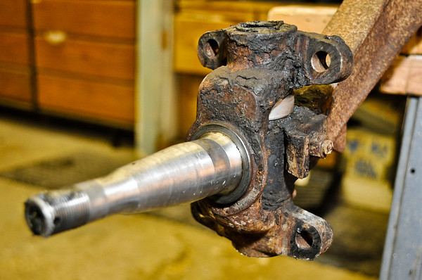

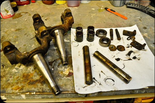

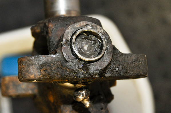

    King pins are out and the axle is prepped to send to SID to be modified!!
    droppedaxles.com
    I had used the PDF below as a guide to pull these apart, but they were quite a bit different.
    http://www.stovebolt.com/techtips/kingpin.pdf
    My spindles (out of a 1949 GMC) did not have retaining rings. Directly below the dust caps was the kingpin.
    I pulled the dust caps and removed some of the excess grease in preperation to press the king pins out the next day at work, where I have access to a press. After I had them cleaned up, out of curiosity I grabbed a hammer and punch and gave the king pin a good whack. To my suprise it moved. 15-20 well placed whacks and the king pin hit the floor. Same with the other side.
    Both sides were clearly well lubed, so I am sure this played a huge roll in there ease of removal.
    How do I know f I need oversized Kingpins when I replace them?

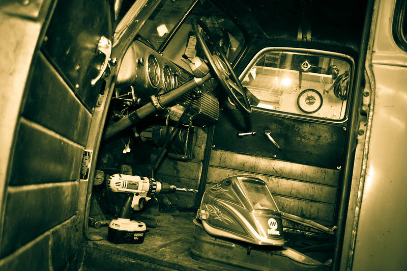

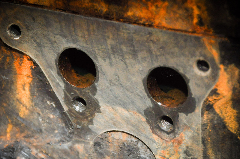

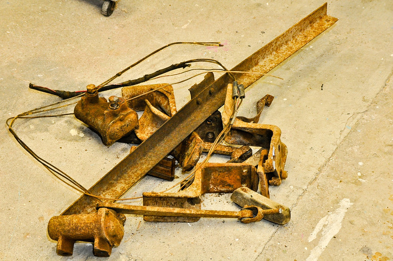

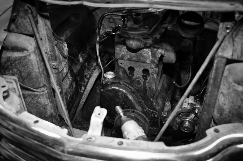

    Finally got enough furniture moved out of the garage and organized that "Henry" was able to move indoors. Not sure for how long. For now he will have to remain mobil.
    First stop was a quick trip to the carwash to clean off the rear frame rails. 63 years of dust and dirt had packed into everything. Plenty of looks on the way to and from the car wash. Even had a couple gawkers while I was washing. :cool:
    Once I got him home I back him into his temporary parking spot and went to work right away. Removing old mufller brackets, lever shocks and overloads was first on the agenda. Of course nothing come apart easy. A 4-1/2" grinder and a skinny wheelis the most used tool for the day.

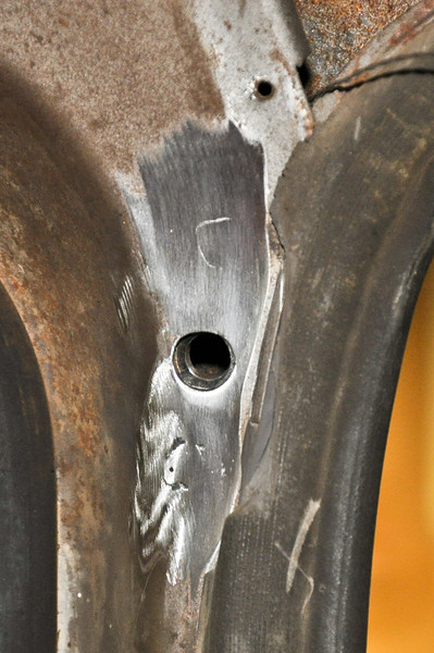

    After the rear rails were free of excess I turned my attention to the drivers side floor
    I got the cab mount bolt out after some persuasion. I got the e-brake pedal disassembled and was ready to cut the floor out when I ran out of time. Tomorrow is another day!!
    Trying to figure out what I am going to use for paint on the floor, interior and rear frame rails.
    POR-15?
    KBS coatings?
    There is some surface rust in the cab floor, door jams and interior door panels. Not sure if I can just wire wheel it of and prime or if I should use a special paint.
    We are going with a non tradition paint color in the interior. Flat or Satin Black

    Great update. I was very fortunate and only needed to get stock size replacements. Was there any play in the kingpins before you removed them? Check the kingpin bushings. As soon as I removed the caps, I could tell that I got lucky and all of the wear was in the bushings themselves... the kingpins had not wore into the spindles themselves. If yours were that easy to remove due to being properly lubed and maintained, I'd wager that you'll be fine with stock kingpin replacements.
    Damon
  7. Coach529
    Coach529 Member
    Oct 2, 2012
    585
    Jamestown, ND
    The bushings were pretty much shot, but no wear on the king pins at all.

    Don't just check the kingpins themselves, be sure to check the spindles, too.

    I did inspect the spindles as well. No visible wear.

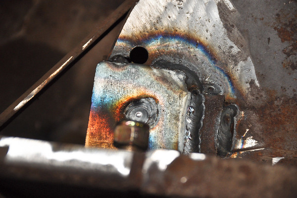

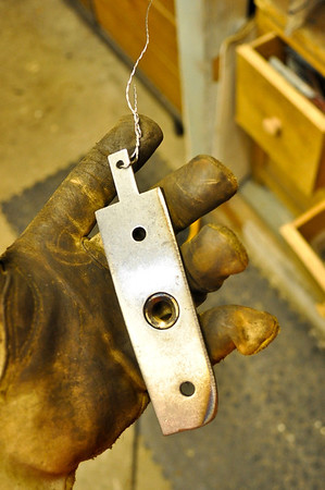

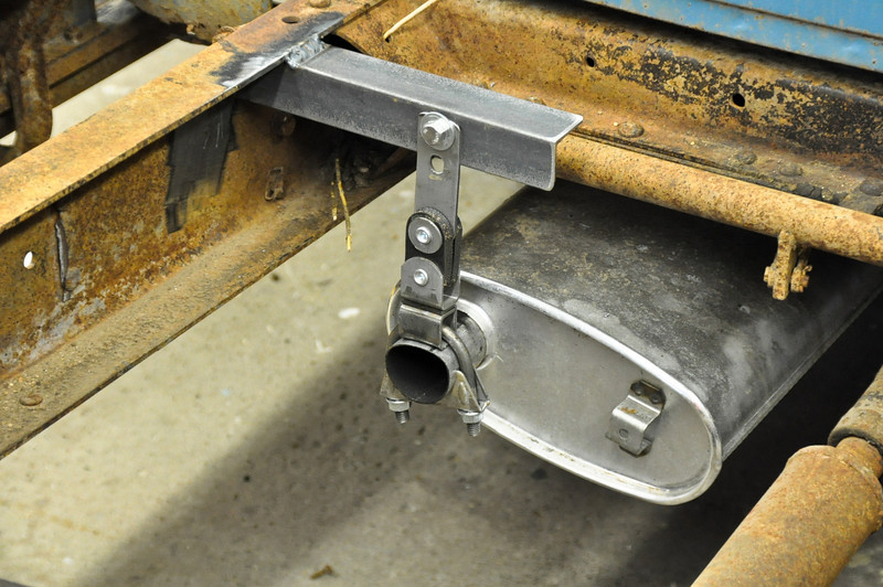

    First line of business was a muffler bracket. I had a waste chunk of angle iron that fit the bill perfect. I am unsure if I am goingto run my tailpipe out the back, or just bend a 90 and out the drivers side under the running board.

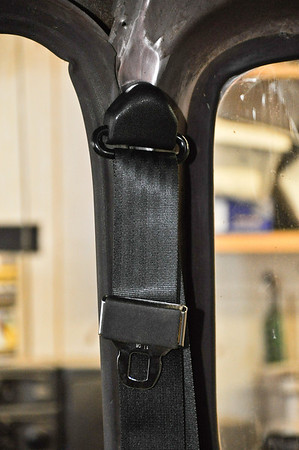

    I then started installing my seal belt kit. Followed the instructions below and it went really smooth.
    http://www.julianos.com/how2_3point_antiqu...hevy_truck.html
    A small chunk of safety wire was used........I did not want to drop the bracket and not be able to retrieve it.
    A little paint will dress that right up.
    Some of the welds were tough due to location. I had a tough time getting my head back there to see what I was doing. Not too pretty, but should be plenty strong.

    How do i know if i have to use overzised kingpins ?
    Mine where a bit sloppy as there should be no play at all there. Pins must be straight and no rust pits on them. I messuared the spindle holes and old pins very accuratly , then i had a machine shop to drill new spindle holes and pressed the oversized pins in its place with lithium grease . Sid is a good resource to ask about this ! I think he sells the new pins aswell.
