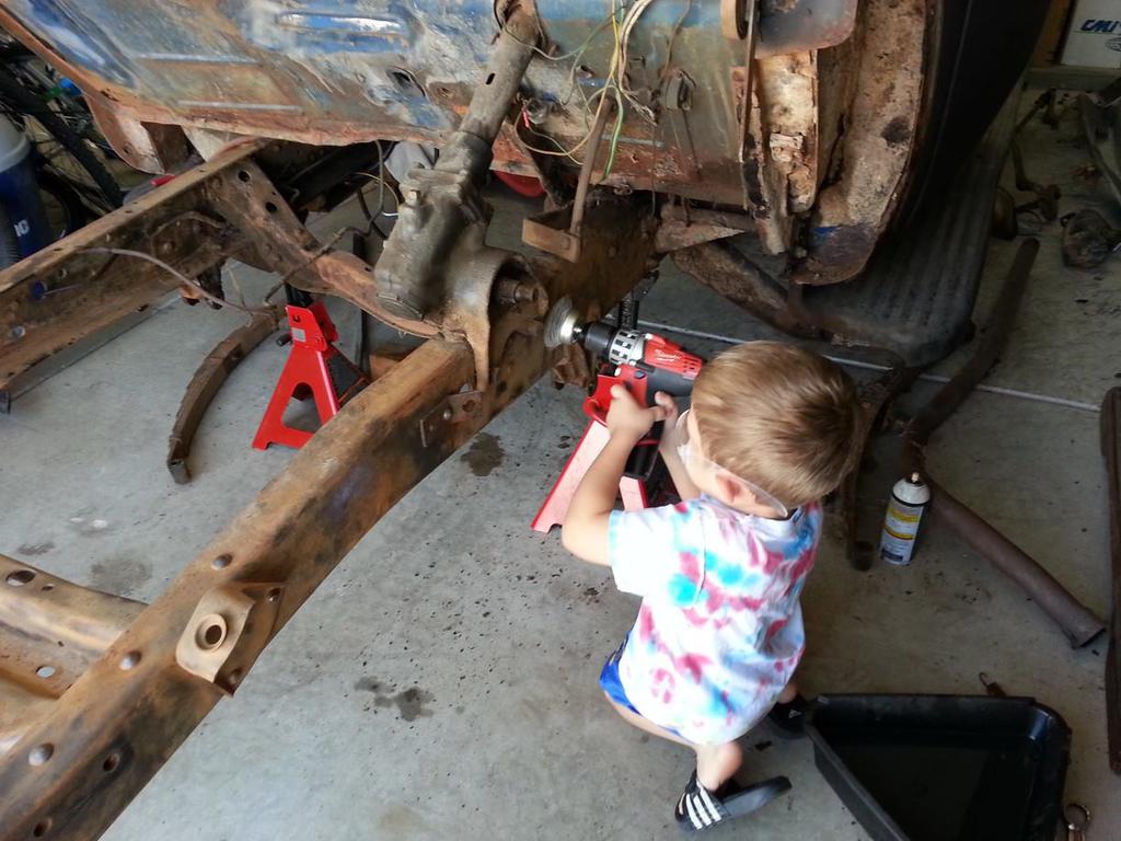

    I will holler one of these days. I actually prefer to work alone, *mostly* nice and quiet. But you know how it is, occassionally you need that extra hand.

    It sure saved my toes/fingers/leg/whatever from getting smashed!

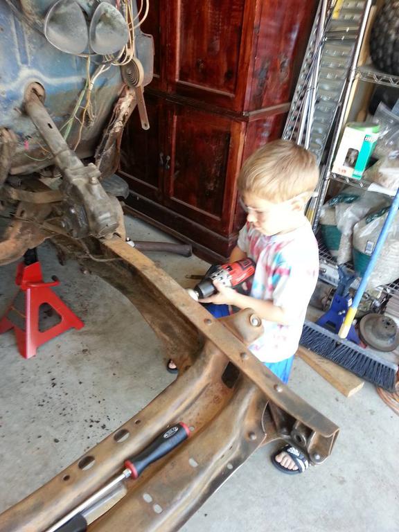

    So I spent most of the weekend cleaning up the front of the frame. Would love to just remove the cab and do the entire frame all at once, but unfortunately garage space will not allow for that. Soooo, I will prep and paint the front of the frame, then the rear, then lay the cab back to do under the cab.
    Have been using putty scraper, screwdriver, and drills with wire cups. Hard work! I should have degreased it first, but really didn't want to bring the hose into the garage and get everything wet. And my driveway is steep, so I have no option to wheel the truck outside. Soon, I will build a small frame, lined with plastic, to catch the water, and direct it out the garage door (think downspout splash pad, but a wee bit larger). Even though it has been slow, we are making more progress. And my helper actually showed up to work... lol :cool: And my Prep Step and Zero Rust should be here sometime this week.

    awesome!!! i like your helper. i used to be one of them, then i got my own projects
  6. vwnate1
    11,703
    Good daddy !
    I see you're teaching him to use safety gear , that's important to do at an early age so he'll always be comfortable with it .

    Thanks Skeeter. Yeah, Nate, he knows. He had a bandana over his face too, but had just taken it off. I try to get him in the mindset when working on something, safety is important.

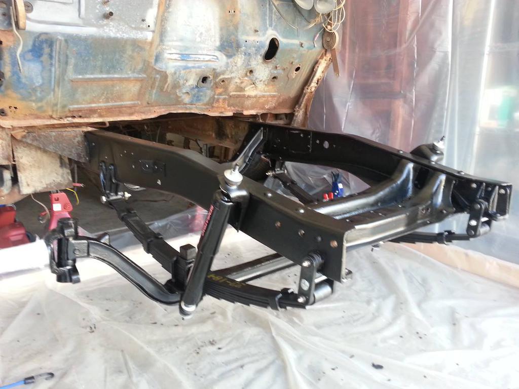

    Front of the frame go painted over the weekend. Looks ok from 4-5 ft. away, but I'm not happy with the Zero Rust. Using the prep step as a cleaner (as suggested) had little to no effect vs. the wire cup I was using. And the actual Zero Rust paint? When I swiped it on a small area, it would gel up before I could come back to smooth it on the next stroke ( > 10 seconds). Might be good paint, but didnt turn out smooth using the brush method. Maybe the key to using it is to thin it down and spray it?? Ohh well. When shackles, u-bolts, shocks, and springs come in from the host this week, I'll be assembling the front end/drop axle and can start on the rear.

    looks good from here
  12. Zig
    Yup, it looks great!
    Ya know, if you took the cab mount bolts off/out you could do like I did and roll the cab straight backward on the frame allowing access to the frame that is under the cab and the bottom of the cab. It really makes that part easy!
    Anyway, Thanks for the pictures, it looks GREAT!!! :cool:

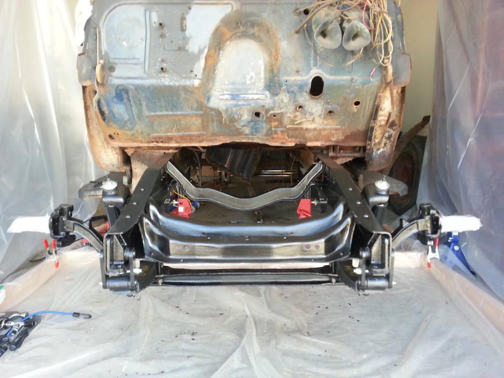

    Front end assembly went well. Kind of. The new leaf springs from the host were about 2mm (0.078") too wide for the rear hanger. Didn't know if the hanger had been distorted from the tightening of the old bolt, but I didn't want to chance buying new hangers, bolting them to the frame and find out I'm in the same situation. So I just ground down a tad over 1mm on each side of the springs.
    Disc brakes will be here tomorrow, and wheels on Friday. Since I am off on Friday, I should get some more stuff done this weekend.

    ooohh man that drop axle looks sweet.
  19. Zig
    Yessss in deed!!! that's looking mighty fine!
