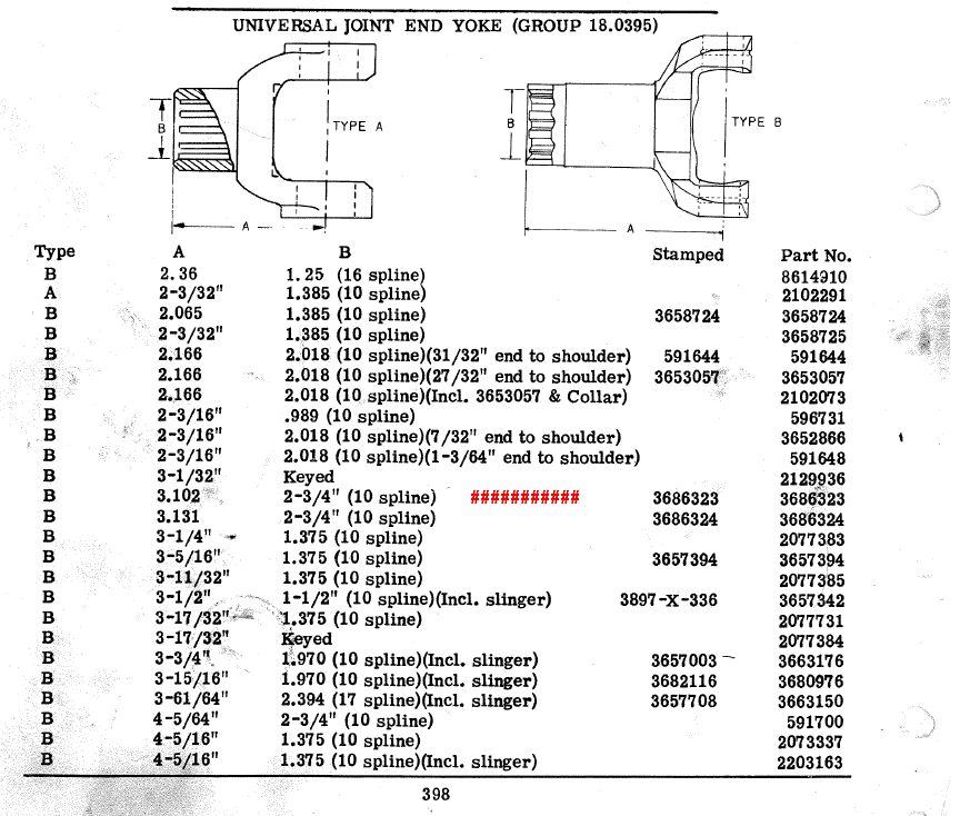

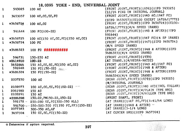

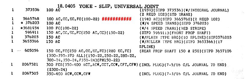

  6. Bill Hanlon
    2,729
    Fredericksburg TX
    Glenn:
    I don't have the U Joints you are looking for, but I'm willing to look elsewhere. I'm trying to understand how many of each you need. The way I read the Master Parts Book, your 102 would have two 3665768 and two 3686323. Reference the picture in the 4th post above as well as these pictures. The red marks below are the parts you have expressed interest in.
  7. GMC downunder
    GMC downunder Member
    Jan 3, 2020
    7
    Hi Bill
    Thank you again. My understanding is the same - unfortunately mine has been replaced with incorrect yokes. I have purchased one good rear yoke. I need 2 of the front (3665768) and one rear (3686323). Best wishes, Glenn

  14. Bill Hanlon
    2,729
    Fredericksburg TX
    My GMC Master Parts Book shows only one part number for 18.0170 in a 1/2 ton '53 half ton (102-22) with no comments about which of the 3 transmissions that were available. So I assume (that word will get you into trouble) that the same piece was used on 3 speed, 4 speed and Hydra-Matic trannies. It is noted in the book as "7 9/16" long" and was used from 1950 through at least 1953 (I don't have 54 books, the last year of the torque tube.).
