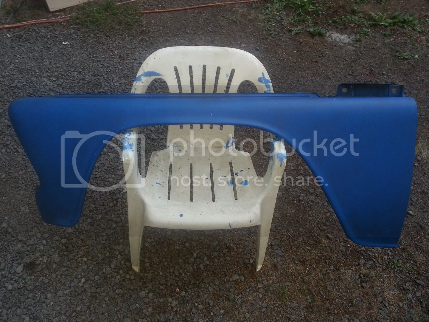

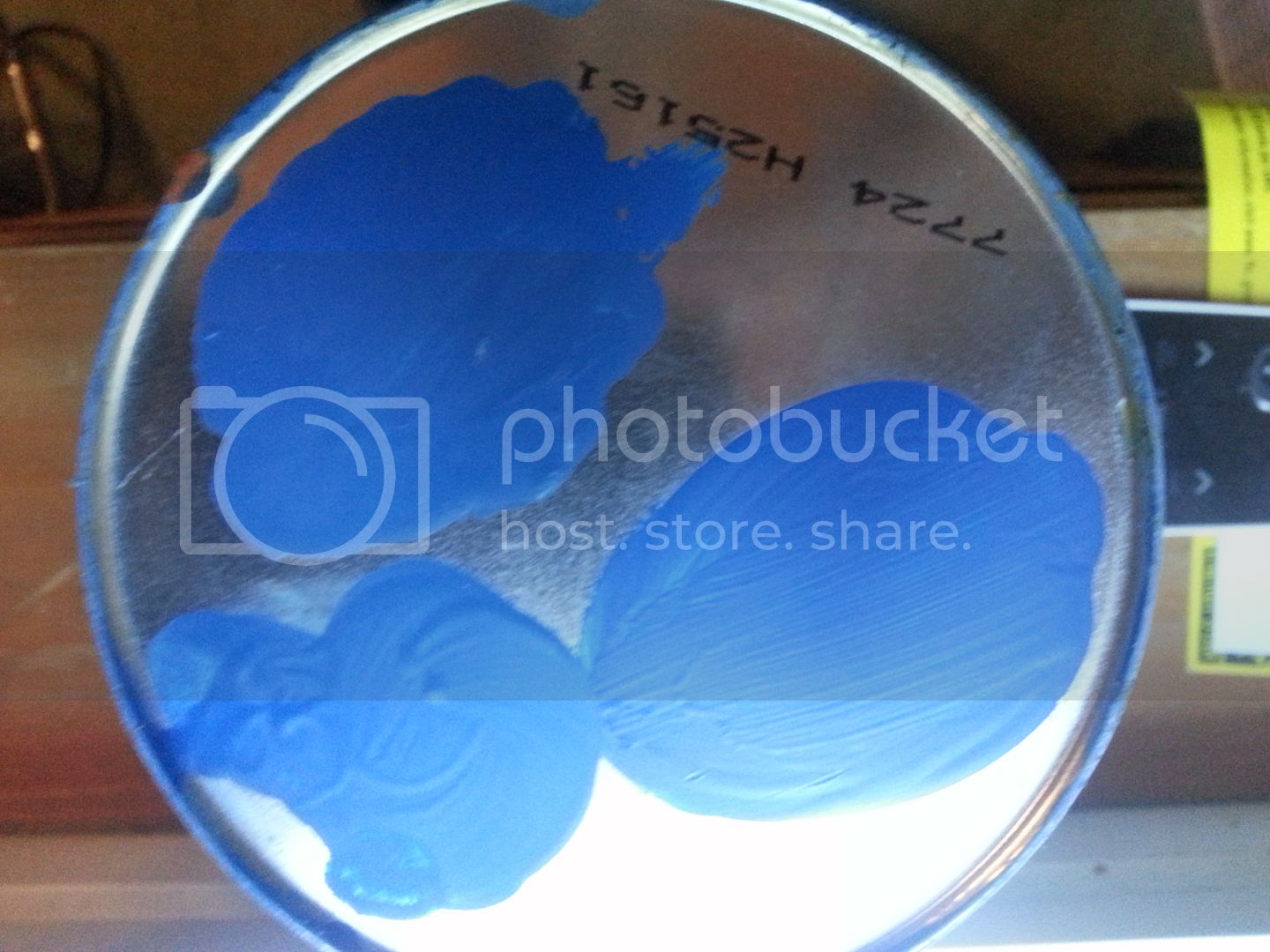

    I had a local paint store mix up some enamel the same color as the blue epoxy.
    The bottom right is the epoxy. - good match:

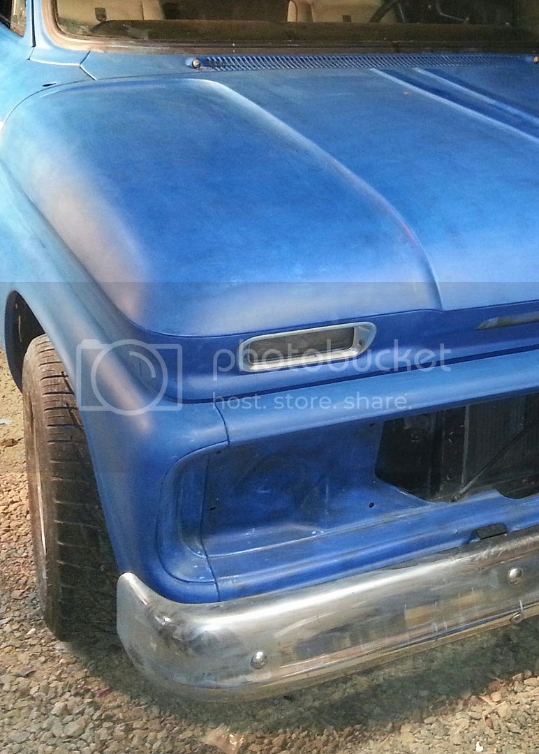

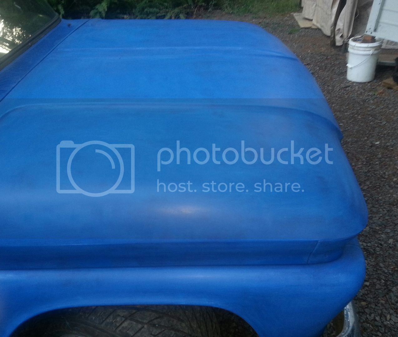

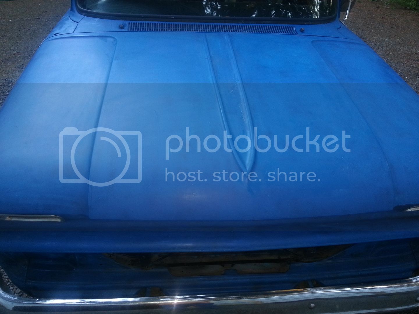

    Here is my first attempt to emulate MisterC's truck:
    (I really like how it's turning out.)

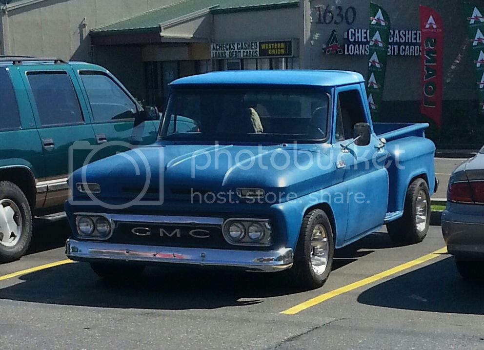

  3. LostMy65
    LostMy65 Member
    Oct 6, 2010
    179

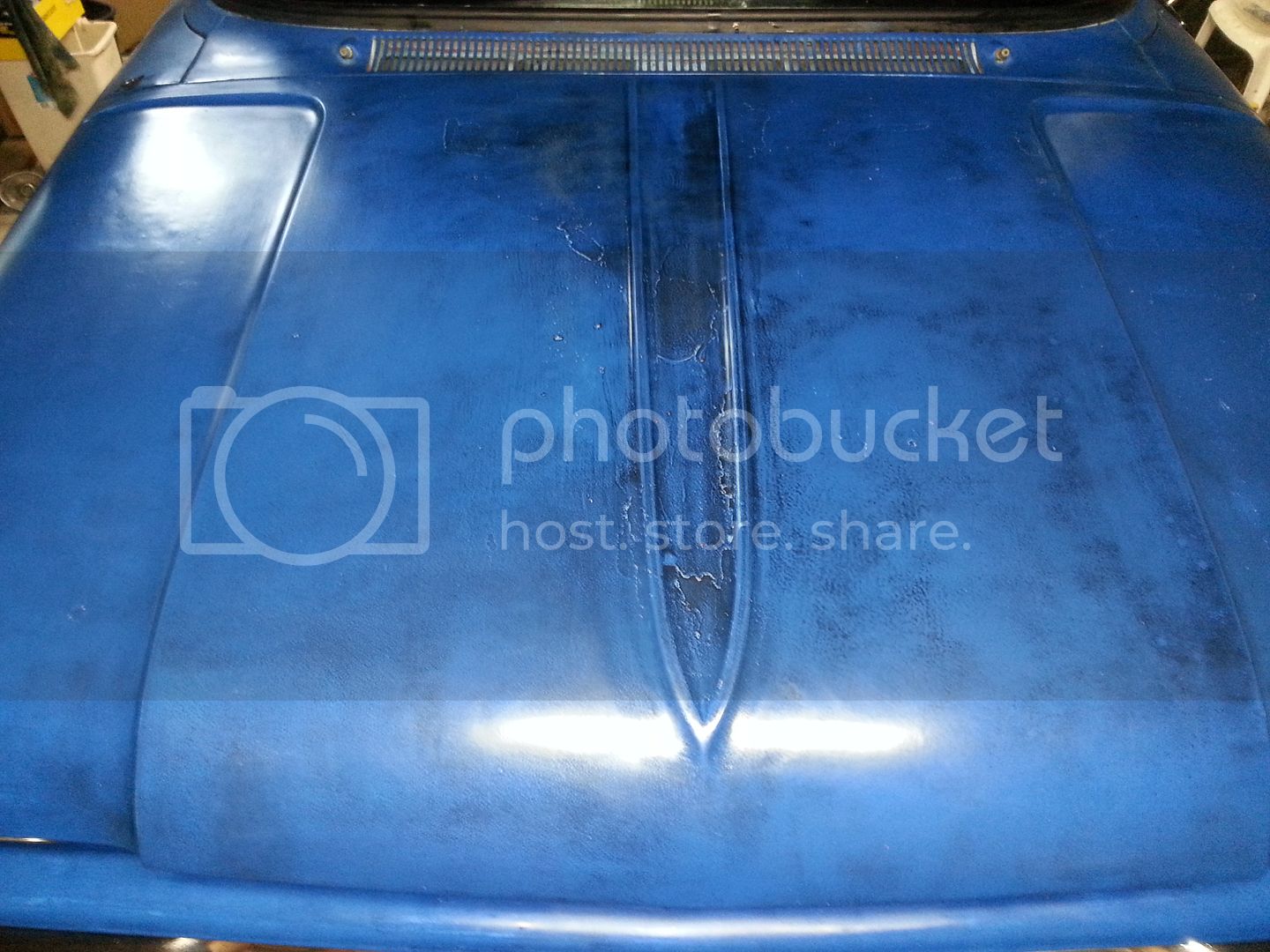

    Here's a recent pic of mine;

    Really looks good.. I am curious as to what kind of prep work you did before applying the epoxy? Sand / scuff the existing paint, wipe down with any thinner or wax remover, apply any primer? Any post paint sanding?
  6. LostMy65
    LostMy65 Member
    Oct 6, 2010
    179

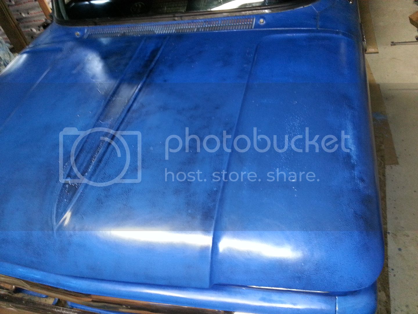

    The first thing I did was give the truck a good scrub wash with dawn soap and scotchbrite pads. Then a few weeks later I rolled on blue enamel paint over the whole truck.
    Didn't try to be real careful, just wanted to get a nice coat of all one color. Painted over dents and rusted areas. Just wanted everything covered.
    Then I left it like that for close to two months.
    Then I did redneck body repairs just to get rid of the real ugly stuff. Hit those areas with the same blue enamel. Then, I went to the local Autopaint store to see what they had in choice of blue epoxy primer. Picked a color I liked and had them mix me up a quart. The way I decided to go with the repairs, exact mixes won't be an issue. Then I went to Sherwin Williams and had them mix me up some blue enamel to match the epoxy. I then hit my whole truck again with this richer blue that you see on the can lid. A couple days later, I dusted the truck with black primer.
    Then weeks later, I went over the truck with wet/dry 600 grit - using water - doing very light sanding to allow the lower more rough coats of lighter blue show through, but also allow the black to remain settled in the imperfections of the rolled on paint job.
    Now, as I do repairs I can just roll the repaired area with the blue epoxy and lightly dust it with black primer, lightly wetsand it, and it'll blend right in.
    I really like the faux-tina look for the practicality of it.

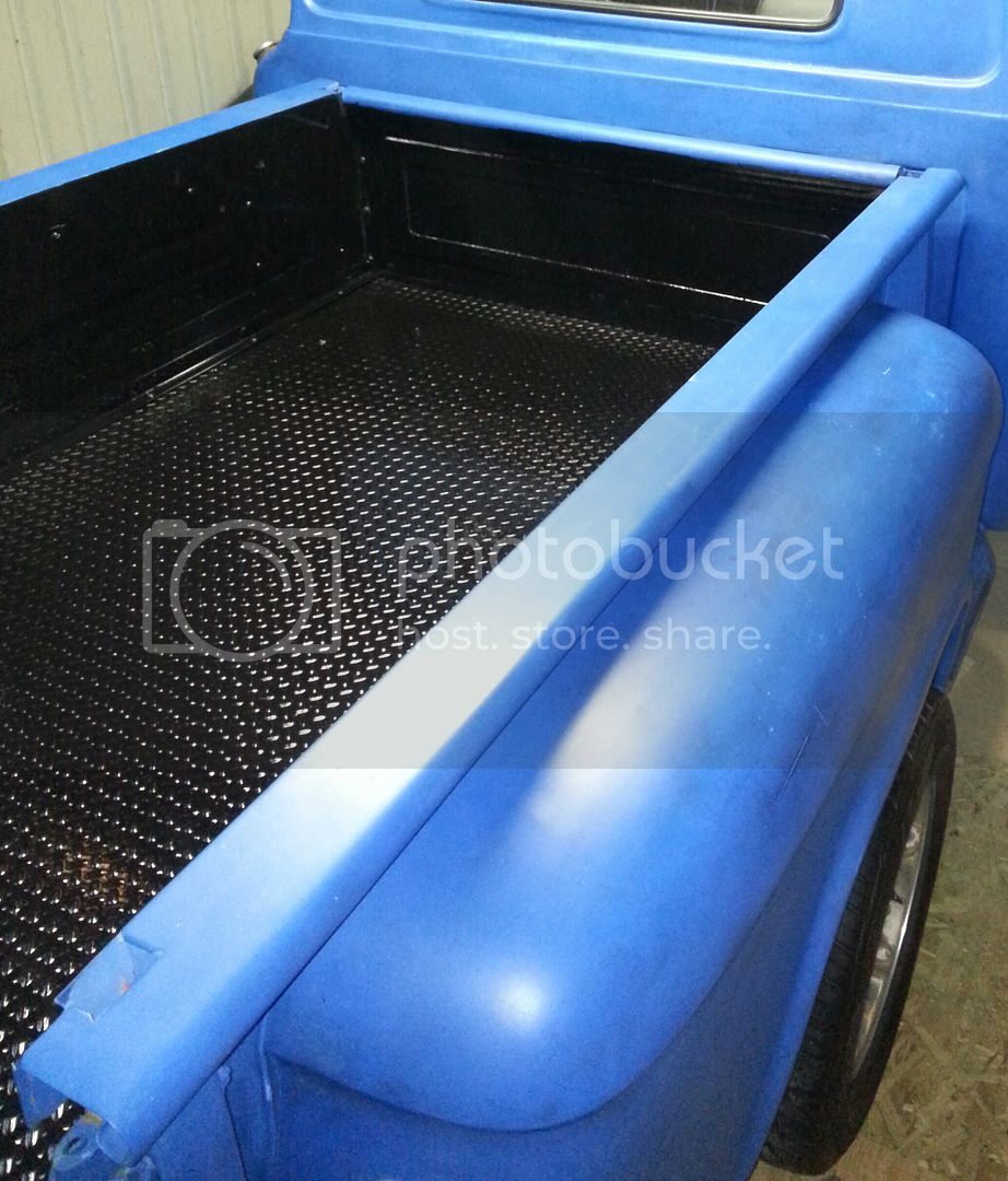

  11. LostMy65
    LostMy65 Member
    Oct 6, 2010
    179
    Keeping with my cheap paint so I can use it as a truck, I finally painted inside the bed.
  12. Lakeroadster
    Lakeroadster Member
    Jan 23, 2011
    1,599
    Central Colorado
    Nice... what did you use?
  13. LostMy65
    LostMy65 Member
    Oct 6, 2010
    179
    Just Rustoleum Gloss Black.
    Yesterday I put some clear on the hood to see if I like it.
    I'm not sure.
  14. Lakeroadster
    Lakeroadster Member
    Jan 23, 2011
    1,599
    Central Colorado
    They do clear coat a lot at Gas Monkey Garage.. I think the sheen looks un-natural... FWIW

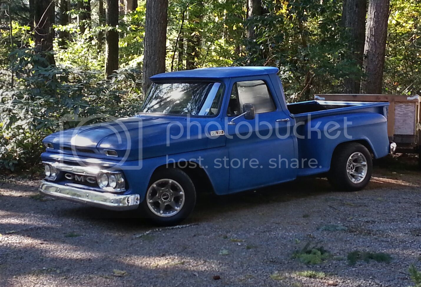

    I think I am finally done with runs to the dumps and such. The last things I wanted to keep my truck mobile for is done for the winter.
    I didn't get done what I wanted to do last winter with the truck, so hopefully this winter.
    [​IMG].
    Goals:
    Swap in the Th350.
    Upgrade to power steering and power brakes.
    If the above goes well; maybe more.
