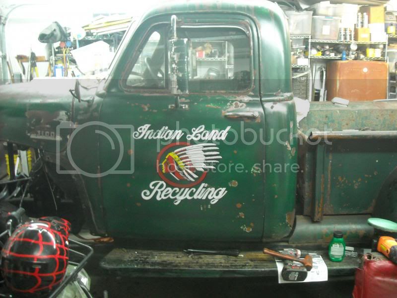

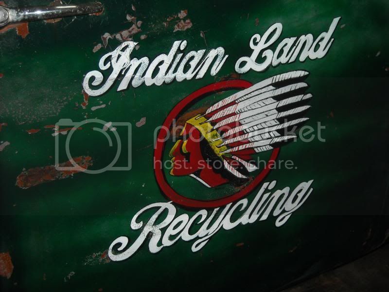

    Got some door art painted on it...
  7. ccharr
    Great looking door Russ.
  8. Zig
    Oh heck~ that's YOUR painting???
    I thought it looked mighty sharp to be old lettering, but the way it goes right over the rough spots makes it look like it's been there a l-o-n-g time!
    Rock on, Russ!
  9. ol' chebby
    3,167
    I let it sit for a few days, then wet sanded with 600 paper, concentrating n the upper part of the door where the sun would hit it more.
  10. Zig
    That is slick!
    Believe me~ When I saw that I didn't think for one second, "CHIEFS!!!"
    And NO, I didn't see something like this on the side of my truck in my mind! ;)

  11. ol' chebby
    3,167
    More likely pilfered from Indian Motorcycles. Indian Land is the community, it used to be the Catawba Indian reservation, circa 1700s.
