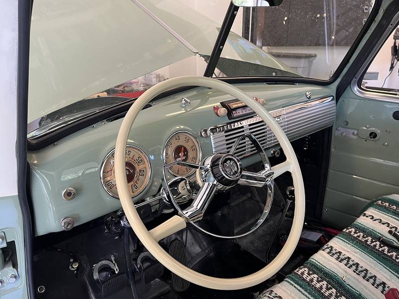

Put in a new steering column that I built and a new 'accessory' Chevy car steering wheel from the same period.

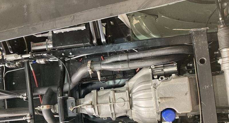

After 40 years of working under cars on jack-stands/ramps, it's a real treat to get under a car and be able to see. I laid on the floor (for about the last time, I hope) to take this picture

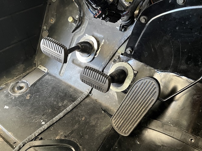

The hydroboost I rebuilt and behaving pretty much like it is supposed to. I shortened the pedals a couple of inches and installed some boots to keep the drafts down

As always awesome build steering wheel is a cool addition to the interior hopefully I will get one for my truck .
Great job Phil

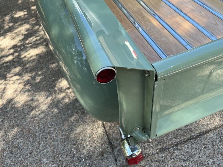

No bumper in back so I need to make sure those cell-phone impaired drivers see my brake lights. Install some LED lights in the bed rolls.

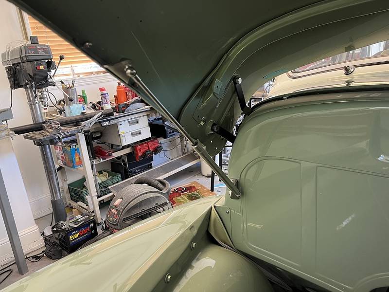

Bought these gas hood struts and installed them. It was only going to be a matter of time unit my elbow caught the prop rod and the hood came down on my head, so I thought I'd head it off..
SWEET ! .

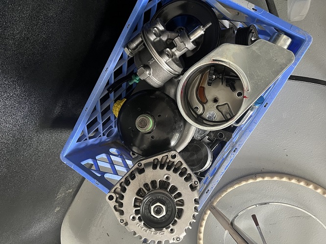

I've pretty much fired the parts cannon at this motor, and so far, no love. Here's everything I've replaced (with all new, not rebuilt, GM parts) .
  • Alternator
  • Power steering pump
  • Power steering pump pulley
  • Water pump
  • Idler
  • Tensioner
  • Continental serpentine belt
  • Rebuilt the Hydroboost and verified all my connections and hoses
I now have a pretty good supply of spares...........

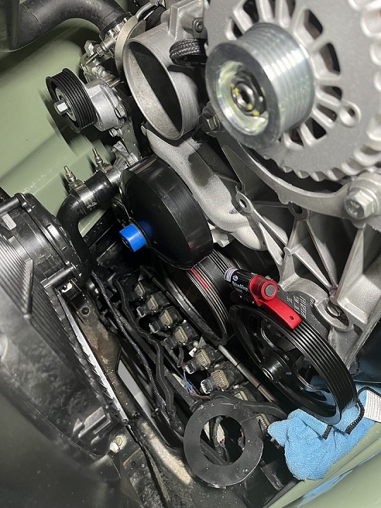

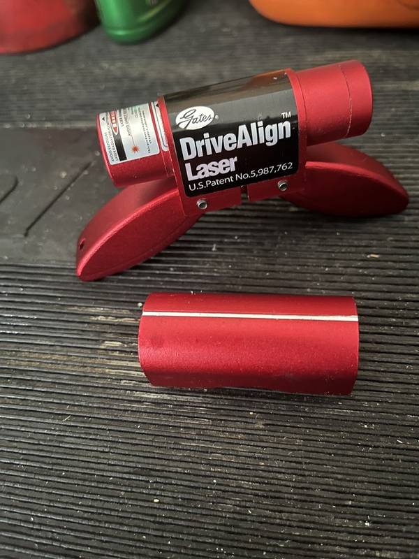

It seems that belt misalignment is the leading cause of squeal on serpentine drives - so says the guys that sell the alignment tool - go figure. But I bought one anyway. You know its good cuz its got a laser!
Sure enough, the damper pulley was slightly misaligned with the power steering pump pulley -about 0.050" I'd say. Pushed the power steering pulley a little further onto the shaft. Here it is - the laser in action-
This was my last hope! No bueno. I now have a $100 cat toy.
