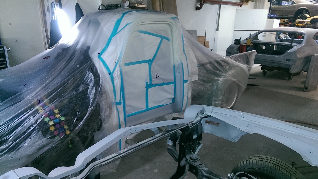

    More progress. Removed the bed and slid the cab back to paint the firewall
    Here it is with the final clear coat. The new Iwata gun lays down the paint with no visible orange peel. All I'll have to do is sand a few dust nibs and polish

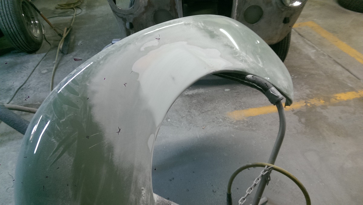

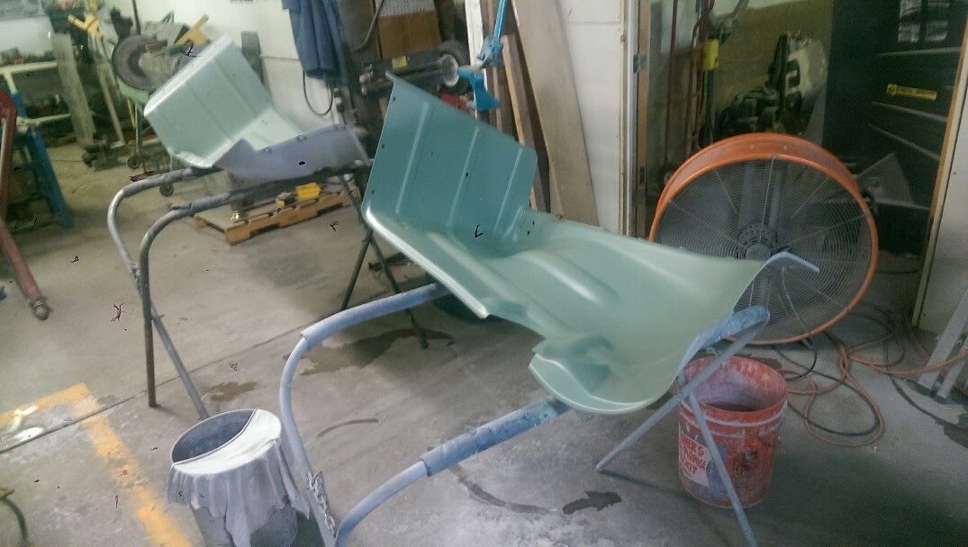

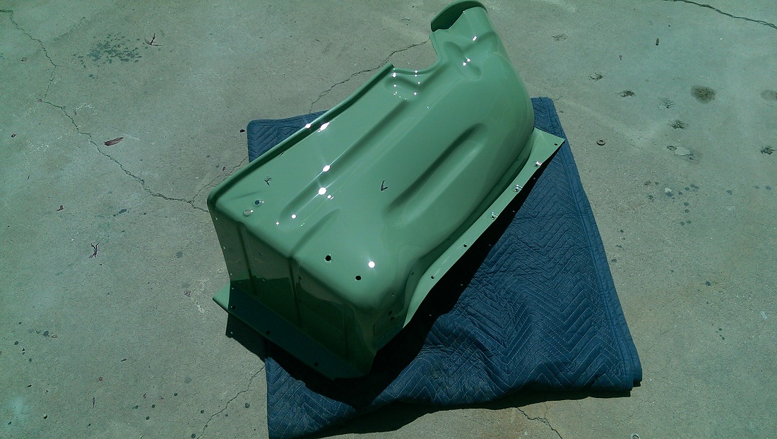

    The inner fenders will be shop painted too. These are the repo parts modified to clear the headers I made
    These were clear coated last night (this is just the basecoat) and we'll turn them over today and paint the other side. Hopefully will get the undersides of the front fenders done and the hood inside done today. Aiming to get the shop painting done so it is ready to reassemble and go to the booth in the next couple of weeks

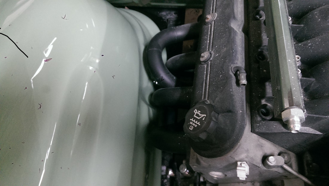

    Phil, you have been scaring the heck out of me... it looks like you have GIANT bugs in the paint... but I realized you had the SAME bugs in every picture. So it's just stuff on the camera lens! (wow, do I feel better already!)
  4. e015475
    I spend all my money on booze and hotrods so my cell phones come from the ones my kids don't want anymore. My good iPhone had to be turned in when I retired. Someone on another forum called those things "artifacts", which I think is what you call them when you don't know what they are! I"ll post some really good photos when the paints done

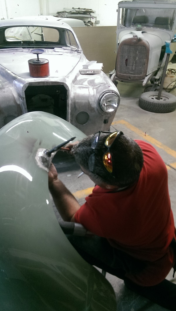

    Little more progress on the '49. Painted the inside of the fenders and the other side of the inner fenders and color sanded then cut and buffed them. Will ,be able to put the fenders on the truck next week - one step closer to getting in the paint booth. Took this picture outside hoping to catch the true color. It isn't so great for color from my phone. Wyatt gave me the drill on how to color sand, cut with rubbing compound and then polish. Very gratifying to bring finish up to the final level.

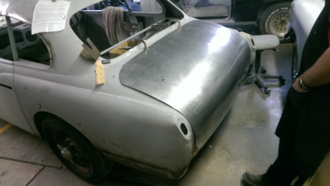

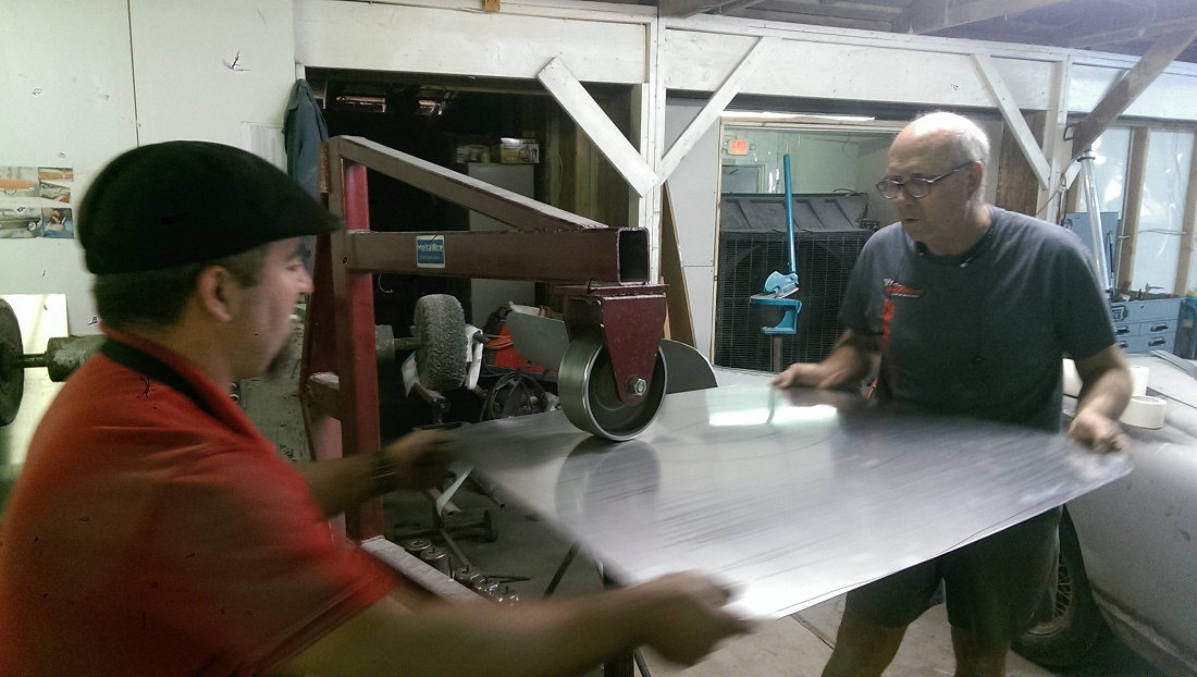

    Enjoying learning new things at Wyatt's shop. Provided some labor (my natural eye to hand coordination isn't anything to write home about) to help make a deck lid for a MG Arnolt in his shop - the deck lid is a little unwieldy for one person to run thru the English wheel. That's me looking perplexed on the right. Took a good eight hours and two annealings to get the crowns in the panel correct. Amazing how much touch labor goes into metal forming.
    Here's the final result almost ready to trim then skin the deck lid frames (its about six inches oversize in this pic)- you can still see some of the wheel marks in this foto but some final wheeling at low pressure will produce a mirror-like finish in the aluminum.

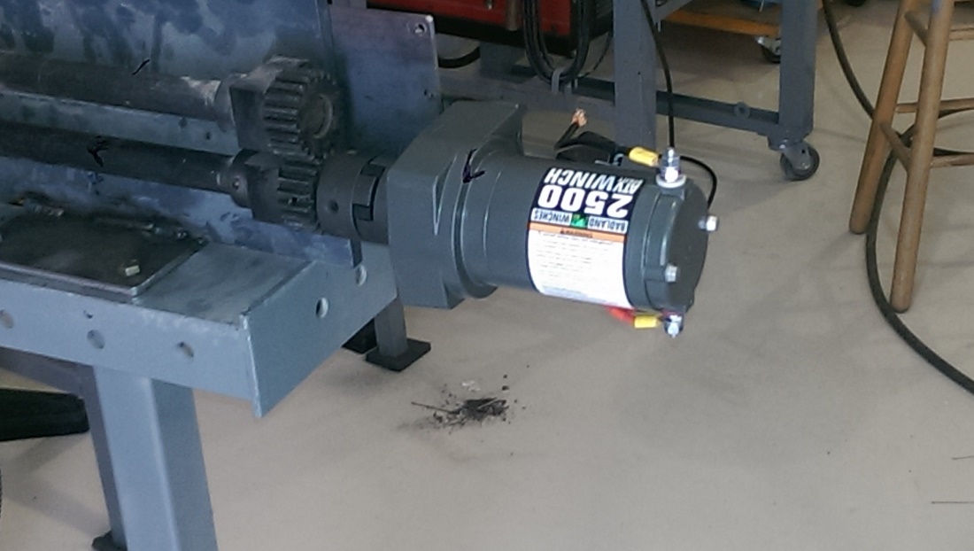

    Wanting to make some aluminum door panels to replace the cardboard ones on the '49 GMC and would like to get them done before paint so if I mark or scratch the door fitting them its no bid deal. I'd like to use a bead roller to add some detail to the door panels, so I picked up a HF winch motor a couple of weeks ago and mounted it to my bead roller so i can do this at home. Wanting to make a nice filler panel for the front bumper too. Here's what I came up with. Will post pics of the panels as soon as I can make something presentable-
    There's a thread on the Garage Journal with more details if anybody's interested.
    Another HF Motorized Bead Roller - The Garage Journal Board

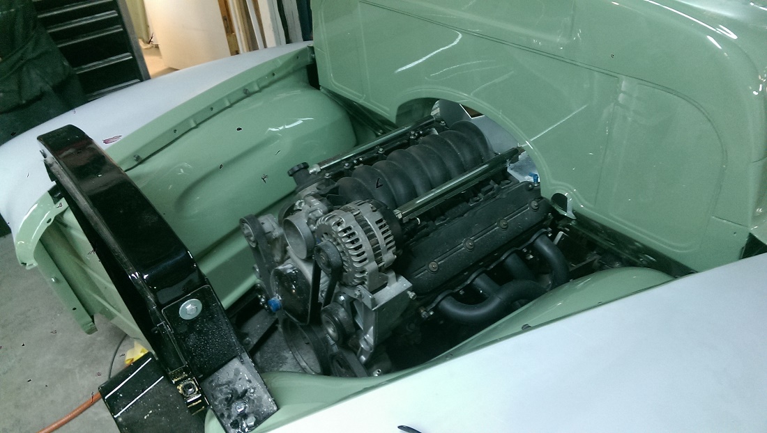

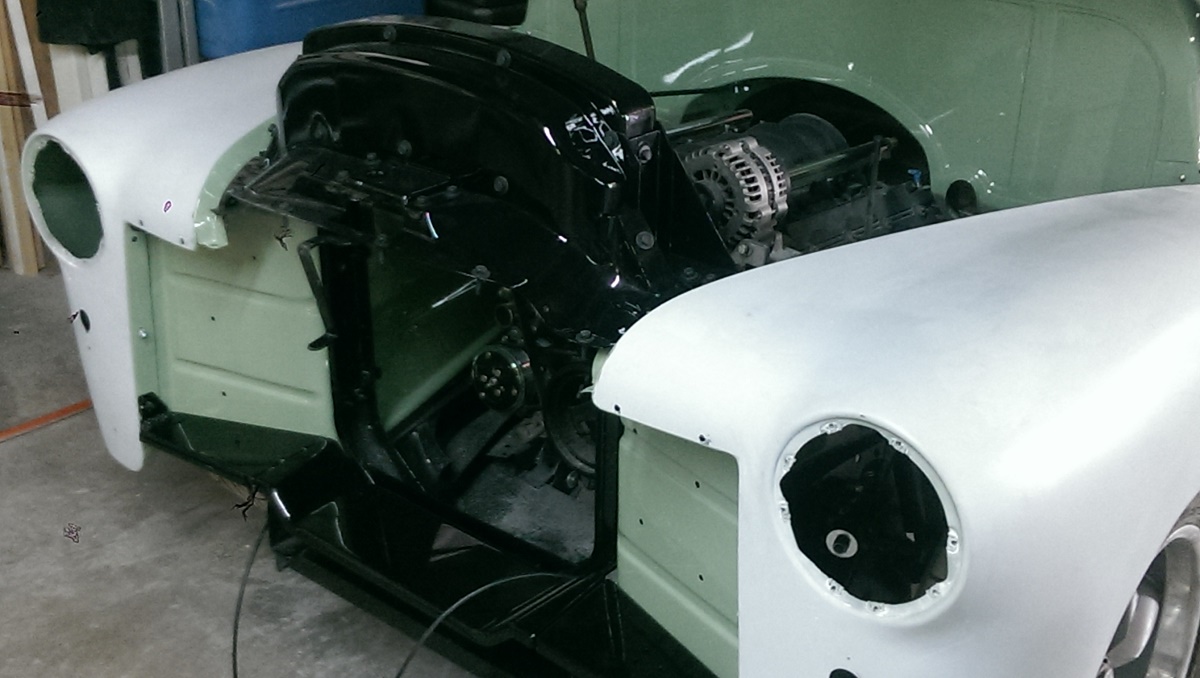

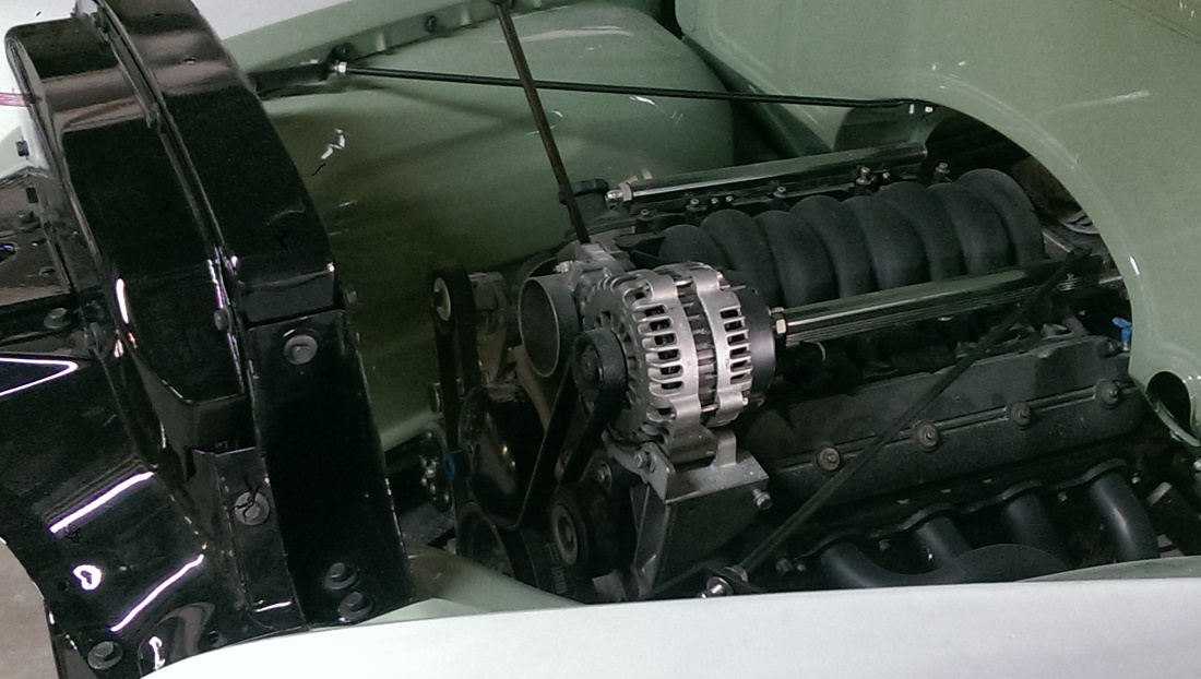

    A bit of progress to report. Finished the cut and buff of the inner fenders and assembled them to the fenders and installed them on the truck- Waiting for my SEM bolts to arrive to put it all together
    There's some pretty subtle modifications to the inner fender wells to accommodate the headers- Should have at least 1" clearance to the headers. Was made in the same contour as the other details on the sheet metal.

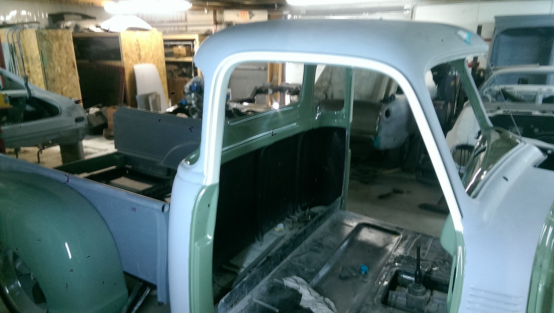

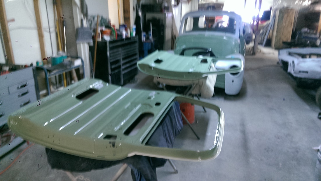

    Taped up the door jambs and painted them - bottom sage green and above the belt-line is white-
    Jambs painted out-
    Doors done too, and color sand starts Monday - sorry, was a little shaky for this photo
    Door closeout looks pretty straight

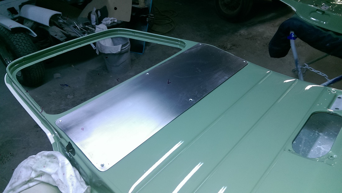

    Made this door card out of 5052 aluminum. Will bead roll some details into this at home.

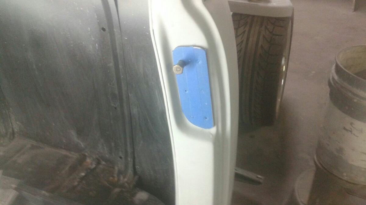

    Here's the door side back when it was first fab'd. I didn't use the Altman kit and modified a stock door lever to actuate and Autoloc bearclaw. The linkage goes around the window glass - sounds a little complicated, but I mocked it all up before painting and the action was very smooth
    Here's the post for the bearclaw on the b-pillar side-
    It was recommended that I add a little reinforcement to this over concern that the post might rip out of the pillar easily in an accident. So I made some backing plates out of some stainless plate and put a brushed finish on them - here it is with some masking tape to protect the face -
    The linkage is a bell crank, two rods and some miniature (10-32) heim joints - will post details when I build the doors out after painting

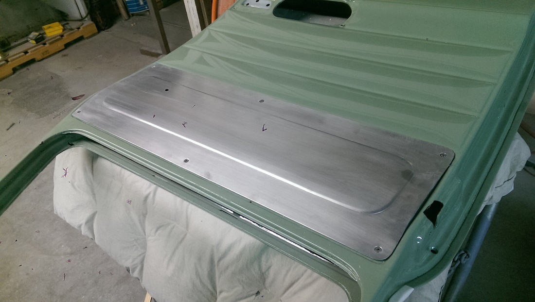

    a little more progress on developing some door panels using the bead roller - these were a little better, but still can't clear the window crank boss on the door with raised panel. Going to the metal store Monday for some more aluminum to try a deeper raised panel set of dies. Raising the panel with the bead roller moved the holes I drilled to mount it closer together (duh?) so I'll match drill them after I bead roll next time.
    Another view-
    The new panel laid in the aperture pretty well before I ran it through the bead roller so I'm going to have to experiment a little by bending it less next time. Ordered a new hole transfer tool for the 10-24 screws and a 82 degree countersink cutter to see if I can get the screw holes a little more precise.

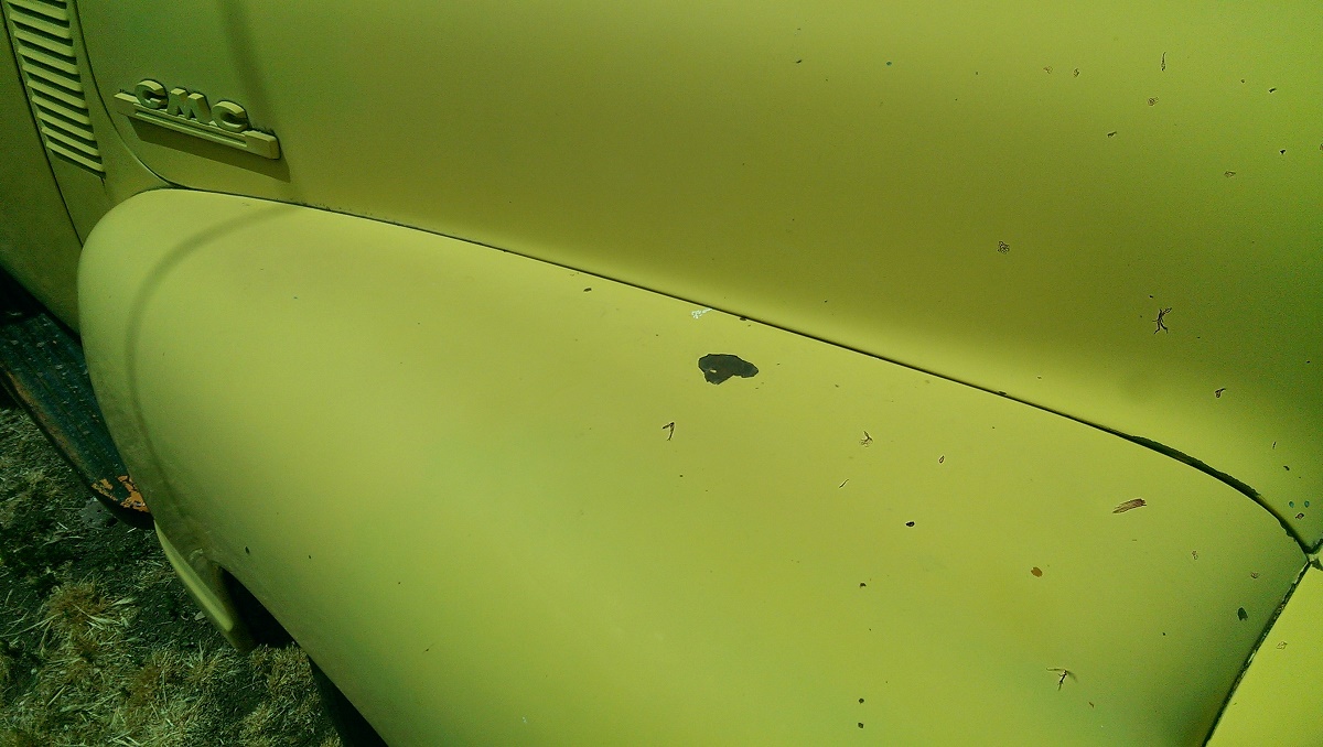

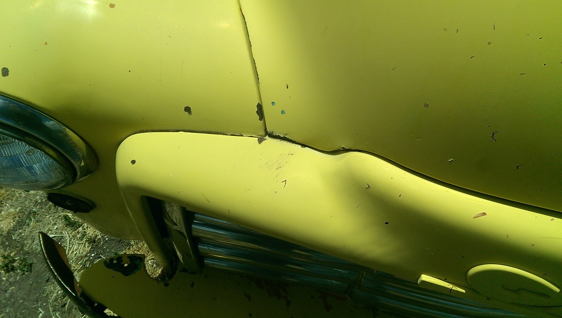

    We poked around Springerville one afternoon, and outside an antique store my wife wanted to visit was a '51 or '52 GMC that looked to be pretty original, so I took a few photos. This is picture of the hood to fender fit - I aspire to get mine to fit as nice.
    And another where the grill surround, hood and fender all come together[​IMG]

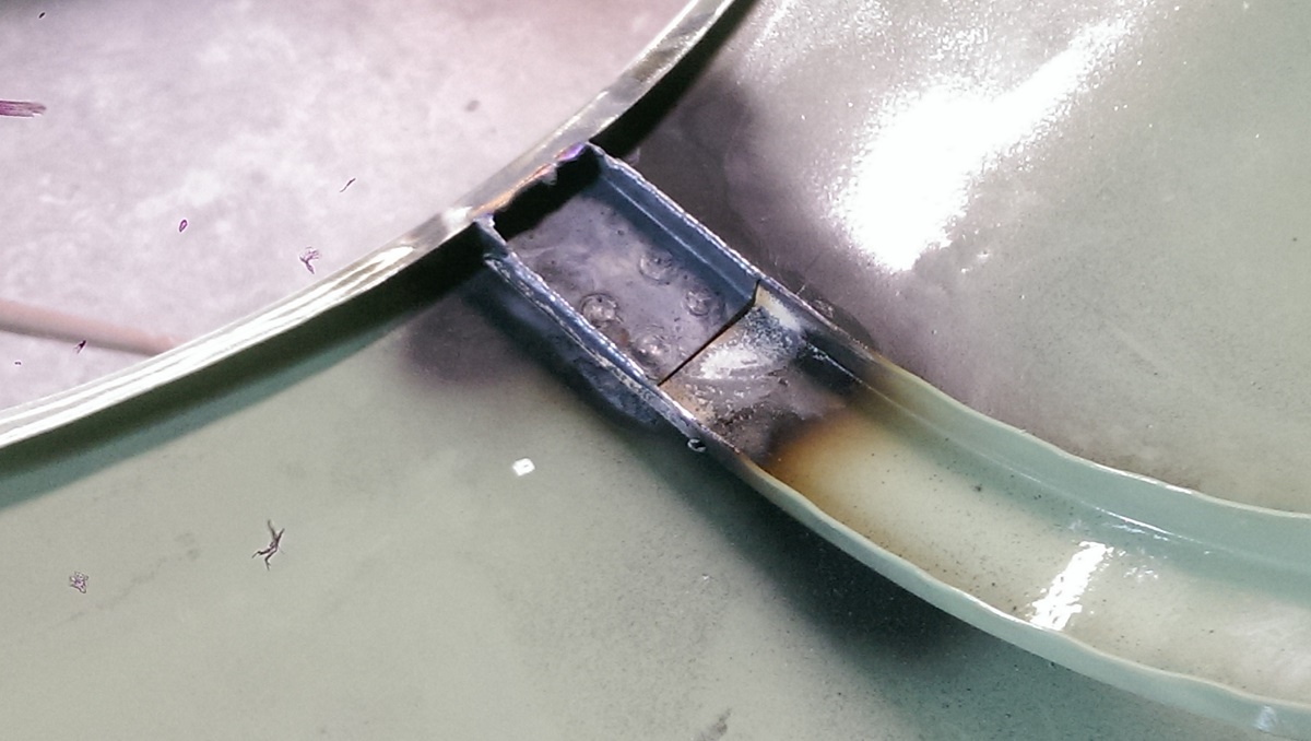

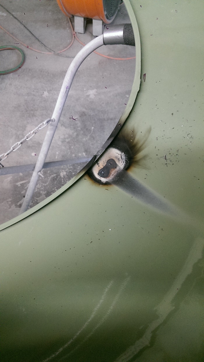

    I'd kept the brace and rivets in the rear fenders but on painted trucks I often see them cracking the paint around the rivet. We have to repaint the rear fenders anyway, so I asked Wyatt to drill them out and fill the holes. Here's the inner brace removed and the holes gas-welded shut.
    Wyatt ground the welds then planished them a little
    The inner brace was reinstalled by extending it and welding it to the fender lip to minimize the potential for cracking. The plug welds just hold the extension on the brace and a peanut weld at the edge of the lip connects the brace to the fender.
    A skim coat of filler, sanding and the fender is ready for primer.

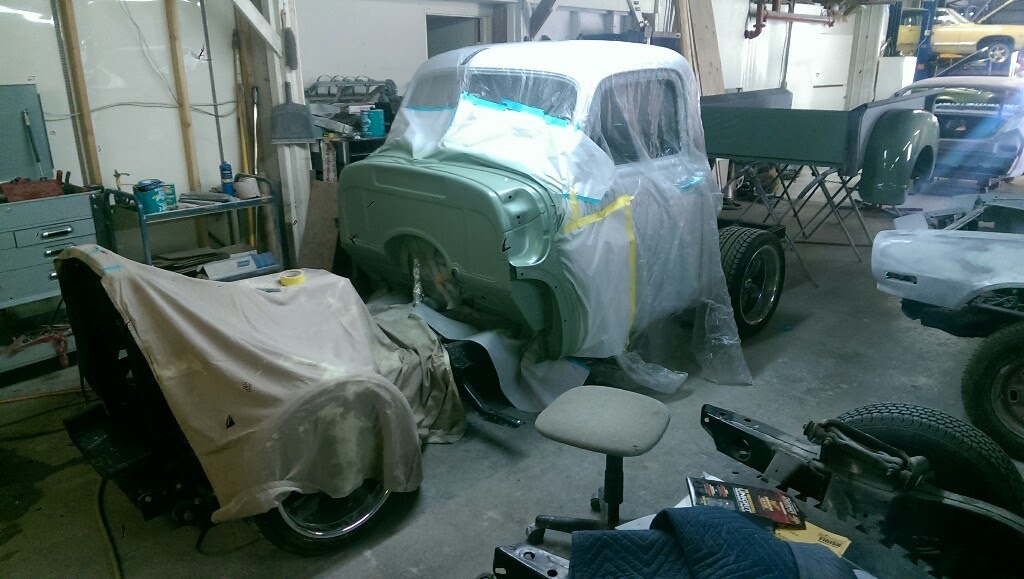

    Final blocking of the bed starts next week, but it should go pretty quick since it is new MarK sheet metal. Anticipating two days in the paint booth - one for the cab and front end, and another for the bed and rear fenders.
