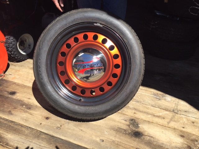

    Modern Dodge Ram pickups have 20", 5-lug steel spare wheels. Not sure of bolt circle, hub diameter, or offset as it pertains to your application though. They look >exactly< like this (albeit 6-lug, sans hubcap-clips) 20" steel wheel.
    Zig likes this.
  7. Zig
    4,816
    When-oh-when will we ever see your truck surrounding that wheel... #wink#
