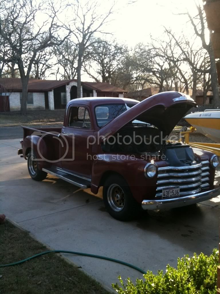

    Cody, I think I have a simple solution for you. The bumper on the back of your truck appear to have too much curve in it and the bumper on the front of your truck does not appear to have enough curve. I think that it has the front bumper on the rear and the rear bumper on the front. I'll bet if you switched them around, you'd have enough clearance for the license plate.
    Look at the curve of the front bumper on mine and look at how much flatter the back bumper is.

    Tried to rearrange the new brackets and license plate, but still no room.
    Hope I can get to messing with the bumpers and brackets today to see if I have the same issue as you.
    New project- I backed the truck out yesterday and when I got out, I had a trail of Transmission fluid from garage. Well, a hose was cracked on the Transmission cooler so, going to go ahead and replace those hoses and cooler. Since putting the 350 in the truck, they moved the cooler and mounted it on the right fender under hood. Pic to come. Where would it be located if everything was original?
    Thanks for the heads-up.

    I would relocate the cooler you have to the inside of a trash can :eek: and go with a smaller cooler on the front side of the radiator. For 1 the cooler is way over kill and 2 you can't get any real air flow if it's mounted to a surface that doesn't allow the air to flow through it. I was just kidding with the trash can remark, I would take it to the scrap yard instead cause it has copper in it. Go to Summit on line they have Trans. coolers for about 35 bucks.....Big Tim

    Well, between the grille and radiator, there is a fan (don't know the proper name of it)and also don't know if it works, would it go in there mounted somewhere?
    I bought a smaller cooler from Autozone yesterday so before I have to drill new holes, I probably need to research about putting it down by radiator.

    I had also thought about mounting mine behind the grille, in front of the passenger wheelwell, cutting out a rectangle behind it for the air flow. Put a piece of small weave square hardware cloth behind it to fend off rocks, maybe a small fan for slow speed cruising.

    You may have 2 front bumpers, also.

    Sounds like you have the fan pushing air through the radiator. They are more efficient if they are pulling air through the radiator. Soooo if you mount the fan on the engine side of the radiator and reverse the fan direction then you can mount the Trans. cooler on the front side of the radiator. Since you are running a v8 you should be able to do this with no problem. Here's a pix of my 61 with a electric fan. 001.jpg ........... Big Tim :cool:

    After looking at your original pix it looks like you already have a fan on the engine so all you really need is some kind of fan shroud to help the fan pull the air through the radiator. Then you can get rid of the electric fan. Somebody probably put it on because the one on the engine wasn't pulling enough air but a shroud will help just make sure the fan only go's in to the shroud about 3/4 of the way, That's what works the best.

    That cooler is doing nothing but heating up the trans fluid with engine heat. Gotta love the previous owner's genius ideas.
