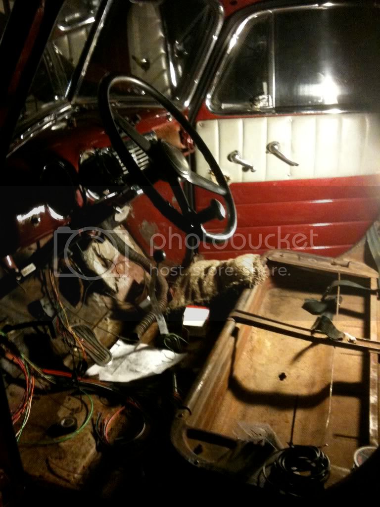

Well, I gutted most of my cab so I can install the following.. Wiring Harness, new stereo, glove box, recondition bench, prime, and put Jute down on floor...
70% done with wiring. Just need to buy the gauges and finish wiring the inside. Today was a long day, working on it from 8am-5pm... Sometimes it's good when the family is away...

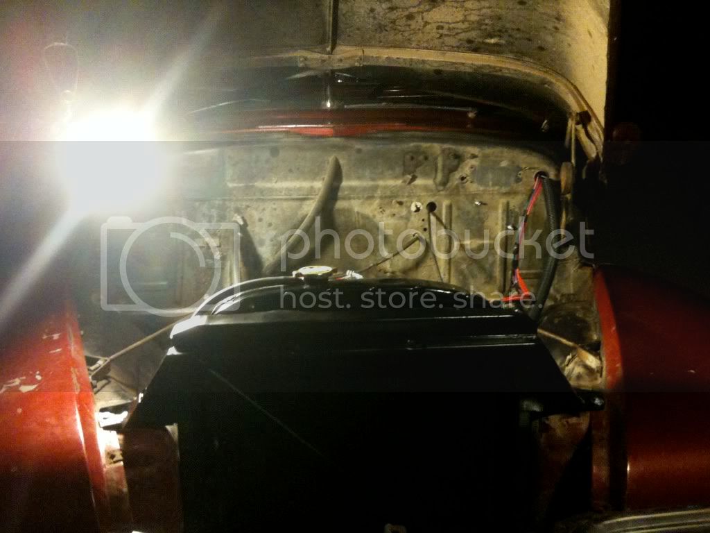

Wiring harness is good to go, Transmission cooler is mounted. Everything was moving on strong until I drove it around the block. I came back and when I turned it off, it seemed like it never wanted to cut off. Once it did, It took me a little bit but finally started back up but sounded like it was flooded. More light blue smoke was coming out of tail pipes and then some light black smoke. Was thinking about the oil and also maybe could be my old carburetor not being adjusted... hmmm
Next priority: BRAKES!!! I bought a new seal and master cylinder cap. I could see everytime I pushed on brakes, it squirted from the cap just a little...

Sounds like a couple of things could have made your truck diesel when you tried to shut it off. 1 your idle could have been set too fast or 2 your timing could be a little fast. The black smoke is gas and the blue is oil. If it does it again turn the key back on then try to shut it off in gear. I hope this helps Big Tim :cool:

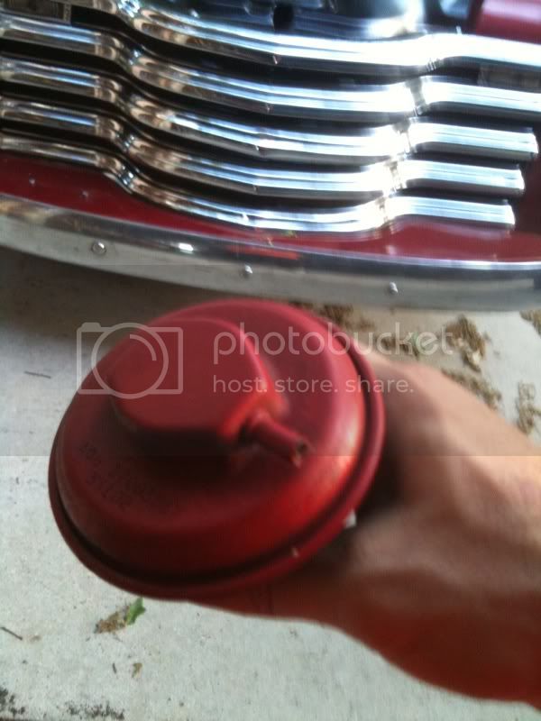

Good evening. Some help please.. I am putting on an Edelbrock 600 and for some reason, this ? is in the way. Can anyone tell me what this is and what I can do to solve this problem. Thanks. 1st pic is where it is located.

Figured it out
Took some time and research and figured it all out. Since I don't use the EGR Valve, I just put a small plate over it and continued my business with the carburetor. Things are getting done and loving it.
