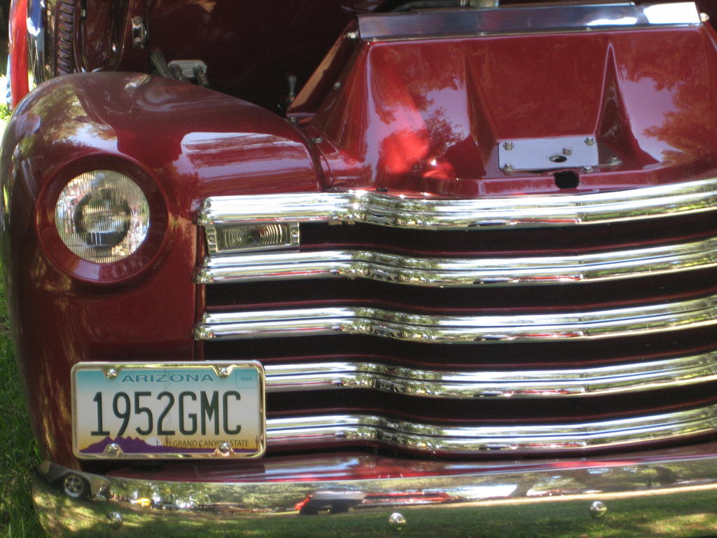

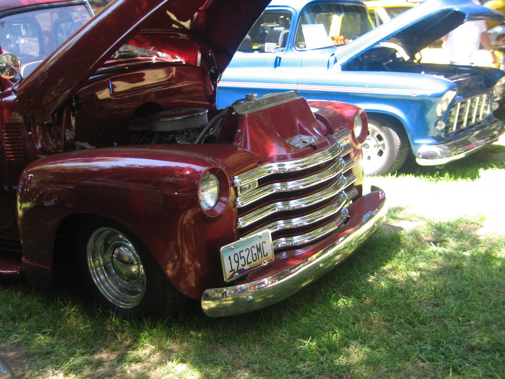

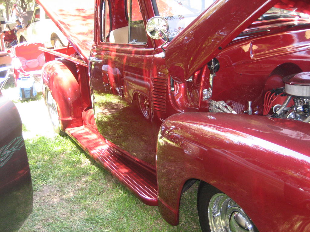

    I'll post some photos of one of the best looking 52 GMC I have ever seen for the AD design years. It sat at the Brothers Truck Show last year just behind me under the trees. As far as changing the front end you may want to get a hold of Joe at DeadZoneTruckin here on the board and see if he has what you need and may know the tricks on getting it done.

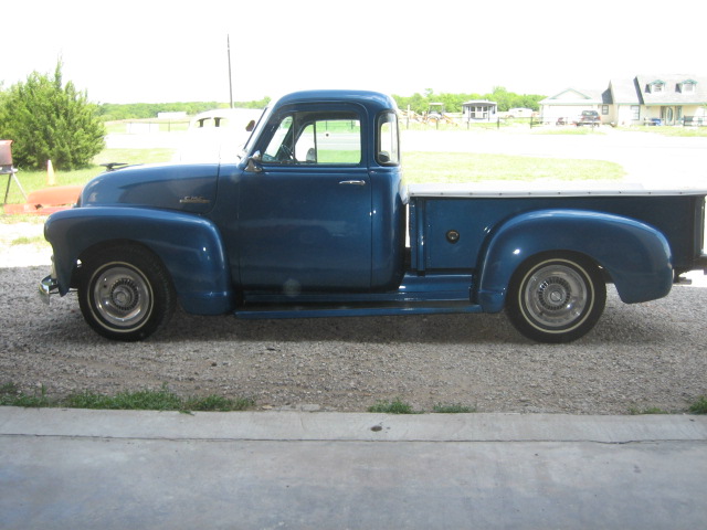

    In the 1970's I had 36 AD trucks split exactly even with 18 5W and 18 3W. There was only ONE GMC, a 51, and that's what the man wanted. Here it is back for a little PM (a/c, headlight bulb) nearly 40 years and over 200 thousand miles later and it still looks pretty good I think, grill and all. Has shortened and narrowed 74 Cad DeVille chassis, with every option the Cad came with. Wore out the 472 engine and replaced with a 500. Interior replaced twice.

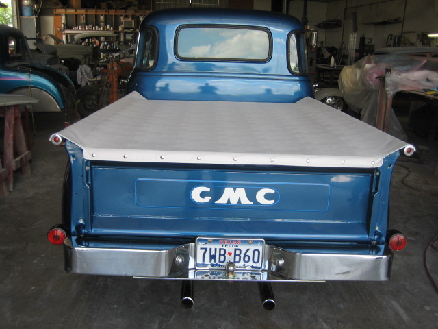

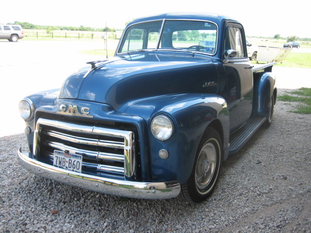

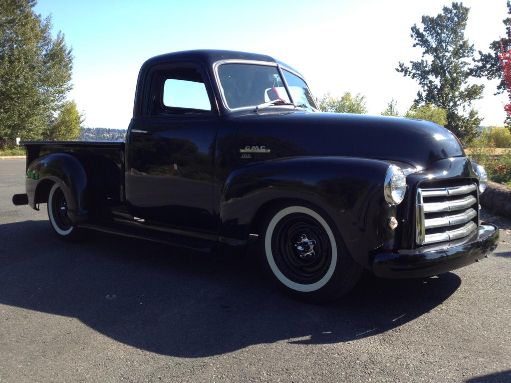

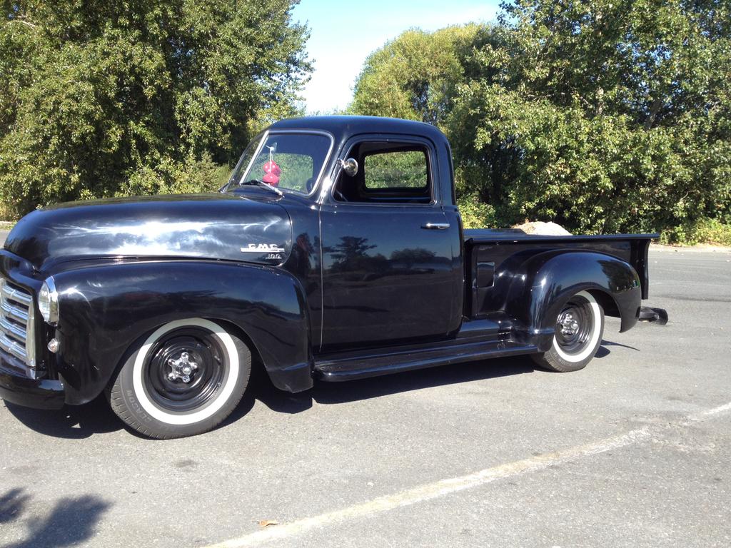

    Here are some pics of it.
  16. ccharr
    Thanks for posting the photos of it, a daily driver till you get a 53 you really want.
