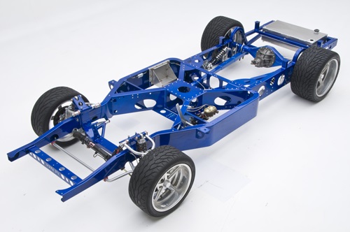

    X frames vs. ladder frames. For the 60-66 C-10 pickup trucks GM changed from "X frames" to "ladder frames" in 1963. An X frame has better torsional resistance compared to the "ladder" style frames.
    But X frames also increase complexity for the assembly line folks. Bottom line is the ladder frames are "good enough" for a street driven pick-up truck.
    But if you're building an autocross vehicle a tall frame with x members makes for a super stiff foundation. The blue "Big 10" frame above by No Limit was designed for a purpose built autocross truck. They want it as stiff as possible to keep the tires planted on the pavement.

    Ok, John, I get it. If someone wanted to, they could add a triangular gusset forward of the four-bar crossmember, both sides. This would help for the guy who really wants to "wring-out" his truck and possibly himself.
    Now to put you on the spot, who do you think builds the best designed aftermarket frame? For autocrossing?
    I like EVERYTHING about Art Morrrison except the price. There is so many, Fat Man, Roadster Shop, TCI, The one you pictured above. My desire is to build my old truck to give a modern SS Camaro or GT mustang a run for their money.
    Don't know if I can get that done with the original frame modified. Seems to me, I'm going to need the super-low sway-bar equipped roller frame.
    Don't know if I completely believe Morrisons claim of Corvette agility, but they have proven results with tri-five Chevy cars.
    The thing is, modern Mustangs and Camaros have positive down pressure with aerodynamics that I won't ever get with a big-fat round fendered truck.
    Then...there's always the budget problem, but by time you buy a fat-man frontend, engineer a Thor Bros 4-bar rear, a currie 9" rear with posi, sandblast old frame, brakes, etc., a guy needs to calculate.
    Oh, I still like panhard bars better.

    I too like Art Morrison, but if I was building a true autocross truck and was willing to blow that much cash I'd go with No Limit: http://nolimitengineering.com/products#!/~/product/category=6157546&id=26244622
    It's almost a shame to put a body on it... it's a work of art. You couldn't build it yourself for what they sell it for.. at least I couldn't.
