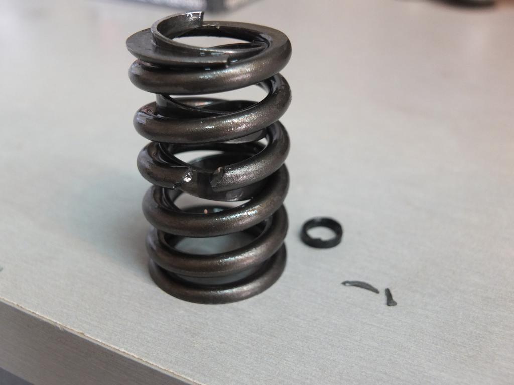

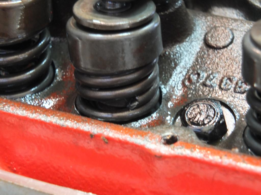

    The 350 SBC in my ole Hot Rod Model A broke a #4 intake valve spring. I replaced it today and was pleased to discover that the valve wasn't bent.
    Cam:
    Intake: 488 lift, 234 duration
    Exhaust: 510 lift, 244 duration​
    10.25 : 1 Compression
    Any engine guru's here? Wondering if I was just lucky that it didn't bend a valve, or is this S.O.P.?
