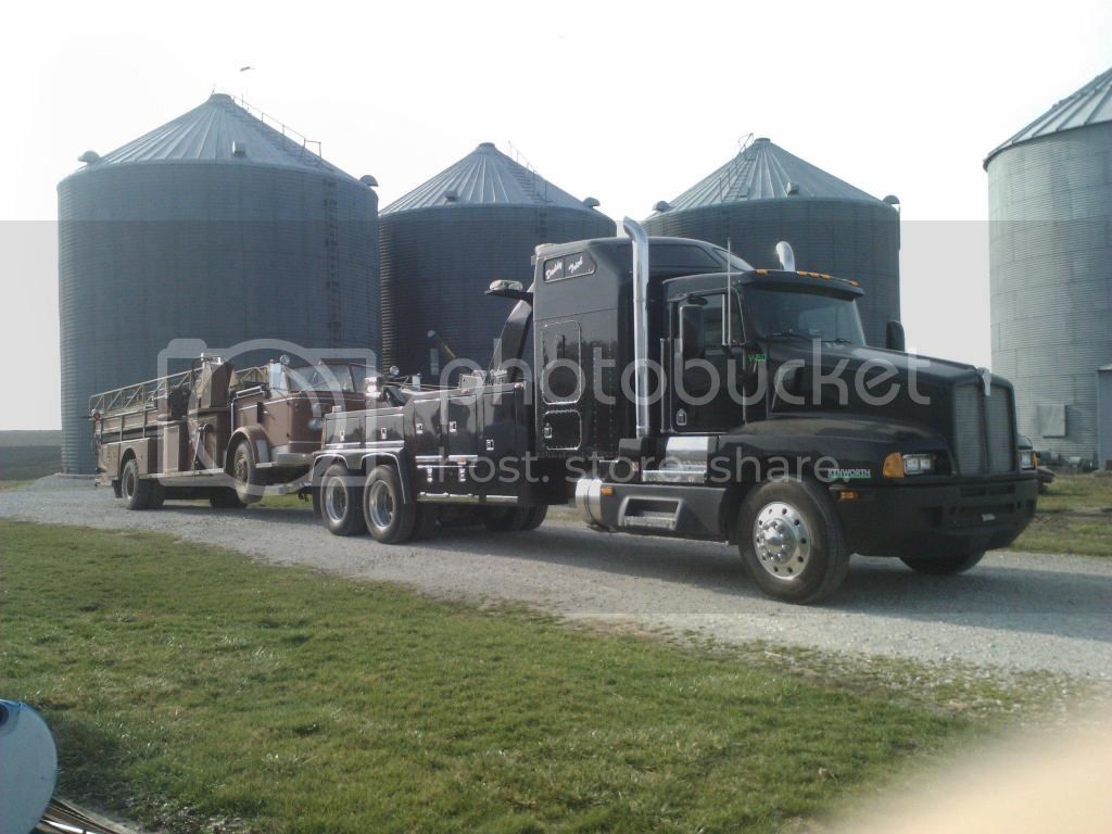

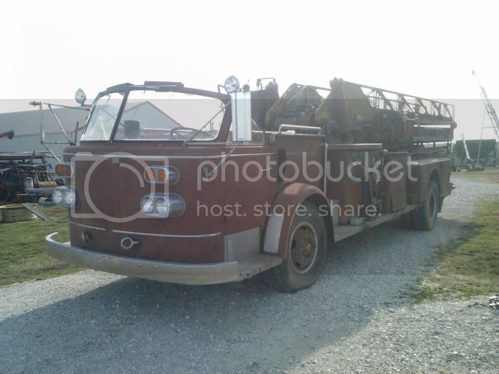

    Now that the 'new' parts truck (for the fire truck project) is home, I'm going to focus on getting back to work on the Chevy. Thought you guys might enjoy a couple of photos of it.
    The first shot was taken after I'd moved the truck to a more suitable location for getting it hooked up to my buddy's big Kenworth tow truck. I got the engine running (with the help of the current owner's son), but the brakes are shot so I couldn't drive it home.
    The second shot is after we got 'er hooked up and ready to haul home... about a 20 mile trip. We stopped for lunch at a local restaurant and had a few folks ask about it. This aerial truck is nearly 50' long, but it looks like a toy next to my buddy's rig.
    Hoping to get the brakes on this one working so I can at least drive it around and have a little fun. The ladder supposedly works too, so I'll be sure to test that out soon as well. :D

    Whew ! unless it's rusty that looks to be in VGC to me .

    It's a great 50' rig. Seeing it up close is another story. The upholstery (if you can call it that in a fire truck) is shot, the bottoms of most of the equipment compartments are rusted through, and the driver's side front fender is held on by the two bolts that go forwards-backwards into the running boards... the lip on the fender and the sheet metal on the cab are gone. Other than that, she's a beaut, Clark!
    What kinds of old stuff are you looking for, Nate? I have a garage full of what most folks would call junk. Ok, some of it's junk to me too, I just have a hard time getting rid of anything. :D Let me know what you're looking for, chances are I'll have something laying around.
    I was able to get the hydraulics on this truck engaged tonight, but something is causing the engine to go in and out of high idle by itself. This is normally controlled with a switch at the control pedestal for the ladder controls. I WD-40'd everything I could find... switches, solenoids, etc. relating to the hydraulics and the throttle controls, but still no relief yet. It's gonna take another set of hands (and legs) to work the PTO controls in the cab while I check out all of the bits under the doghouse to see which cable/rod/solenoid/etc. is running the engine up and down.
