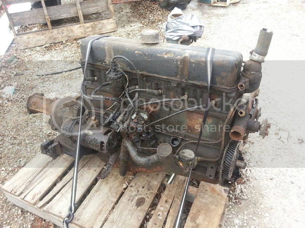

    Found a great deal on Craig's List. I just picked up an old Chevy inline-six mated up to a three-speed transmission. It has a stock intake manifold, a carburetor, a stock exhaust manifold, and the timing plate/front motor mount that I need to finish my engine. All I had to do was trade away the spare short bed box I had on hand. Score! Time to get back to work.
    Here are a couple photos.

  4. vwnate1
    11,703
    Sweet !
    Does it turn ? .
    I see it came with a Delcotron alternator and bracket , that's $75 right there .
    If it turns , get busy cleaning the dirt out of that open timing chest right away , then either stand it up or put on a really sturdy engine stand and begin to wake up process , soon it'll roar back to life then you can clean & pant it , dress how you like then install and begin selling off the left over pieces for fun and profit...
    Sigh ~ this is the part I like most and I can't do diddly squat right now .

    Nate,
    If I remember the advertisement correctly, the engine ran when it was removed from the truck (the owner is converting to a 350 small block) but it smoked a lot. I wanted the engine for the accessory stuff that my freshly rebuilt engine lacked:
    Various brackets
    The timing plate/front motor mount (my oiler was missing)
    Stock intake manifold
    Stock exhaust manifold
    Carburetor
    Etc.
    Not sure which way I'll go as far as the charging system just yet, but I know I'll go 12 Volt, so this alternator will do just fine for now (as long as it works). I will also be adding power steering and will need the short water pump for the 235.
    It feels good to be working on the truck again. Can't wait to get what I need off of this engine and get it on the project engine.
    Thanks for the tips, Nate. For now, you'll have to be content "wrenching" with a keyboard helping us out on the forums. Believe me, I'll be putting you to "work" plenty as I get my power plant back together.
