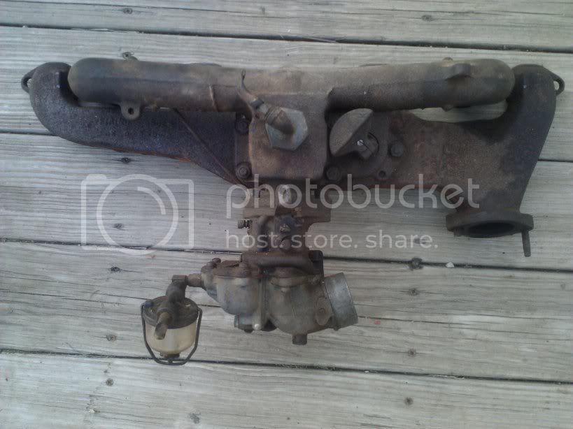

This was on the first 235 I bought to rebuild. The rear cam bearing bore was 0.003 too large and out of round, so the block was junk. However, I kept and reused the crank and head, as they were fine. I was told this was on a "Thriftmaster Special Six" from 1962. However, when I did a little digging, the block was only a '57, and the head a '61. So somewhere along the line, some parts swapping was done to get that engine together. I viewed a video of the engine running online (I can send the link if it's still active), so I bought the motor. I got a decent deal on the engine... a moderate stack of cash and the front clip from the '50 half ton and the Thriftmaster Special Six and an S-10 T-5 manual transmission were mine. I just had to drive 7 hours each way to complete the deal. Not a problem, except for finding out that the block was junk. I'm past it, and I just want to get this intake/exhaust set up into the hands of someone who wants or needs it. I would think that it's worth some decent cash, as it's the first set-up I've seen like this (with the carburetor inverted) in a year's worth of researching these trucks and engines.
Can anyone tell me the proper name of this set-up so I can list it for sale? Any thoughts on what I oughtta put on it for an asking price? I'd also entertain trade offers.

Name part
Thanks man for the complements.
The name of the part is in deed a 1962 intake/exhaust setup with a updraft carb wich looks like the original Rochester carb and fuel glas. Not shore if the carb is complete though ? Attached a link to the HAMB site wich gives some more information about price ! http://www.jalopyjournal.com/forum/showthread.php?t=630416
If in good condition and functional its posseble to ask between 75-125 dollars for both.

Thanks, Martinius... but that is the exact engine I bought. I will probably just try to trade for an intake and/or exhaust manifolds for the 235 I rebuilt.

Cool Parts
That's an updraft carby and manifolding for a Dubble Dutti Van (bread truck) or Cab Over .
Not really common but it might just be the ticket for some restorer or maybe a Rat Rodder who wants something different....
To me , the exhaust manifold is worthless until the broken stud is out of it as it's easy to screw the job up and ruin the manifold if the ear snaps off as you're removing the stud .

I realized it was out of a bread truck or cab over. What I didn't realize... it isn't all that special. :D Point taken about the stud stuck in the manifold. I'll work on removing those tomorrow (may as well take both of them out).

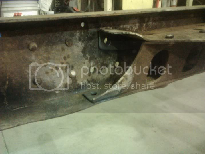

The good news is: I THINK I'm ready to have the truck frame sandblasted. I was able to remove the two troublesome rivets today, as well as getting the cross member bent back into shape so the holes line up with the holes in the frame again. Here's a shot of that:

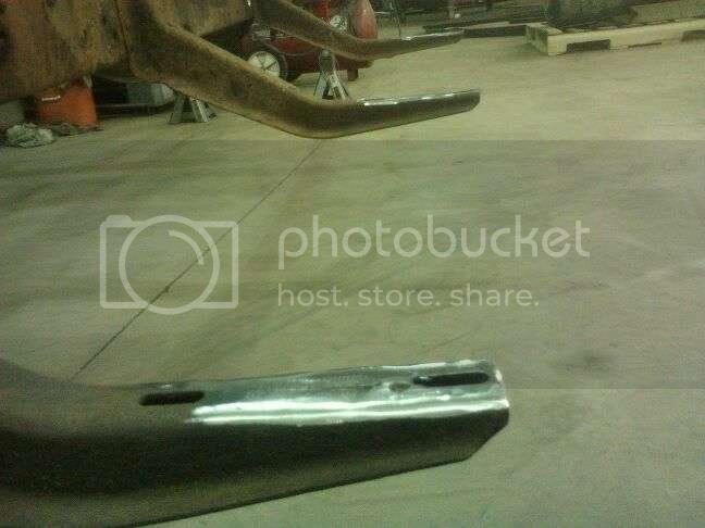

I was also able to flip the frame back over right-side-up, and grind off all of the welding repairs that had been done to the running boards and brackets. Here's a photo of the cleaned-up brackets:

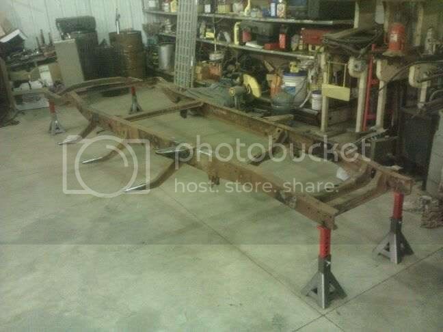

I'm not sure how well this picture will turn out, but here is an overall photo of the frame as it sits right now - minus the axles, leaf springs, rear spring mounts, all four upper shock mounts, engine bay splash guards, battery box and splash guard, transmission cross member, and the emergency brake linkage. Whew. I think that's it. Oh... forgot... I also took off the spare tire carrier, as I'm going to go with a more modern unit. Anyway, here's the picture:

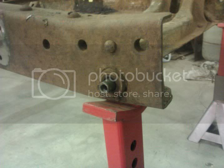

Ok, now for a bit of advice. I'd like to remove and replace all of the leaf spring bushings. How do I remove the very front bushing and bolt? Here's a photo:
All four of the front leaf spring mounts are in good shape, so I'd rather not remove them. Can the two very front bushings be removed without having to remove the mounts from the frame? I'm sure they can... I'm guessing a little heat on the mount, and a few good whacks with a BFH?

*DO* take the time to find a 100 % level bit of cement and measure the frame's height to ground at various different places , most of them are twisted a bit , especially in the front frame horns and this greatly affects handing when you re assemble it .
NOW is the time to cold stretch it back into shape as necessary .
Thanks for the tip, Nate. I noticed a few places with the naked eye that looked like they may be distorted a hair, but in checking (with the naked eye) on the opposite frame rail, both appeared to be the same. I will get a tape measure and a notepad out and go to work on it in the morning when I go off duty.
