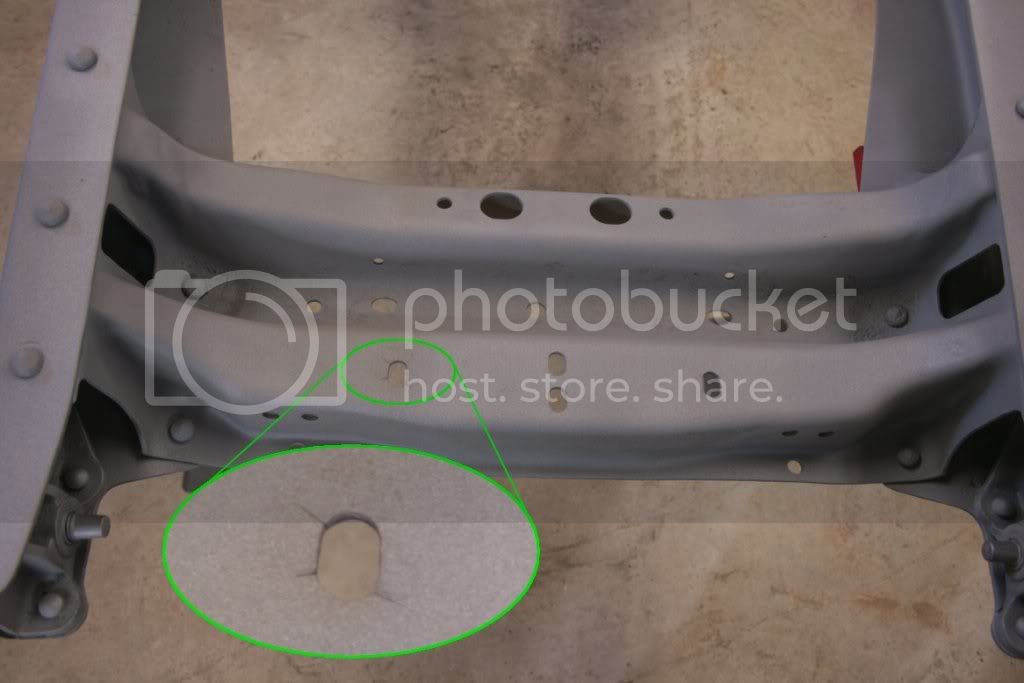

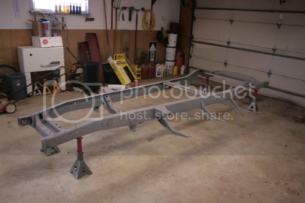

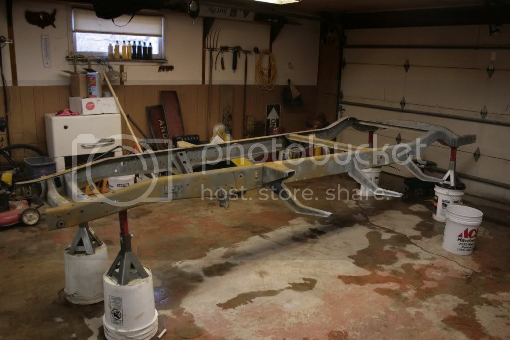

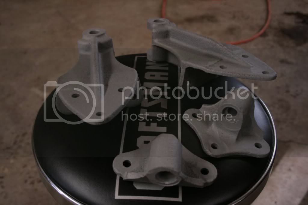

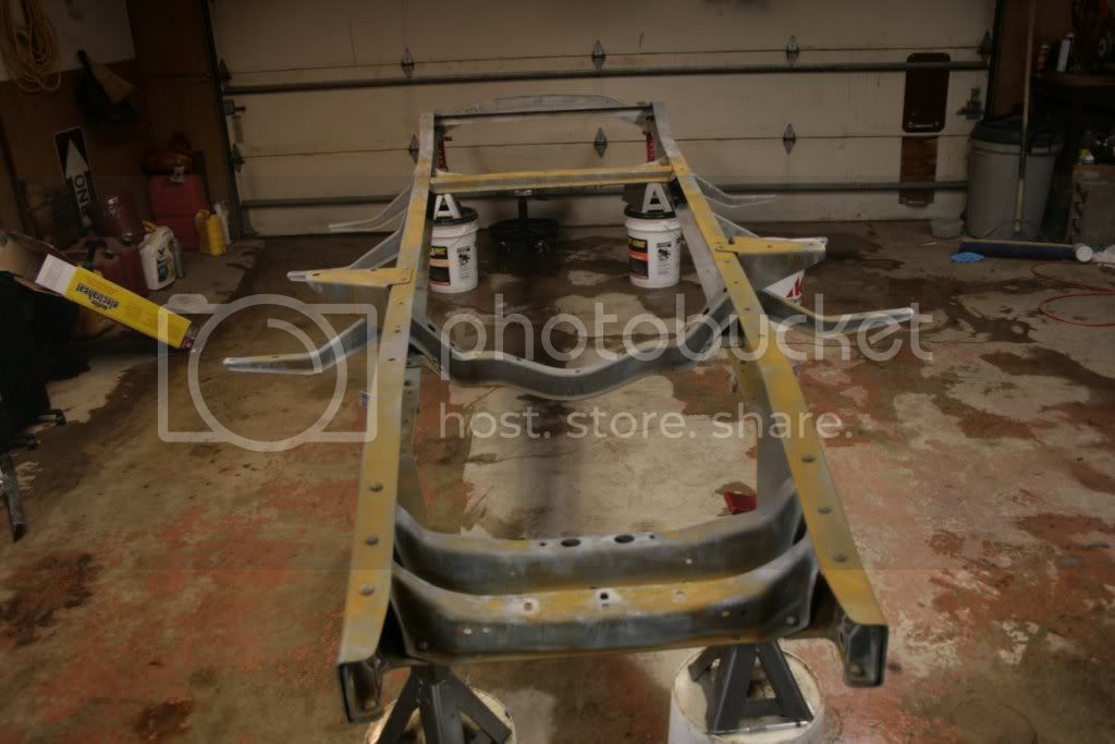

    Ok, here are a few photos before I get started cleaning and painting.
    First one is the set of rear spring mounts Martinius found me on eBay. Thanks again!
    Second is a shot of the frame with the better camera. I'll be using this camera from now on (I hope).
    This is a shot and detail of the front cross member. Before I get to cleaning and painting, I'm probably gonna weld up the cracks coming from the hole on the left. I believe (please correct me if I'm wrong) that the rear holes are for the engine mount and the front holes are for the radiator. Sound right to everyone? Both trucks I've bought for this project were bare up front on this cross member, so I'm guessing here, but it seems logical. Do the holes even need repaired? I'm probably gonna do it anyway, just because...

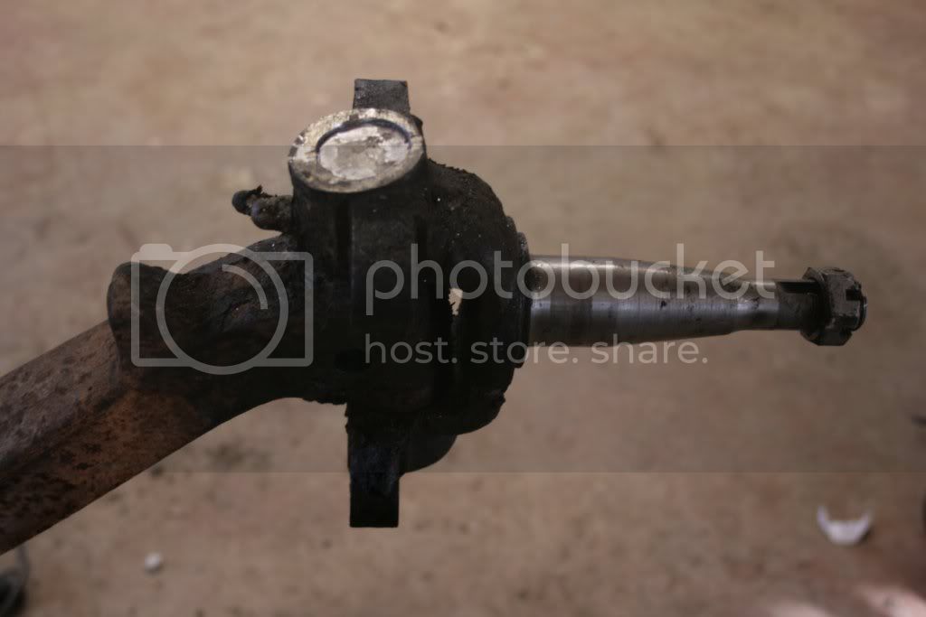

    The last shot is the spindle. You can see the Dremel marks from where I ground off the tabs created by the punch to stake the cap in place. I'm going to go out and drill a hole in the cap and try to pry it out per Elky's instructions.

  5. 1952Bowtie
    1952Bowtie Member
    Feb 1, 2004
    309
    Spokane, WA
    That's nice
    Damon,
    Pretty nice to see a frame in that kinda shape. Just personal preference, but have you thought about powder coating (instead) after fixing all the little stuff? Sure looks great!
  6. Zig
    Whooodiddly! That does look good!
    You're right on the holes out back. Are you just doing the pins because you've gone this far, or do they show wear? Just wondering, because there are so many that put ifs in these, a good axle could be found pretty easily I would think...
    That IS a mighty nice looking frame! (Almost as good as a GMC frame would look!) :rolleyes:

    I'm trying to do this project on a budget (aren't we all), so I opted for KBS Coatings' Rust Seal paint versus the powdercoat. If I didn't short myself on supplies, $180 should take care of the frame, front axle, and rear axle. We'll see how close my estimation skills are gonna be to what is actually needed. :D And thanks for the compliments!

  8. vwnate1
    11,701
    ! Cracks !
    MUST ALWAYS be welded up before painting ! . they'll continue to creep until they ruin your day in the future .
    There's a grub screw in the middle of the axle's eye you'll need to remove before the king pins can be pressed out . (shop manual helps here)
    Once in a while they'll come right out , far more often serious force and swearing is required .
    Remember this : if you batter them with a hammer in your garage , they'll mushroom ever so slightly and be a real bear to get out . I suggest using a hydraulic press from the jump .
    Most heavy duty truck frame shops can re bush them for you very affordably and won't leave it covered in hammer marks......

    Hindsight being 20/20, I should have cleaned/degreased just the spots where I found grease lurking after having the frame sandblasted. Instead, I opted to degrease the entire frame. Boy, did that make a mess of my garage. As did the second prep step for the KBS Coatings paint... the Rust Blast. Both prep steps are now done, and I can paint tomorrow. I found a T-5 five-speed transmission for my truck, which I plan on going to get tomorrow morning. It's a three hour drive one way, so I won't get back until mid-afternoon. Since the directions said to figure on 2-4 hours for each base coat to dry, and the base coats are supposed to cure for 6-12 hours before applying the topcoats, I'm... I'm going to try to paint the two base coats on tomorrow evening/night and wait until the next morning to apply the two top coats of chassis black.
    Thanks for the tips, Nate. Thanks to Elky's directions, I was able to get the dust caps removed. I think I will take the axle to a friend's shop and use a press to remove the old pins. I still haven't purchased a new set yet, so I will focus on finishing up the frame's paint job first. I will also paint the set of rear spring mounts and have them ready. Hope to post more updates tomorrow.

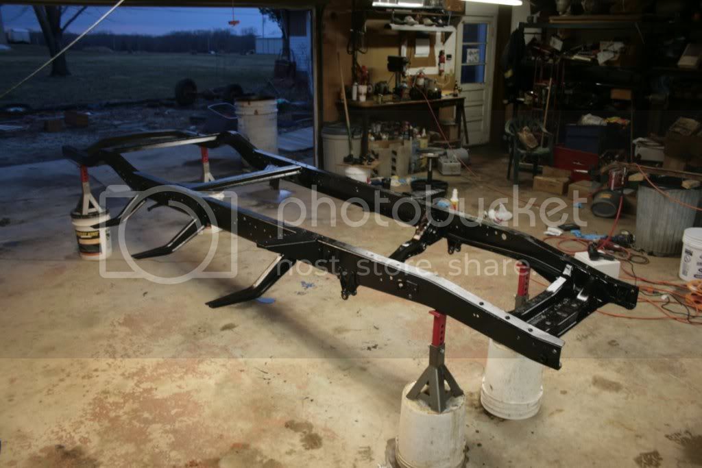

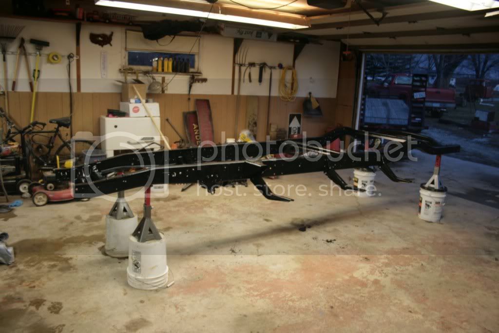

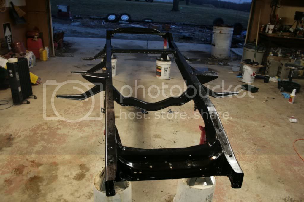

    Well, I must preface this post by asking another favor of you fine folks: if I ever, and I mean EVER say that I wanna brush paint a frame (or any other item, for that matter) again, someone (anyone), pretty please... kick me in the teeth. Ok, I'm done.
    It was an all-day affair, but I finally got the base coat done on the frame. With the help of two good buddies (thanks again Cooper and Rob-o) and some supplies from another good friend (thanks for the brushes, Jim), the frame is now black. I'm going to take a break for an hour or so, then head out to start the top coat. (Per the directions, this stuff isn't supposed to cure for longer than 12 hours, otherwise you have to apply an etching primer before you can top coat, and I ain't about to add another step!!!)
    Here are a couple of photos of the frame after it had been degreased and prepped with the Rust Blast.
    Here are three photos after the base coat of Rust Seal had been applied.
    I think I'm gonna have a cold drink or two while I sit back and look at the frame. It's not quite looking like a truck yet, but hopefully it will soon.
    Damon
  13. vwnate1
    11,701
    Good Looking !
    You done real good here Damon .
    Baby steps , always baby steps or you can get overwhelmed .

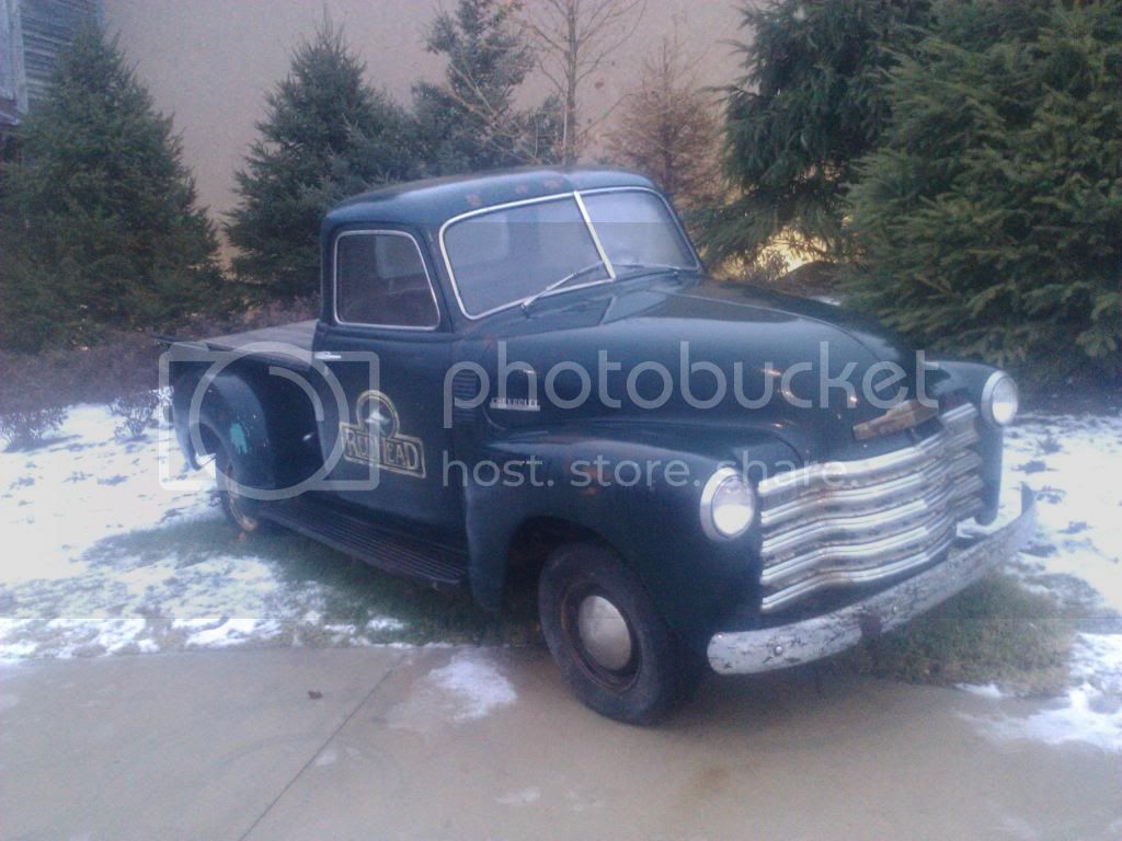

    I forgot to post this picture. I went to visit some relatives toward the end of January, and saw this pick-up as part of an advertisement for Red Head clothing at the local Bass Pro Shop. Seems as though our beloved AD trucks went from advertisements from one clothing company to the next. Too bad this one (as well as others, I'm sure...) are being displayed out in the weather. Has anyone else seen this before?

  18. Root2812
    Root2812 Member
    Oct 19, 2011
    195
    Coon Rapids, Mn
    If I remeber correctly there was one out side the Bass Pro Shop in Baton Rouge, LA last year. I don't remember there being a logo on the door though.

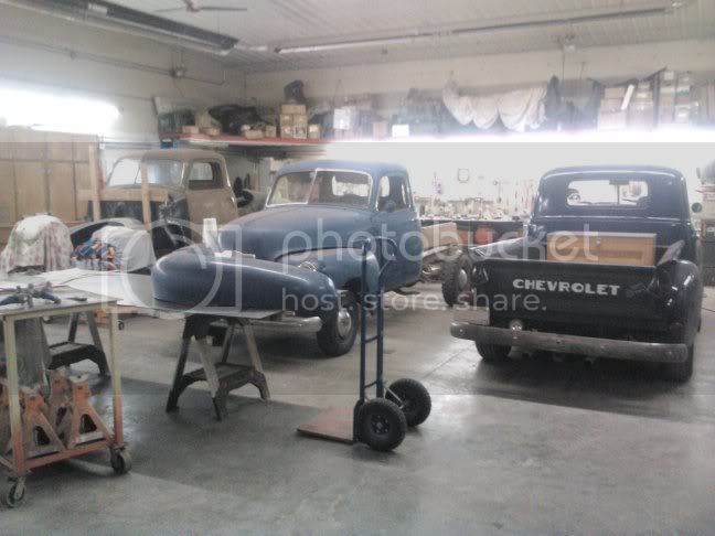

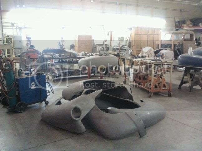

    I got a little bit done the past couple of days. I was able to use a friend's press (thanks, Jim) to remove the kingpins from the front axle. One had some play, so they both came out. Neither put up too much of a fight, and all of the wear appeared to be in the bushings once we got those pressed out and inspected them. I also used his parts washer and bead blaster (thanks again, Jim) to clean up the spindles to prepare them for paint. Hoping to do that sometime this week, as well as get the front axle painted.
    Also on the docket for this week: begin the tear down process for the cab and front clip I'm going to use for my project truck. I'm gonna go buy some more cheap plastic totes to use for parts storage, and take a box of Ziploc bags so I can keep like hardware and parts together.
    When I arrived at the shop yesterday, Jim was working on some AD truck fenders for him and a buddy of his. He also banged on one of my rear fenders with a hammer and dolly... and had it looking pretty darn good. Here's a picture of the pile o' fenders:
    Here's a cool shot of Jim's shop. I'm very fortunate to be occupying a place in his shop, and to be benefiting from his advice and experience. From left to right are: Jim's 1947 Second Series rod project, my '50 "cab and front clip donor", and Jim's 1951 daily driver.
    These pictures were taken with my cell phone, I didn't have my good camera with me. Hope to have more updates and pictures to post later in the week.
    Damon
  20. Wolf
    Wolf Member
    Apr 20, 2008
    888
    Kansas
    You are really doing a lot of work. this is fantastic!!! And that shop by the way is amazing. Man is that an awesome setup!!!
