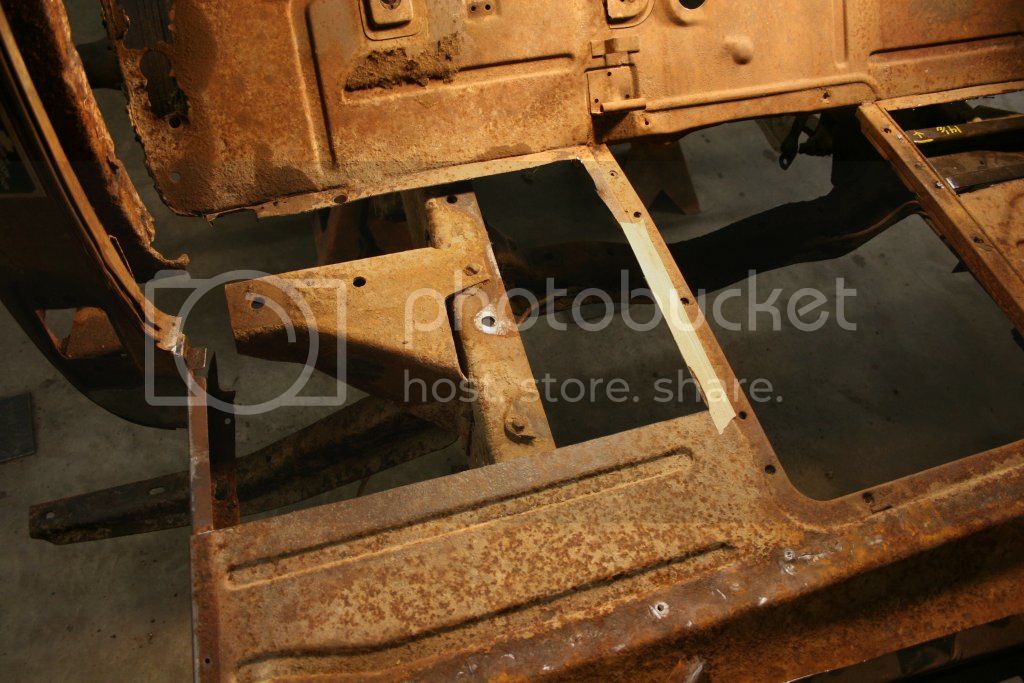

  10. SinclairChevy
    SinclairChevy Member
    Dec 18, 2011
    590
    Keokuk, Iowa
    Greetings folks,
    For those that are interested in the project, I apologize for the delay in getting another update to you. It's been a busy past couple of weeks here, and I haven't been able to put the time in on the truck that I'd like. Add that to having to sit on my hands til parts came in the mail, and...

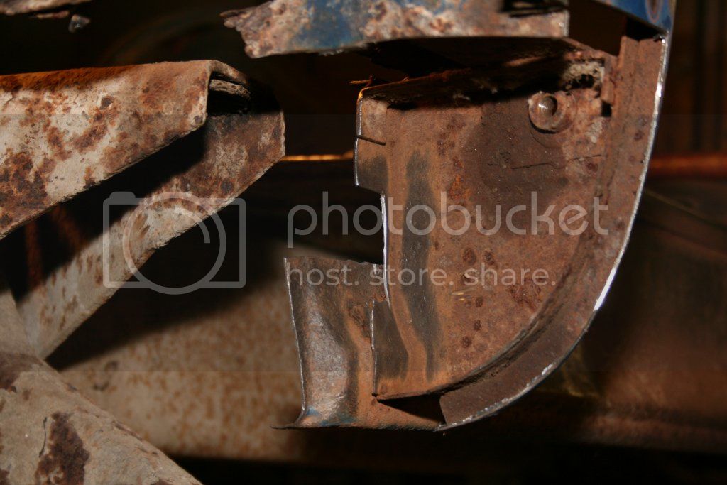

    Anyway, I have a few photos to share with you. The first one shows the removal of the driver's side floor pan and cab floor brace.
    Like the passenger side, we also had to remove the front of the rocker panel and make a repair patch for it. The second photo shows the rocker end removed, as well as another small piece of sheet metal (rectangular shape) near the lower door hinge pocket.
    The third photo shows the badly damaged rocker panel end. Next to that is the patch panel Jim and I made. Above those two panels is the new rocker panel for the passenger side of Jim's 1947 project truck. I gotta thank him again for taking time away from his own project to help me out with mine.

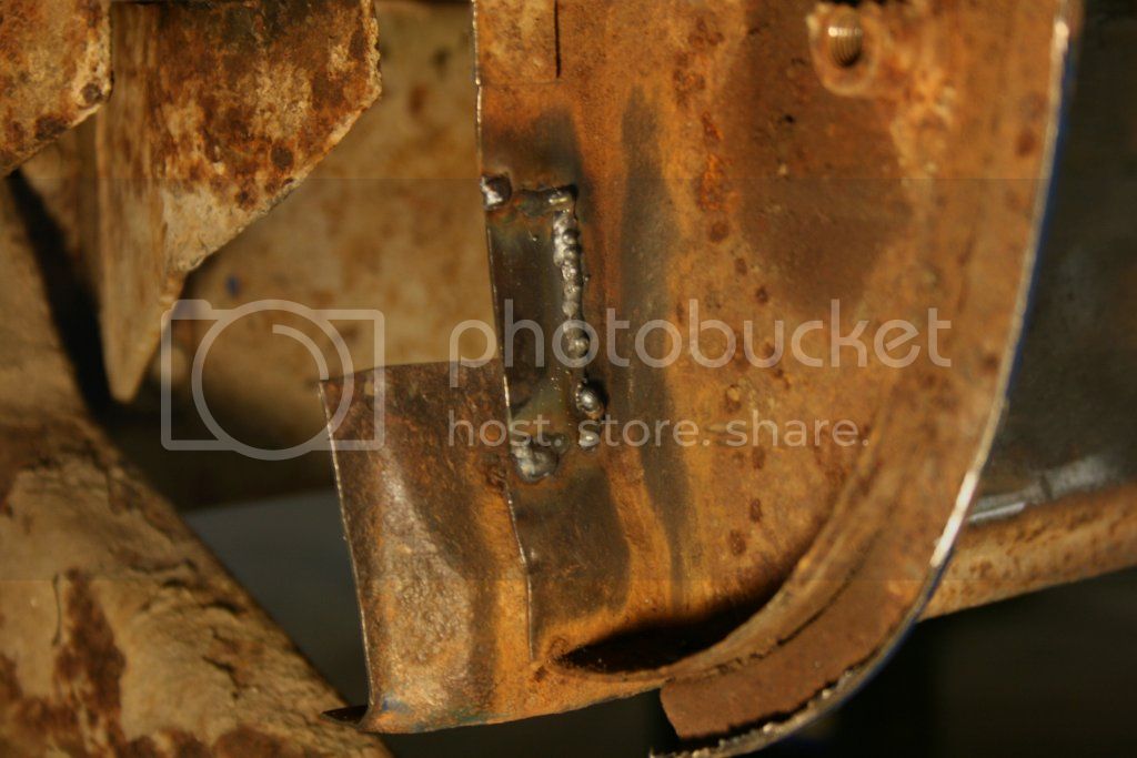

    This photo shows the little rectangle patch welded into place. Not the best welding job, but I'm new to welding sheet metal. That's my story and I'm sticking to it. :D I had to go back and weld shut the holes I blew through the thinner original cab sheet metal.
    I neglected to take photos of the finished rocker panel patch in place, sorry about that. Nor did I take photos of the new driver's side cab floor brace in place. Dangit. I will do that when I get back to work on the cab, hopefully this week.
    Damon

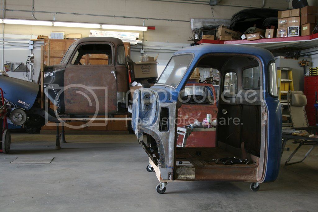

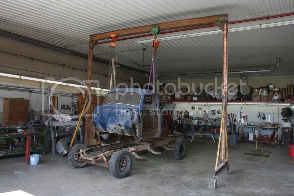

    Here are a couple more photos. The first is the cab up off of the 3/4 ton frame. The frame is now out of the shop and out of the way for Jim to work on farm machinery and implements. That hoist is HANDY!!
    The last photo shows the cab on the dolly Jim built for his project trucks. If you look closely, you can see the rocker panel patch welded into place. Also visible on the cab floor are the rebuilt and repainted rear cab mounts. You can also see that the seat riser has been removed. That was a pain. I made neater work of it with a hammer and chisel, but it was a bit slow. I fired up the air chisel and was able to get the passenger side done faster, but I'm gonna have some patching to do where the air chisel got a little carried away... Jim's 1947 project truck is behind my cab.

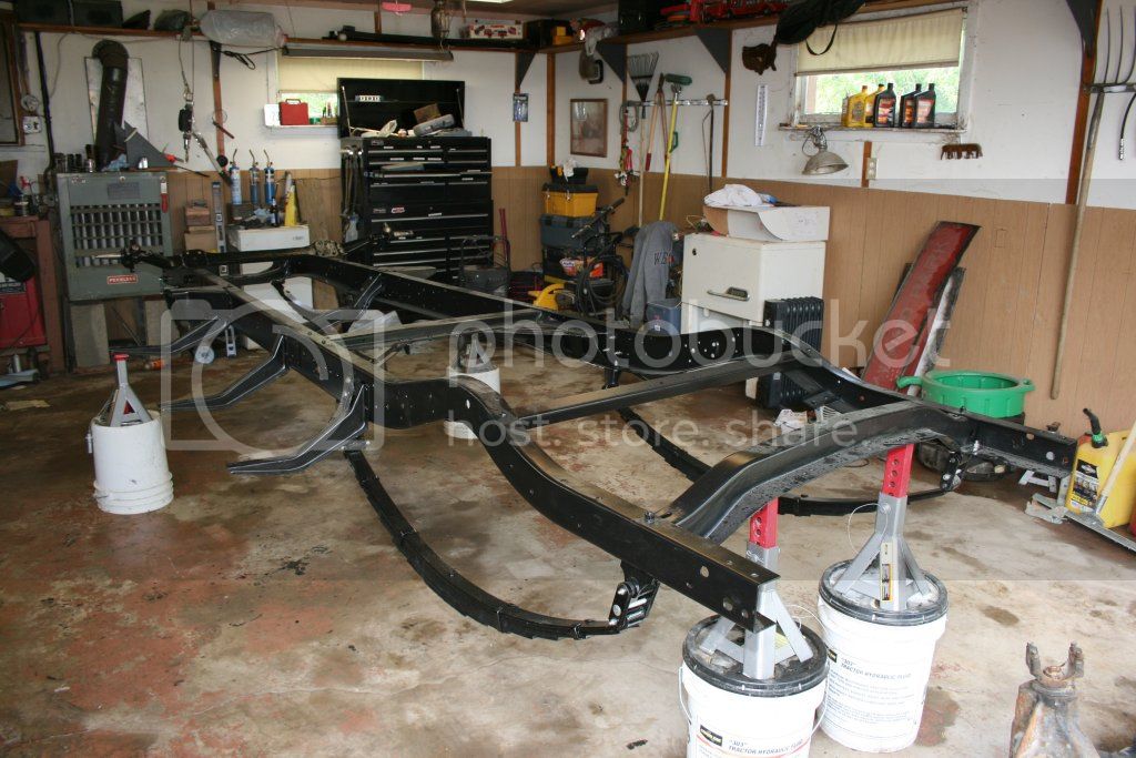

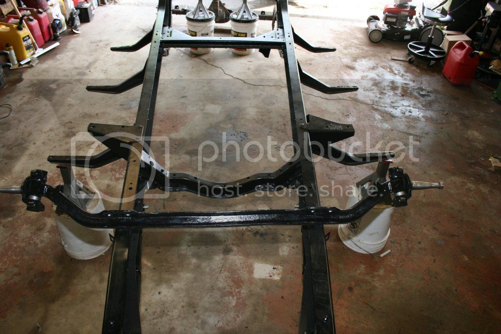

    Wow, it's hard to believe it's been over a month since I've updated this thread. I promise I haven't been sitting on my hands! I have been busy with other things, but there has been some progress made on the truck.
    All of the leaf springs are rebuilt, painted, and assembled to the frame.
    The front axle and spindles have been painted, and new king pins installed.
    Before I bolt up the front axle to the leaf springs, I have a question: How is the rubber bump stop attached to the cast retainer? I cleaned out some gunk on the back side of the rubber, and there appears to be machined threads in there. I'd like to remove/replace the rubber bumper on each side, as well as clean and paint the cast retainer... before finishing the assembly of the front end. I've also been told that installing a second set of 3* shims between the front axle and leaf springs helps give the truck better geometry for holding the road. So I'm taking the shims off of the three-quarter ton frame and I'll be installing those along with the original shims from the half-ton.
    After all that's done, I can install the front disc brake kit and the front end will be finished. I still need to clean up and modify the rear axle for installation, but that won't take a lot of work, as I'm only going to mock it up so I can move it around the garage. Final welding/assembly/painting will take place later after the drive line is installed.
