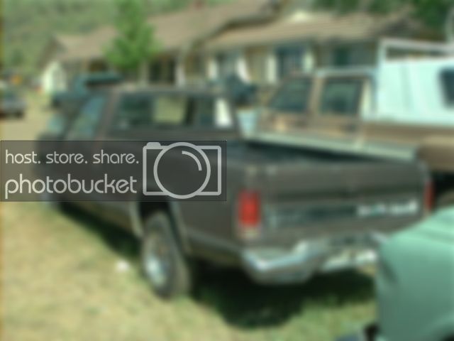

  19. Kevin's 48
    Kevin's 48 Member
    Aug 7, 2006
    740
    Tn
    I'm new to this forum. I'm starting the s-10 swap. I bought an 89 s-10 short bed regular cab. The wheel base was 6 inches to short but I plan on cutting the front leaf hanger in the rear and moving it back 6 inches. I'm using the air ride technologies air bar 4 link set up for an s-10 in the back. this will eliminate my rear leafs and put the rear axle back to the correct wheel base. I'm using the rear end out of a newer model s-10 blazer so I will have a rear disk brake set up. I'm using shock wave front bags and tubular A arms from air ride technologies as well. I plan on putting 20 x 8.5 inch wheels in the front and 22 x 10 inch rims in the back. Thats why I went witht he s-10 frame because it was only 53 inches wide and would give me the much needed fender space for such big rims. Is there anything else I might need to consider before getting to far into this project or does it sound like I'm on the right track?
