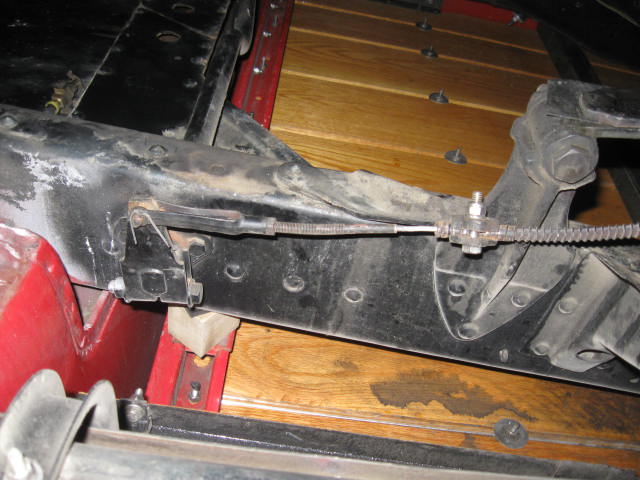

    Here are a few pictures of some of the parts. Hope this will help. This is a 53

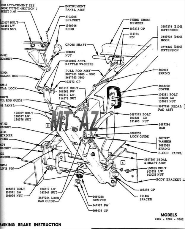

    Here is a diagram of everything from the pedal to the middle of the frame.
    Send me a PM... I can fix you up with everything you need.
