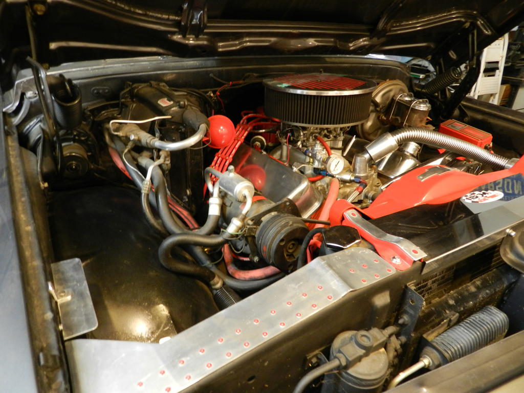

    I moved to Oregon from Calif. I just never use the air con. so I am hauling around all that weight and turning the compressor for no reason. This will clean up the bb engine bay and I will install the ac delete panel and still have heat. I just want to know if anyone has done this and if there is any hidden problems.

    There's the issue of unwanted underhood air coming through the firewalls holes and the un used AC vents .
    AC takes NO POWER whatso ever unless you turn it on and removing it reduces the value of the rig .

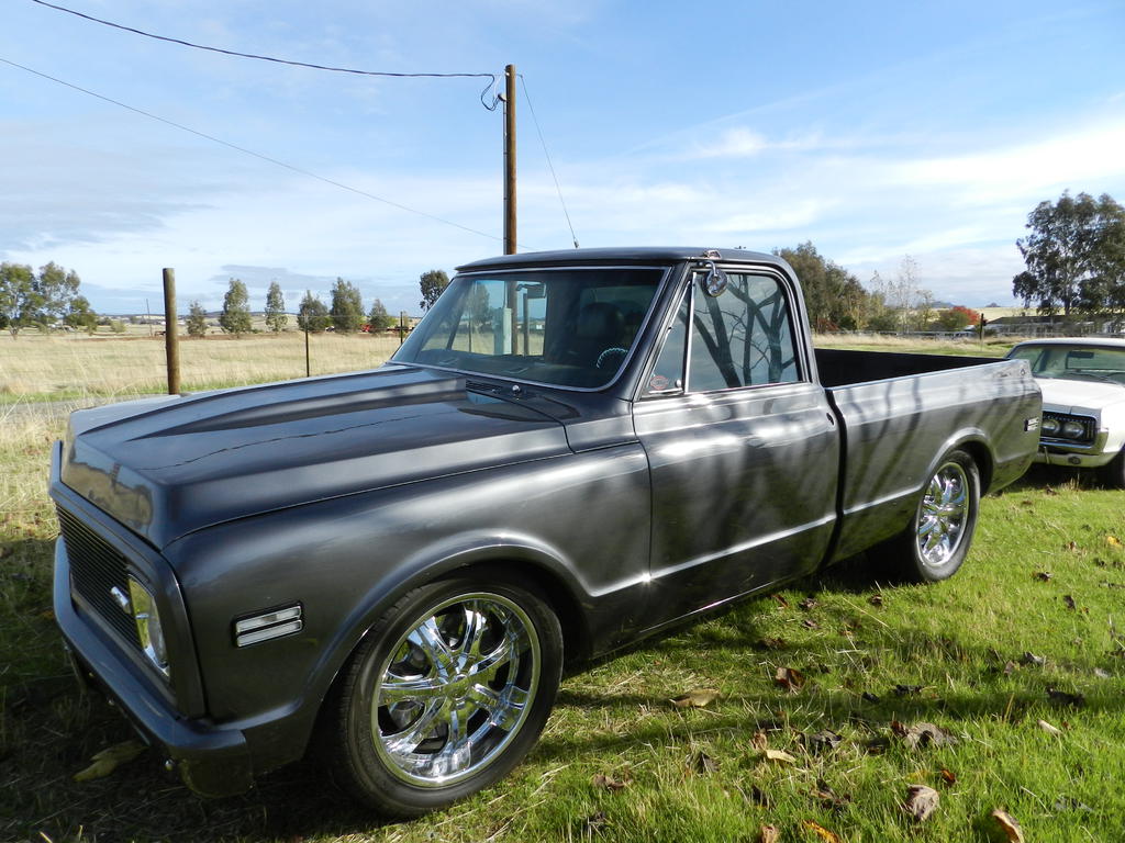

    Does air penetrate even with the ac delete panel? I don't plan on ever selling the truck and it is very far from a stock c-10 , so not too worried about value. 71 chevy bb + interior 002.jpg

    It shouldn't .
    The is no factory AC Delete panel , they used different cabs but as long as the firewall holes are well covered you should be good to go .
    I'm replacing my rusted away cab and got an AC cab to replace so I'm happy to be adding AC here in Sunny So. Cal. .
    Nice looking rig you have there .
