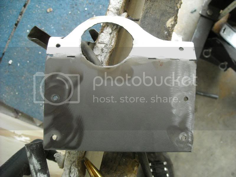

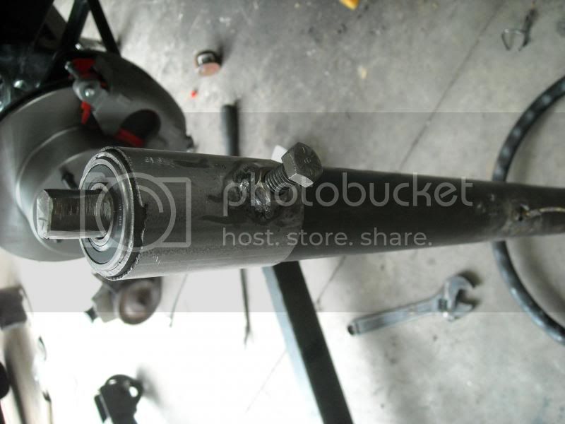

    Take a piece of 1 7/8" exhaust tubing, cut off about 3", drill a hole and weld on a nut for a set bolt...
    Drill holes for mounting screws..

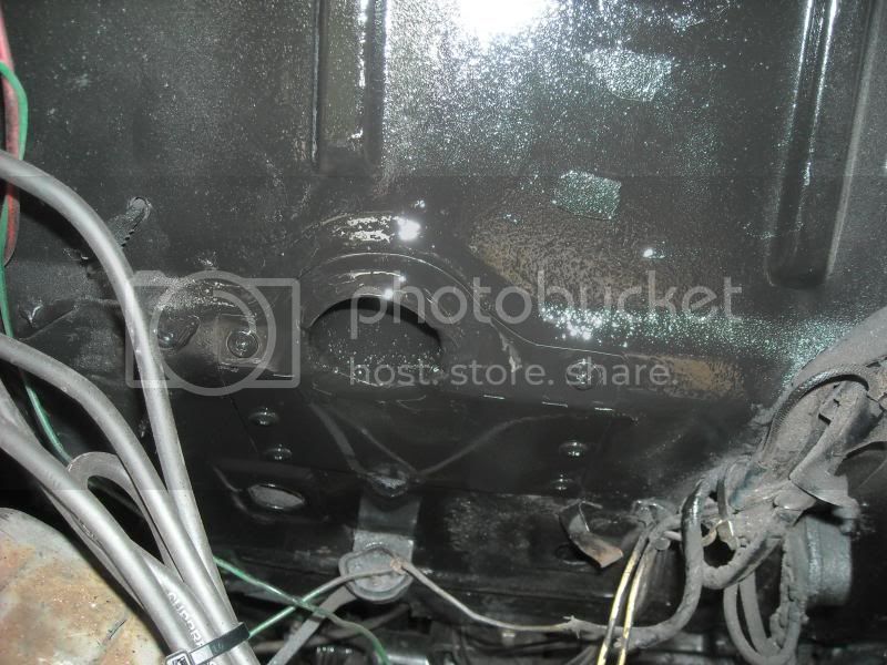

    Mount plate to firewall. Mount steering column to dash, let tubing protrude through the plate, then weld to firewall plate. Now grind smooth and paint...

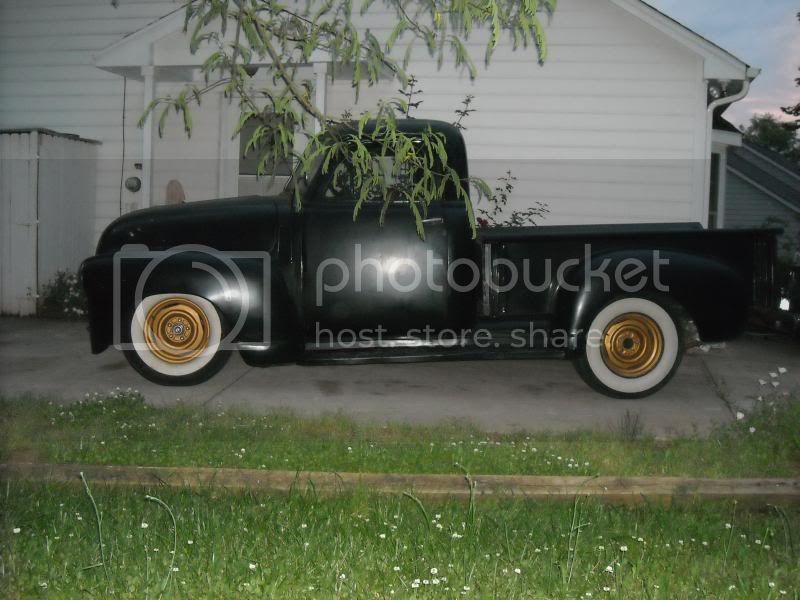

    Here is a side view of the truck together....
