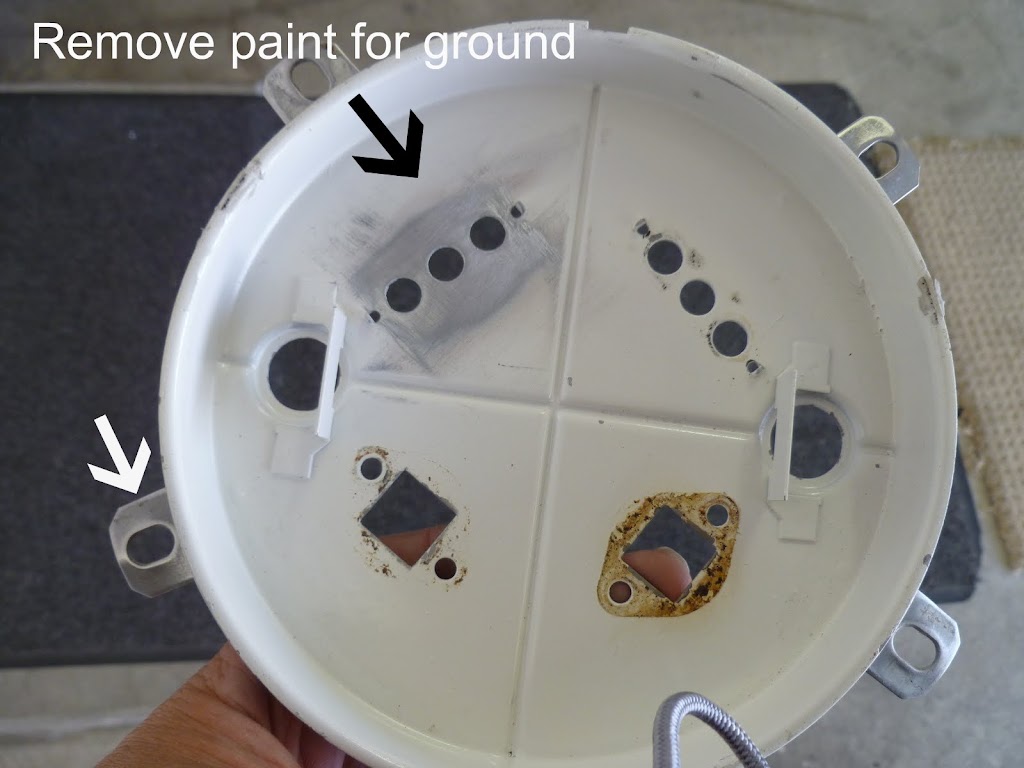

    The sender will go to the F post
    Power to the E post
    If your 12 volts and using a 6 volt gauge then use the reducer on the power side.
    Originally there was a red waring tag attached to the sender post of the gauge
    If you refurbished your housing and painted the inside white, make sure you clean the paint off where the gauge touches the inside. That is a ground path

    Thanks again, Tubby! GREAT photos clear everything up!
    I just need to be patient and wait for my Runtz to come in. (Well, first I have to get it ordered...)

    Zig: Another picture of the back side of the instrument cluster. The sending unit wire goes to the red tag.
  17. Zig
    Ummm~ Interesting picture there, Bill. HA!!!
    (What I see is a red circle with a line through it.)
    Tubby's picture has a red tag that says "This side to sending unit". Is that what you are speaking of?
