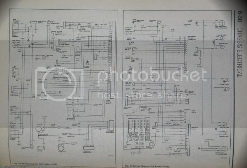

    I'm having the same problem as the OP with the addition of the fuel pump running continuously with ignition off. Right now I just pull the fuse to turn them off. This is my Grandpa's old truck that was given to my sister. While she had it I was told the wiring harness to the fuel tank was replaced. I assume this was done wrong and that's why the fuel pumps run continuously. I have the wiring diagram and plan on working on this tomorrow. As for the left tank not working, when the fuel tank selector switch is on the left tank you can hear the fuel pump running and the gauge works, but the engine dies immediately. Is it possible to test the selector valve for proper functionality or is it just best to swap out?
